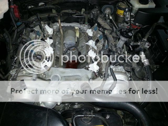

No, not a motorcycle accident, but I'm helping a friend with charging system troubles. He is unemployed (as are more and more here in Alberta with the price of oil as it is), and had his '07 4.7L Tundra break down. He got it towed to his home, and was quoted $700-800 to replace the alternator, if that turned out to be the problem. I got the call for help, and now have his battery and alternator at my place, but what a pain! On my old truck, the alternator is right in front, at the top, so would take about 10 relaxed minutes to get it out. To get the Tundra's out I had to alternate between leaning over the radiator and lying under the engine. The power steering pump had to be moved, and I had to remove the fan and shroud (which meant disconnecting the upper rad hose) to pull the alternator up and out. All this outside in fading light at 0°C temperatures. I'm hoping that it'll be something as simple as worn brushes so I'll be able to get him running for the price of a rebuild kit.

Gryphon Rider, you might appreciate what I went through last week. I had a bad starter and found it underneath the intake manifold. On Toyota V8 engines it's still a two bolt replacement part but you have to remove 35 bolts, connectors and a 50# intake manifold to get to them.

Just in case,,,, the area under the intake manifold on a V engine is called the valley.  The pic of the Toyota shows the starter in the back of the valley. And its still a stupid place to hang a starter, the designer that had this brilliant friggin idea should be forced to change at least one.
