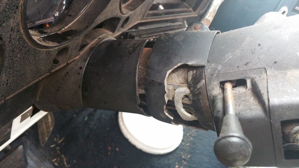

This morning I went out to my truck, and the key for my "The Club" wouldn't turn the lock.  Neither would my wife's key.  I tried lock spray.  I tried a metal-cutting blade in my sawzall, and it barely scratched the shaft and the hook.  I then gave up and begged a ride to work from my wife.
When I get home, I'll try a heat gun on the lock (it's -22°C here), then maybe an angle grinder with a cutting disc.  If it comes down to it, I'll cut through the steering wheel and take a trip to the wrecker for a steering wheel when it warms up later this week  Undecided.
This has been a winter for cold-weather car repairs.  At least my house furnace, HWT, and appliances have been behaving this winter.

tow to a heated garage and then wait for it to warm up?

No doubt whatever the angle grinder with abrasive cutter wheel would work.  I haven't seen anything that tool wouldn't cut - goes through hardened tool steel like butter. Shame to ruin the Club though.  I'm surprised you even need it in your location. I suspect the heat gun will work before you need to cut it.  My soln is to drive a 19yr old Exploder no one would steal. Which has electronic lock/alarm system anyway. Besides crime out here on the ranch doesn't happen.

You should heat up the cab, as others have said.
The Club will not deter any self respecting car thief. Last time I saw one was in the movie "Swingers " 1998.
A hacksaw will go through a steering wheel in seconds, replacement wheels are easy to come by.
Why not take the entire wheel off the steering column and work on it in a heated environment?

call the mfg. of the club and ask them why it is not working?  They may say cut it somehow and they will send you out a new one for free?
if due to cold, usually lock de icer spray works for frozen door locks pretty quickly is isopropyl alcohol if not mistaken in a spray bottle that goes into the keyhole area.
try lub oil spray can as well if that lock de icer does not work first.
Unless in crime ridden area, really see no need to use one though if a criminal wants a vehicle bad enough, they will get it regardless of safety measures taken.
keep jiggling the key it might unlock eventually, good luck!! but guessing something internal is broken having to saw off the club

a can of air duster upside down sprayed into the lock. Hit with hammer.  Or a hammer and chisel.

Jaws of life ain't a bad thought.  I worked on a lot of locks but im not a locksmith . Try the propane, or map tourch or hair drier or heat gun to get it open and dry it out in the house then add the best gun oil you can get your hands on I hate lock deicer it makes a mess and its junk. If you don't get all the moisture out of the lock it will freeze back up.Best gun oil And great on locks was a K&W product called DOM but due to the chemicals in it it is no more. If you use that angle grinder watch them sparks besides starting a fire if the sparks hit the glass you'll pit it garenteed for sure.

About a minute with the heat gun on the low setting got it unlocked. Yay!

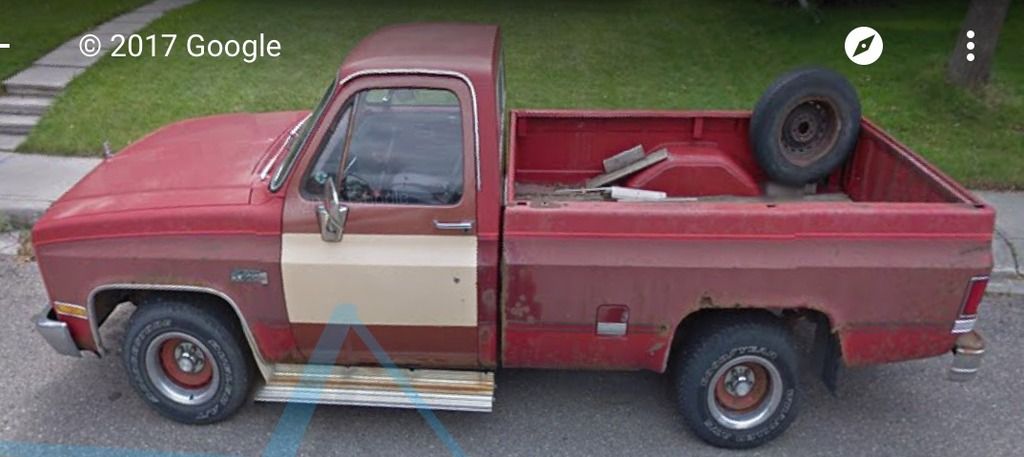

Just to give you guys an idea of the value of my truck, here's a Google Streets pic of it a few years ago. It has since increased in value with added patina.
If you look closely, you can see the ClubTM in question.
« Reply #19 on: January 09, 2017, 05:50:52 PM »
I don't think it looks too bad at all. Most of that year and make I've seen have rotted side panels pretty bad. Yours seems to be holding up pretty well.  cooldude
