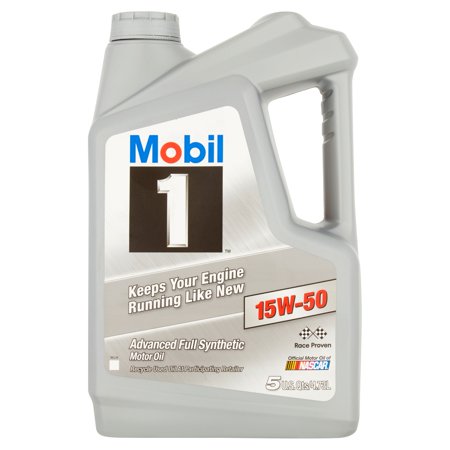

Don't want to start a oil war, just want to know from those of you that use Mobile one, do you the 1qt motorcycle oil or the 5qt car oil?

15W50 Car oil.

One still has to be careful, some Mobil 1 has the friction modifiers/energy saving doesn't it?
« Reply #9 on: February 15, 2017, 03:46:59 PM »
I wasn't aware of it. I've been buying the same stuff for a while. I'll have to start paying more attention.
Correct. You should see an icon like this on the label. Look for the bottom rocker, and if it says "Energy Conserving" do NOT put it in a vehicle with a wet-clutch (Like our Valks)

Do you know if any of the Mobil 1 has it ? I don't remember ever seeing it, but I don't look at all the variations.
Yes, some flavors or Mobil 1 do have friction modifiers; however I don't recall which ones, so just look for that rocker.

JASO-MA rating is wet clutch compatable in any oil. To each his own. I use Rotella T in everything.

If you want to check the status of your wet clutch and confirm the oil you are using is compatible with the clutch disks, try this:  on a road where you can run 4000 rpm in 4th gear, pin the throttle wide open and hold it there.....at the same time VERY quickly blip the clutch lever  (in and out).....the engine rpm will quickly jump to 6000 or so, but as the clutch re-engages it will pull the engine rpm back down in about 1-1 1/2 seconds to 4200-4400 or so.  If the rpm stays up at 6000 or so, the clutch is weak and slipping OR you are using the wrong oil and its causing the clutch to slip.....changing to a non-energy conserving oil will likely fix the slippage in a few thousand miles.......
And relax,,, this is not any worse than power shifting through the gears...... crazy2 crazy2

In my case. first, second and third gear would solidly hook up.....4th gear at 4000 (max torque) would start to slip.  fifth gear did not slip....its a function of gear ratio and torque that puts the greatest chance of slippage in 4th at 4000.....
BTH, it was M1  15-50 I had used for 80K miles..... just saying
Went to Rotella 15-40, been fine for 150K miles

Was this the Mobil One Motorcycle oil that it slipped with?
Exactly my experience but with the Mobil One so I stayed with the Mobil 1 motorcycle 20w50 oil and purolator filters and never had a problem.

I use Mobil 1 in everything: cars, trucks (diesel),motorcycles, lawn mowers.
15w50 or 15w40 (non energy conserving) in everything except some cars.
10w40 (energy conserving) in the other cars.
Never had any problems.

Picked up a box of this at Costco for the price - was $6/qt IIRC. It's the only weight they sell - but it should be OK for our Valkyries. Note they have changed the label, calling it "resource conserving" now.  It doesn't say "Extended Performance" on the label but it implies it with the chart and check mark and red-outlined paragraph below.  So does this have friction modifiers?  don't know.  The QR code doesn't map to a web page on my phone.
Pete
Posts: 2673
« Reply #24 on: February 16, 2017, 09:13:10 AM »
Best guess it is the same as energy conserving.
I think the only way to tell for sure is to look at the chemistry for moly in a quantity of more that 150 ppm.
Usually energy conserving shows up with 600 to 700 ppm.
The Mobil site is currently having issues and not showing the data.
