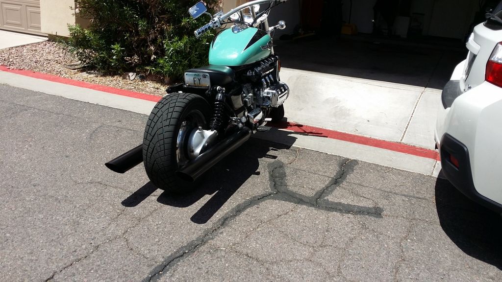

Looks good...kind of a "clean" version of mine...double darkside as well. I did 2 pairs of Kuryakyn Run, Turn, Brake lights. 170/60-17 Battlax up front R1R Proxes out back

Hook you can buy a used front half of oem fender and cut it to whatever shape you please. Bonus is it will mount right to original points on support brackets. See mine here. This was before I took a grease pencil and rounded it off.

Also covers that side area in front of shock.
