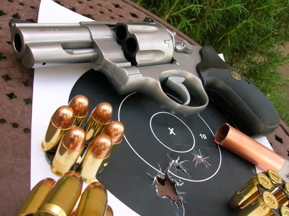

Yes I use them with a number of revolvers, including several .45ACP revolvers (old and new) that they were originally designed for (though originally, they were half moon clips).
With rimless cartridges, it is they only reliable way to eject empties (other than poking them out one by one).  I have a 7shot .357 (rimmed) that will work without them, but loaded moon clips are the fastest reload known to man, and better than speed loaders.  You just have to have a number of them preloaded for business.
They can be a bit of a PITA to get the empty brass out of.  They sell tools for it, I just use a cleaning rod.

The moon clips are spring steel, and (for such a small part) relatively expensive.
You may throw away your brass (I mostly don't), but not your moon clips.  Though some years ago a guy at a gun show gave me like 35 of them for 6 shot .45acp revolvers.  The ones for my .357 7 shooter are definitely not cheap (and twice as hard to load and unload).

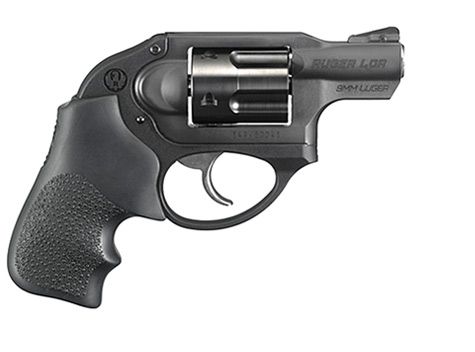

Think of it as a mag for a revolver. Some revolvers can use moon clips, some can not with out  the cylinder being modified. I have a Ruger LCR9 that uses moon clips. They're easily removed with out the need for a tool. Note: do not set a black moon clip on a shooting bench that had Bedliner on it. Took 10 minutes to figure out ware it went.

They work great!! Drop the whole thing in and start shooting, when done its a Pain to get the empty. I just bought a pile for a S&W 45acp. Best price ive seen is on Ebay
We really liked the trigger on that and the factory moon clips cooldude
Had any trouble with "bullet jump" in that snubbie 9?
It's the only reason we didn't buy one.

This shows it pretty well on that LCR9, there's even a video...
http://mousegunaddict.blogspot.com/2014/11/ruger-lcr-9mm-review-pocket-9mm-for.html
