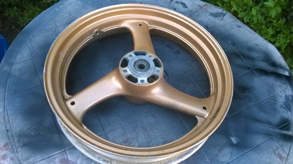

I've always wanted to have a go at some custom paint work so recently bought an old GSXR 400 Suzuki to play with. No way I'm painting my Valk.
This is my first attempt at it, I started of with the wheels.
The original wheel.

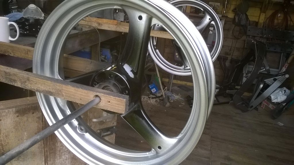

After rubbing it down, priming and spraying it black, I faded some silver on the rim.

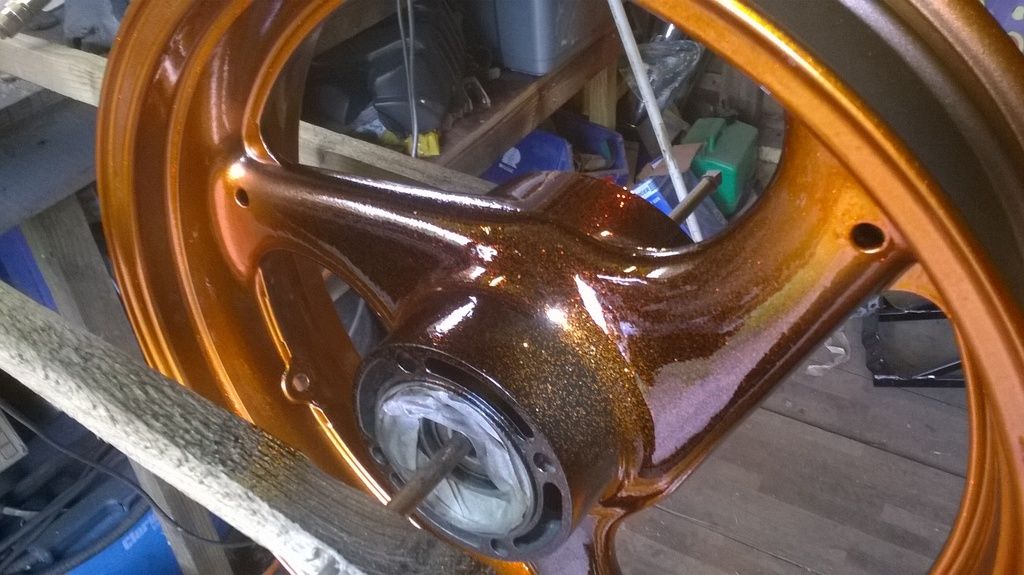

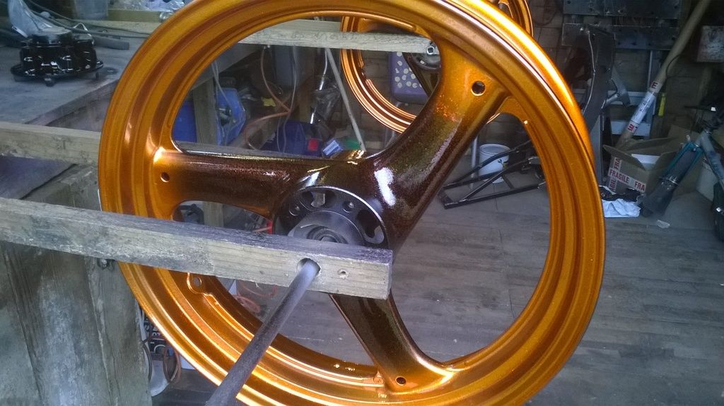

Next was a layer of clear coat with some "cosmic" orange flake, followed by some more clear with candy burnt orange.
I've got a couple more coats of plain clear coat to put on yet.
I'm quite happy with the end result, not perfect by any means, but they still look pretty cool. Cool

« Reply #1 on: May 08, 2017, 02:26:52 AM »
Looks good, but is the inside of the wheel suppose to be painted? I would think you would have issues with the bead if you painted the bead side. I don't know, just asking
Posts: 8743
« Reply #2 on: May 08, 2017, 04:06:58 AM »
No issue painting the bead as long as the paint adheres well.  Car wheels have been painted four years.  MHO.

« Reply #3 on: May 08, 2017, 04:24:04 AM »
All wheels are painted inside.
A lot of the problems with alloy wheels losing air is because the alloy starts to corrode under the paint.

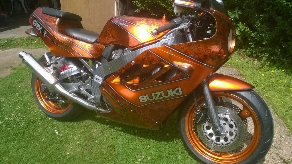

All the paintings done, hydrographics done, just a couple of small jobs left.

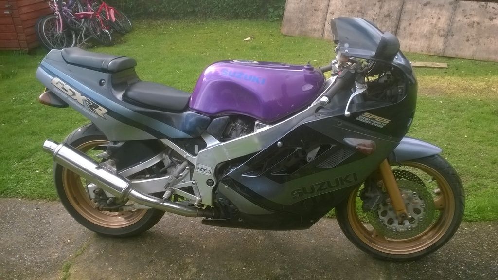

Here's what I started with.
And here's the end result
