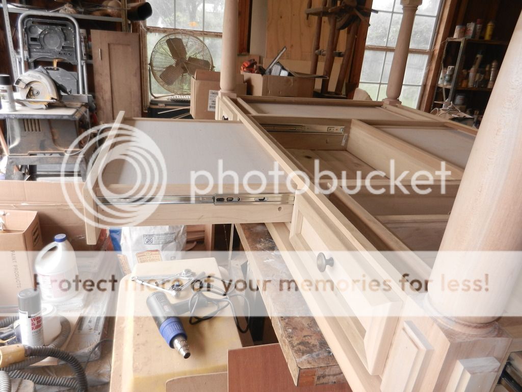

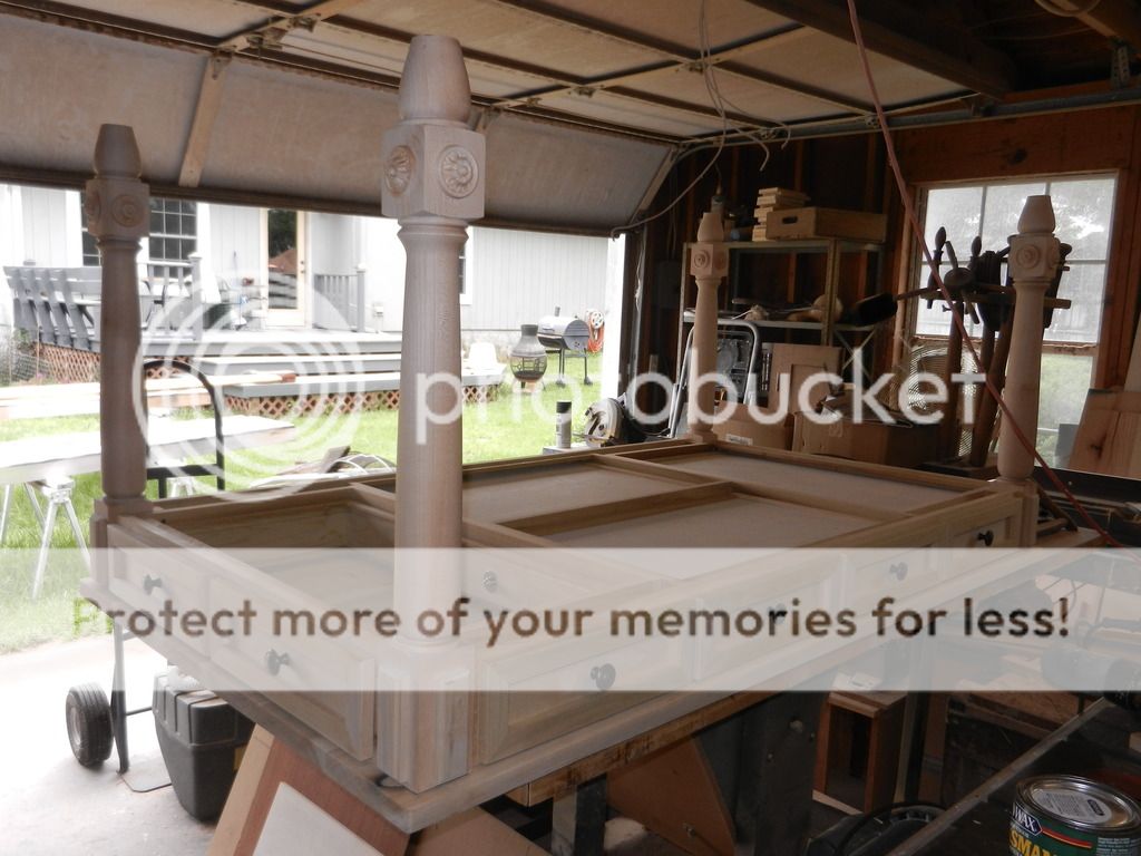

OK, you guys asked.  If I wait till its done you wont be able to see inside how it works.  The table was built upside down (and still is) and there is no bottom on it yet, so you can see how it works.
First, this is the sideboard my customer just bought and they want the table to match
Heres the nekkid table upside-down

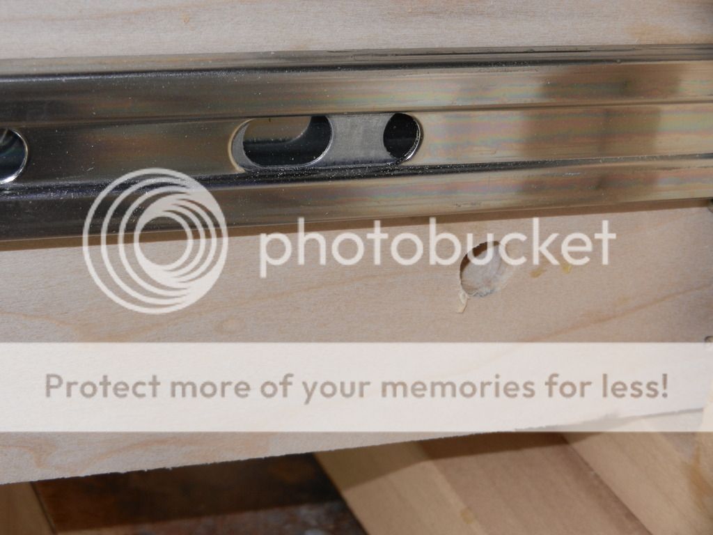

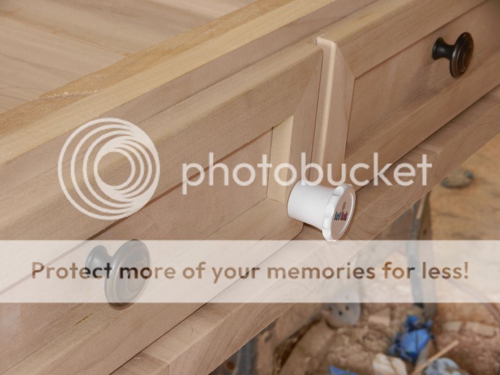

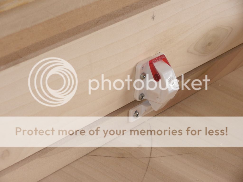

The drawer with its bottom removed (so we can see) is the "key" it allows the two side drawers to open.  You first have to use a magnet (kid safe) thing

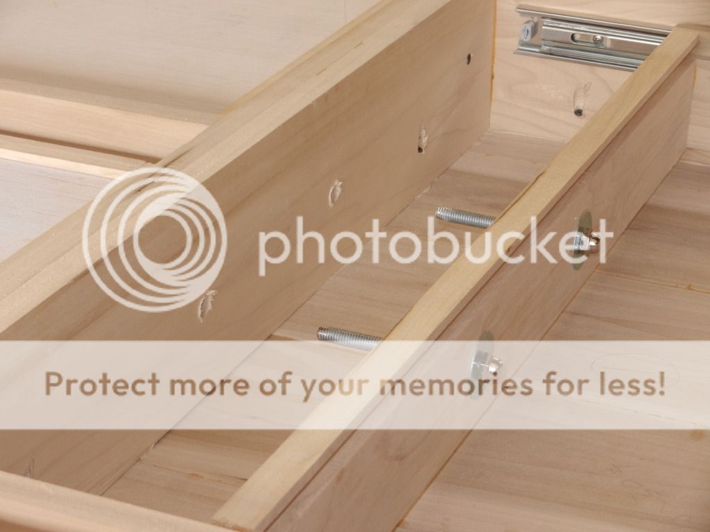

The "key" drawer has two "spikes" of all thread that go through the walls and into the side of the middle drawers
So, all you have to do is close the middle drawers first and then close the key drawer normally and automatically all three just lock and they are tight, no play.  So an unsuspecting person sees twelve drawers and none open except the opposite end from the key drawer until the magnet is put in just the right spot.

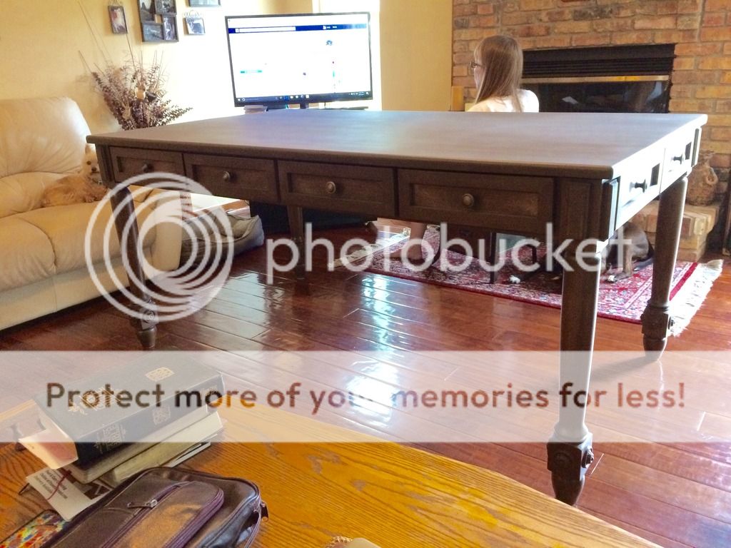

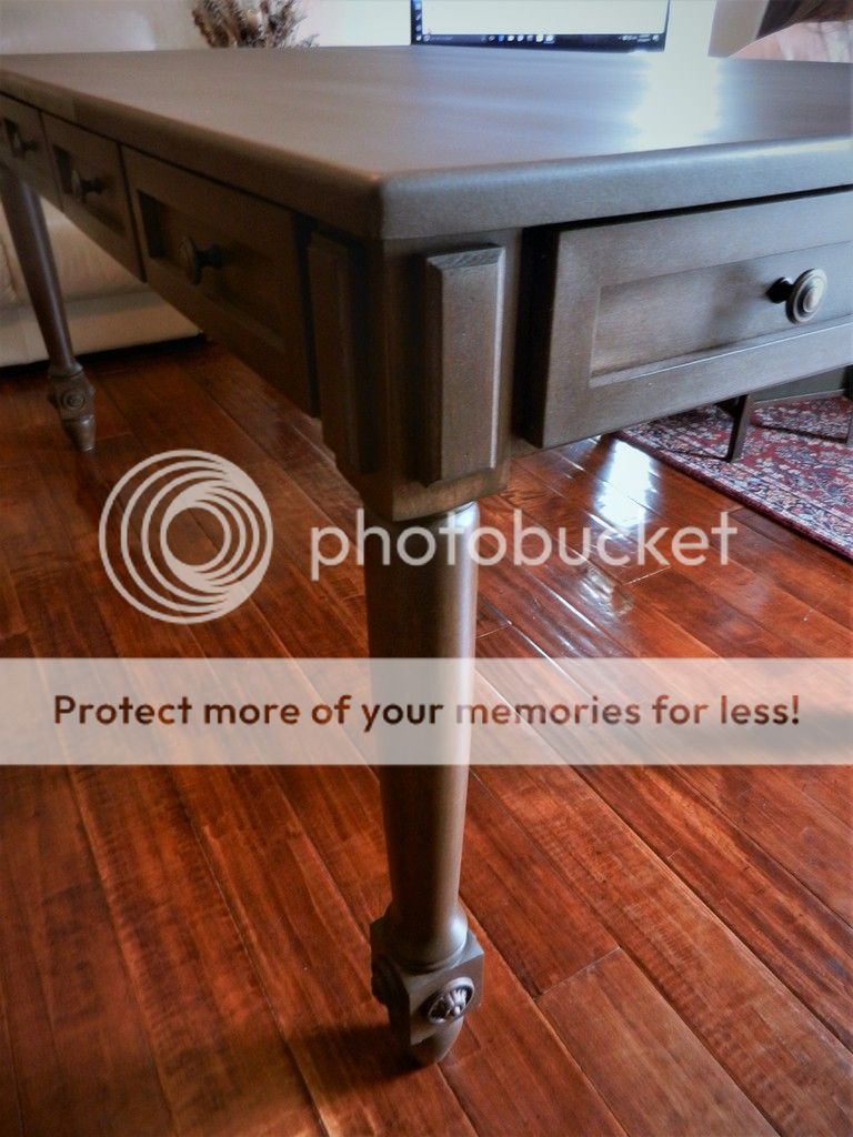

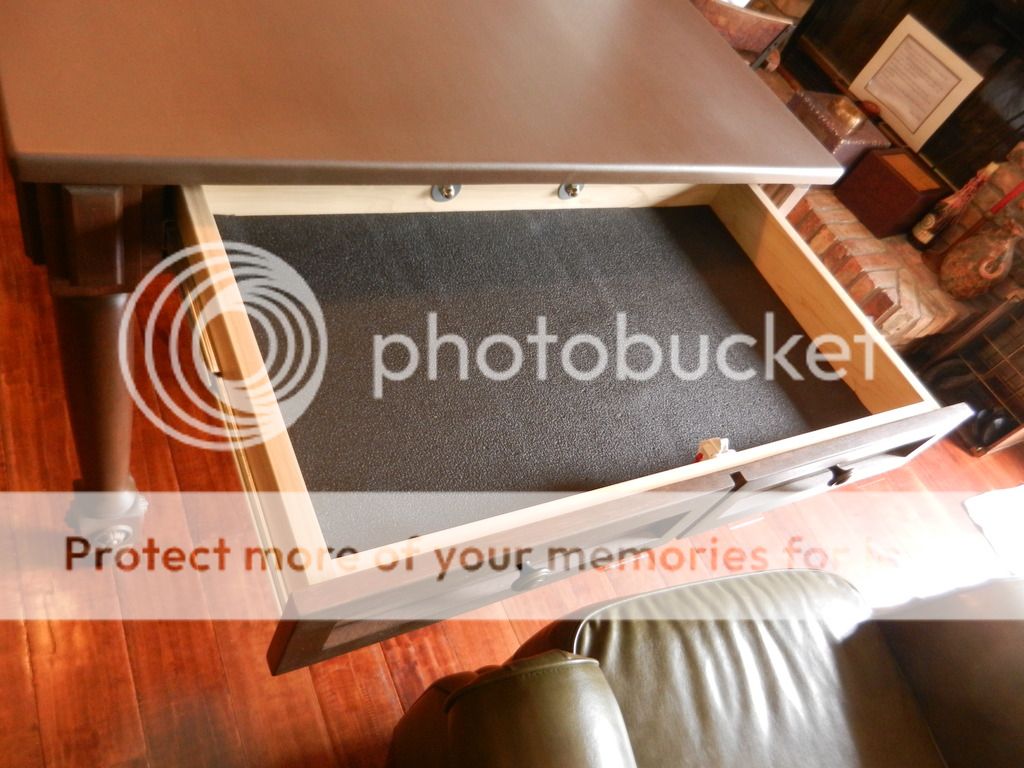

Finally done. I have a couple more pics to post later tonight but this is the final look.
Close up of a leg.

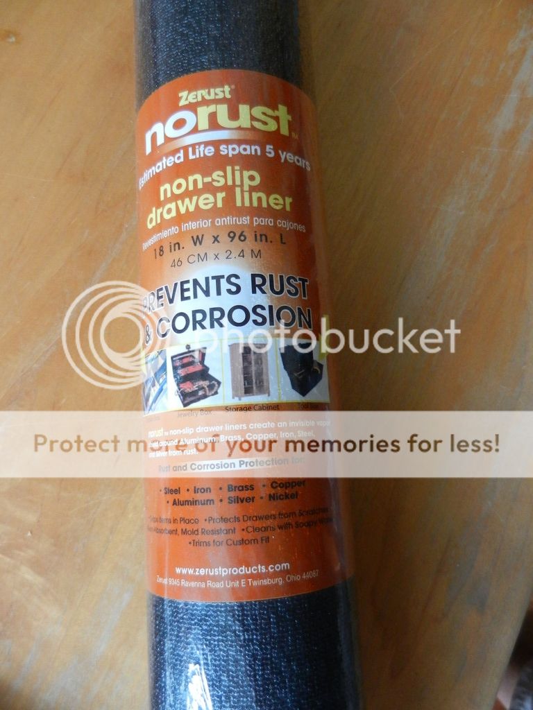

Drawer with anti rust lining

How did you mount the rails to the legs?
Mortise & Tenon?  Or bolts?  Or both?
Three bolts on each leg. Not enough material to even think about mortise and tenon

Where did you find the magnet lock?
Posts: 14885
« Reply #21 on: June 13, 2017, 07:24:37 AM »
Thanks Hook. The magnet lock is just a child safe cabinet device intended for kitchen​ cabinets. I had to modify it slightly to work on the straight linear pull of a drawer. I bought it through Rockler magazine.
