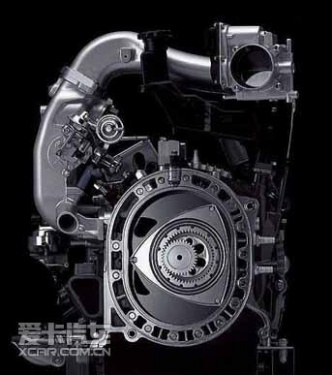

Radial:
Rotary:
Posts: 15324
« Reply #3 on: July 28, 2017, 07:30:53 PM »
Sorry Gryph, but the rotary design I'm talking about preceded the the Wankel by a few decades. Check the link out.
https://en.wikipedia.org/wiki/Rotary_engine

« Reply #4 on: July 28, 2017, 09:35:24 PM »
Okay, well I learned something today.  It looks like it's impossible to stop the bike without stalling it.
