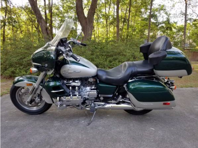

Holy Mackerlandy.......
I finally got an image included in a post. Perhaps now I can include the images to show what I am doing with my beautiful 99 IS, SuzieTwo
Quote from: markymark640 on Sat 19, Aug 2017, 15:39:26
Ok, so that wasn't it.
Nice looking bike  :cooldude: it's good that you are bringing back a Green & Silver. One of our members is very hard on them.  ;)
Quote from: meathead on Sat 19, Aug 2017, 16:08:10
Hey!  Two out of three is not that bad!   >:(
