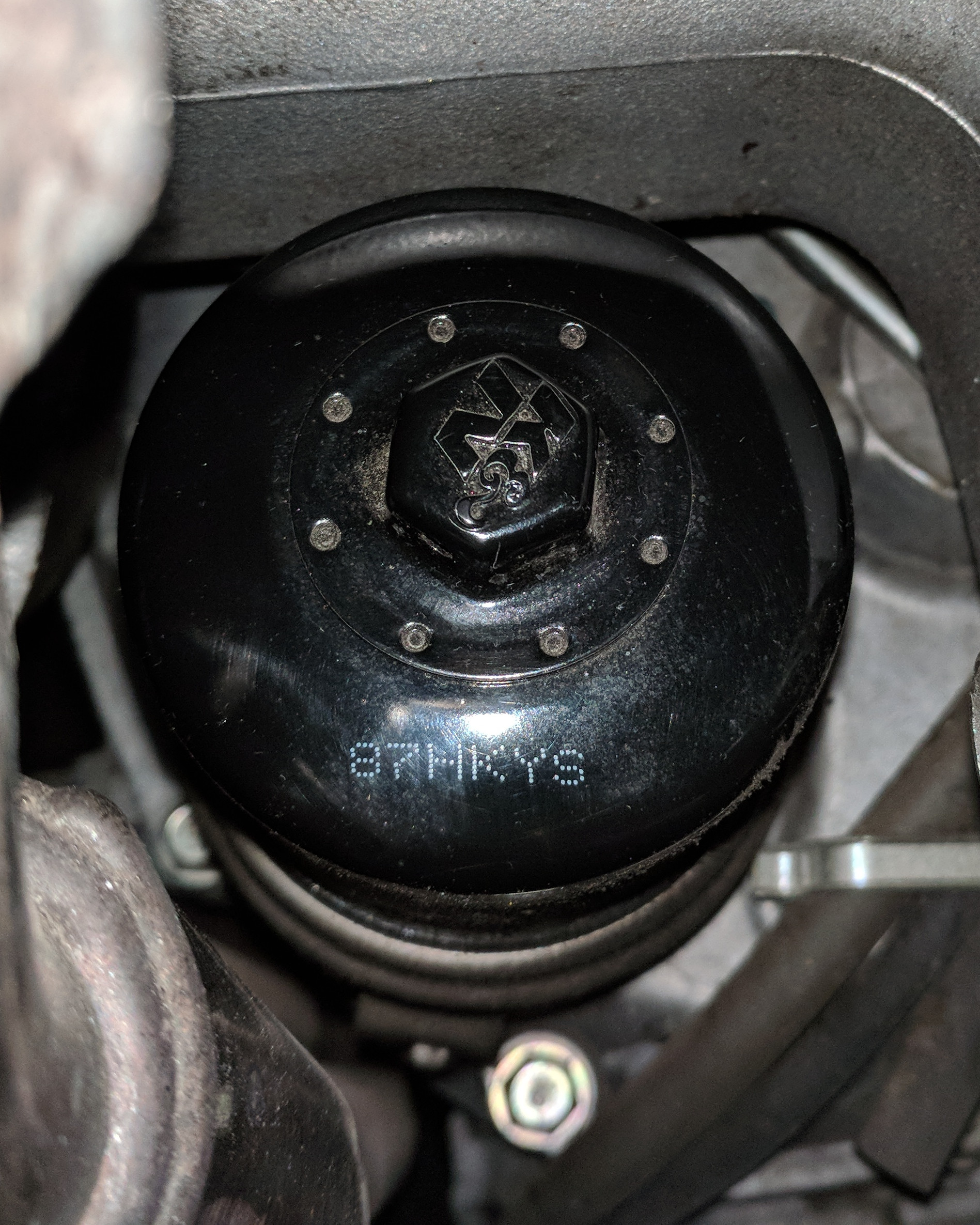

@Robert: totally agree, K&N nevermore.
Turns out I was a 'lucky' one (see that it is a '7H' code, so it is one of the faulty filters).
From the recall page: "The defective oil filters will contain as the second and third characters of the code the number/letter combinations of 3H, 4H, 5H, 6H, 7H, 8H, and 9H with the number corresponding to the month of the year and the letter "H" representing the year 2016."
I had just 3K miles in this Mobil 1 Full synthetic oil (service interval for ST1300 is 8K miles, like the valkyrie).
I guess is cheaper to loose the good oil than to crash the bike.

PBL14610 or PBL14612 same filters just different lengths. I use the PL14610 the longer one and have no problem with it on the 1800.
I had a company once try to sell me oil filters for my Valk and they sent me a gratis oil filter. I looked at it for a long time and didnt want to try it but one time said what the heck. Put it on and seemed fine except one day was looking and there was a spot of oil on the floor, no way not out of my Valk and sure enough the filter was leaking. Checked the oil level which I rarly do since these bikes never burn or leak oil and it was 1 and 1/2 qts low.
Good lesson, not used to checking oil levels dont use filters that can leak.
Threw the filter away and used a Pure One and never had a problem, so yes Savago change the filter.
