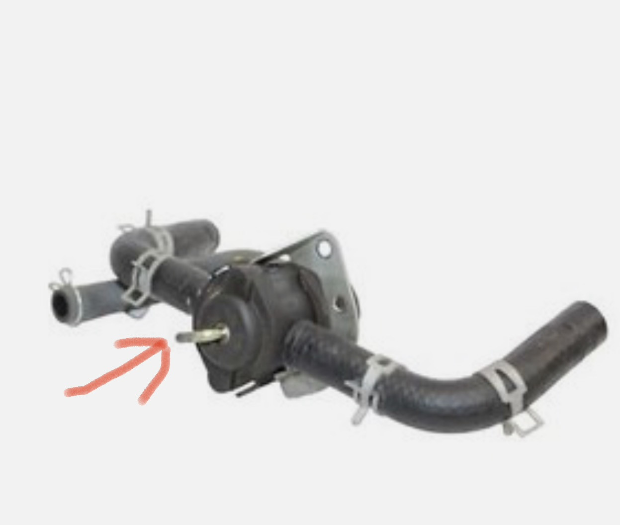

I saw a post on here somewhere about being able to remove the pair valve/put a hose where it was and be able to remove and cap the relative intakes?  Can someone elaborate if so as this step alone would save in fiddling with that whole piece of hardware that includes the T.

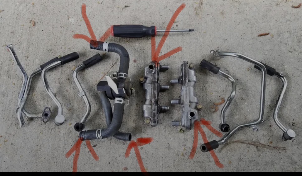

I did a complete desmog without removing the PAIR valve ass'y at that time, removed them the next time I had the tank and airbox off.
I first removed all the rubber tubing, that left the "plugs" on top of the heads at each corner of the engine. I merely pulled those plugs, shortened the metal tube where the hoses had been removed, mixed up some JB Kwik and filled the metal tube...then placed the plugs back in place. On the underneath side of the heads is the place that needs to be capped off. Instead of doing that, I used my air driven hacksaw and cut the metal tubes near the top of the head and again filled with JB Kwik. Lastly, I capped off all the vacuum ports on the back of the intake runners, leaving #6 available for the petcock. About 50k miles later I sold that bike with that same setup still in place. Decided to leave good enough alone and only had the tank/airbox off once in that time which allowed me to remove the PAIR ass'y.
Basically, remove all the tubing and cap off where they were attached to the engine. Block off those spots with JB Kwik. Remove the PAIR ass'y. later.

Referring to the hoses that go to carb intakes 3&4 and the pair valve all connected by a plastic T. And of course the pair valve itself.  I would be happy to just get rid of these alone and be able to cap them off if possible. I wouldn’t have to worry about replacing them which is impossible without taking the tank and air box off.  The line from #6 to petcock doesn’t bother me.

Thanks Joe! Now I’m getting some where.  I just need a little more detail.  So I remove the pair valve…I can cap off intakes 3&4.  What about the reed valve holes where the pair valve is plugged in?  And was one of these connected to the air box?
Joe333x
Posts: 212
Boston
« Reply #11 on: April 13, 2026, 05:40:44 PM »
Same thing just cap them off, I had some rubber caps that fit on the air box.

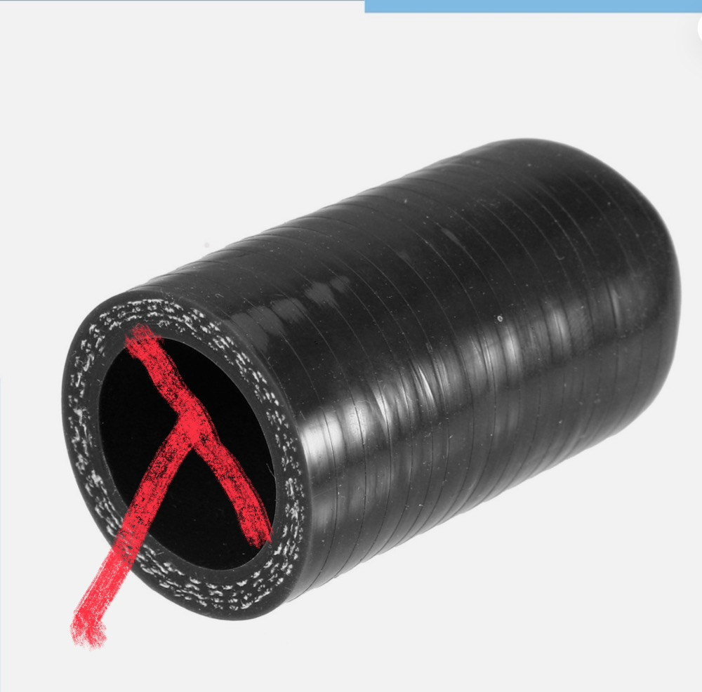

So I can just cap off these connections and do nothing else to disable the system and achieve my goal of eliminating the hose to intake nipples 3&4 correct? I personally like the looks of the air pipes. I mean they are chrome. Smiley
Anyone happen to know the inner diameter of the caps I would need for the two air control valve ports? I already have a plug for the air box port.

If you remove all the hoses from where they are attached to the motor, there's no feed to the valve body itself so no need to cap it off. Just cap off where the hoses are attached to the engine, that leaves the PAIR valve body isolated and inert. That's why I said you can leave it where it is and remove it later when more convenient.

Sorry for any confusion. The reason i asked about capping these specific connection points was because I only want to get rid of the pair valve and cap those 3 connection points and of course remove hoses 3&4 with T and cap those nipples.
Or…. Could I just leave the pair valve on and just cap the nipple on it ? This would save me from having to find caps for the pair valve connections. I would just need one cap for the nipple, then I could get rid of hoses #3&4 and cap them off?

Those vacuum lines are connected to the nipple on the pair valve. Wouldn’t capping that nipple take care of the backfire?
