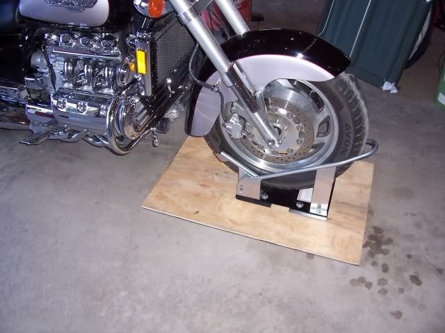

PIA but, loosen the bars.  Then you can move them so that the master cylinder is level.
Sodbuster
Posts: 1159
« Reply #5 on: June 16, 2010, 08:03:27 PM »
Get yourself a harbor freight wheel chock to keep bike level .... makes things a lot easier to keep reservoirs level after you've loosened bars.  I wrapped painters tape around bars and marked their home position so as to put everything back where it was.

« Reply #6 on: June 16, 2010, 08:44:27 PM »
Also, invest in a mity-vac .... well worth the money.
If it needs to be done while on the side stand.
It's easier to loosen the Lever/Reservoir clamps and snug level with the bars turned for bleeding. When finished realign the bar indent to the clamps top seam, torque the fasteners and repeat procedure on the other side. This gives a better leveling range when on the side stand as opposed to rotating the bars when the bike is vertical by center-stand or wheel chock. JMHO

Done!
I have a wheel chock (the black Harbor Frieght) so it was upright. Moved the master cylinder up the bar to get it vertical and level. Covered everything with old towels and didn't spill a drop.
Reinstalled the slave cylinder, with new seals (all 3). No one told me what a pain it would be to get the old seals out.
Bled and refilled as directed.
Ya know-sometimes when you do a job for the first time and it turns out OK, there is a good feeling of accomplishment. Makes you less fearful of tackling the next new chore!
I appreciate the words of advice from all.
