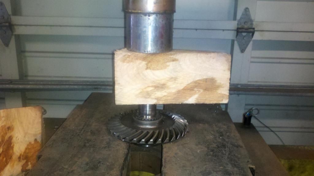

« Reply #9 on: December 29, 2014, 01:08:34 PM »
So far so good. I was able to press the spline sleeve into the ring gear with the 100 ton press at work. It was a little over-kill for the job! I installed the U-joint, assembled the final drive and I am waiting patiently for the new flange hub and driveshaft to arrive.

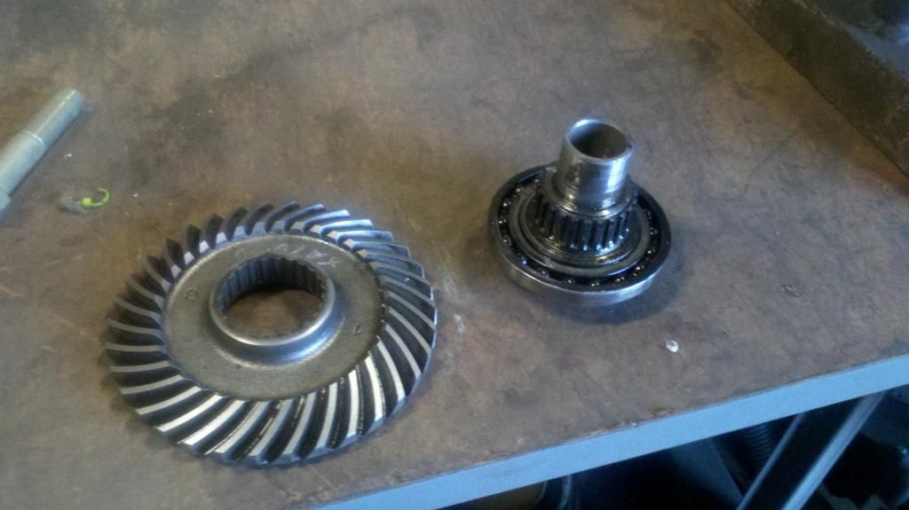

« Reply #14 on: January 05, 2015, 10:47:44 AM »
A pic of the process

« Reply #15 on: January 05, 2015, 10:50:02 AM »
And another

Wow? So you have already done the whole job and got the bike back on the road? Only 1 post with pictures??  Sad
I was hoping for a little more.

Glad to hear it worked.
My thought was hubcapsc  had an excellent tear down write up and the only thing I needed to add was how to press it apart. Any auto machinist can do the job as well. As far as ring and pinion set ups go this one would be easy enough but is unnecessary since the pinion gear is not disturbed and the original ring gear, bearing and shim is used. If you grab hold of the pinion cup and hold the spline sleeve and rock them back and forth that is called backlash. It can be measured with a dial indicator, I noted the original measurement prior to tear down. During re-assembly I painted a ring gear tooth with gear indicator paste, or you can mix white paint with wheel bearing grease. I checked the gear tooth contact pattern and it was fine. The backlash also did not change. I am confident that using this procedure utilizing the GW spline sleeve or pressing out a new one from a ring and pinion set is a great way to save money over a complete final drive. Having said all this I feel that this job is do-able by a skilled home mechanic, I have been a Journeyman Machinist for 22 years and I was a US Navy engineer for 10 years before that. My other hobby is rockcrawling jeeps and I have set-up countless ring and pinion gear set-ups over the years. I found this to be a fairly simple job but if you have doubts I suggest finding someone near you to help. I live 50 miles north of Seattle (GO SEAHAWKS!!) and am willing to help. PM me if you have questions.
