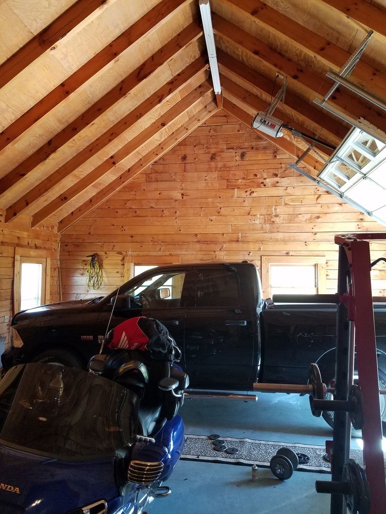

I have 4, 8 foot tubes in my garage. Looking at switching over to LEDs as well. My only issue is my peeked roof, lights are 20ft high. How the hell the previous owner ever changed bulbs baffles me. I backed my pickup in the garage and set my little giant ladder in the bed and was still 5ft to short. I think I'm going to have to rent a tow behind lift to get them in.

I've have 4, 8 foot tubes in my garage. Looking at switching over to LEDs as well. My only issue is my peeked roof, lights are 20ft high. How the hell the previous owner ever changed bulbs baffles me. I backed my pickup in the garage and set my little giant ladder in the bed and was still 5ft to short. I think I'm going to have to rent a tow behind lift to get them in.
dang,  20 foot tall garage roof inside.  You must have a nice garage??     coolsmiley
I doubt my 8 foot ladder in the bed of my truck would work being about 2-3 feet too short being 4 foot for truck bed,  7 foot both for ladder and me.  Not sure how you going to get up there 20 feet high?
I don't know if it's nice, just a lot of head room. I think it's more around 18 ft, sorry I exaggerated a little.
It's probably worth building a storage loft at some point to get some use out of all that wasted head room. I'm just starting out in this home, I've seen the amount of crap a man can acquire over long periods of time  Grin

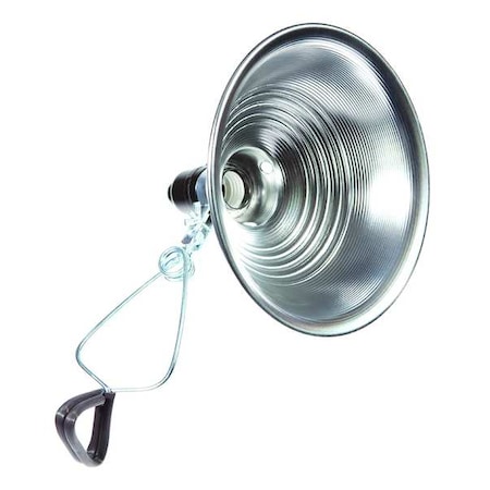

I use a few portable spots that can be moved around to what I am working on too.  This clamps to all two-by structural wherever you need them.
