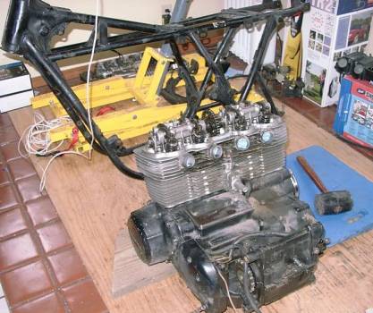

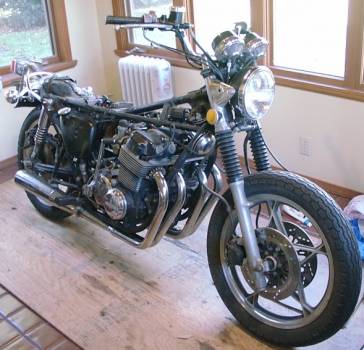

Picking her up today. Great shape. Been sitting for 2 yrs. Only two carbs on this one, so no big deal. LOL. First pic is what she looks like now. Second is something to what I would like to do.
Posts: 9735
« Reply #1 on: November 06, 2017, 06:15:48 AM »
That would raise the Kool factor considerably

New battery came with it. Had to put acid in and slow charge it. Fresh gas and some B12. Tried fire a few times but no luck. Pulled carbs and disassembled. Here's what I found. No wonder she wouldn't start. LOL. Got it all soaking now. Will reassemble later today. See what I get.
The carbs in my 75 wing that I got three months ago were all messed up also but not that bad.I finally got it running but not good enough to ride. I just bought a set of four vacuum gauges to sync them. I'm waiting for delivery from Amazon. Hoping to get it ready for spring. Got it cheap $750 an 32000 miles on it. I've always heard that they were fast and had a chance to ride it on my street for a few hundred feet,yup it's fast even though the carbs are messed up. Road test say 1/4 mile in less than 13 seconds.
Second bike has real clip-ons. So much better looking than those who simply roll the one piece handlebars over.
Bought my son an 82 CB450 Nighthawk for his first bike.
