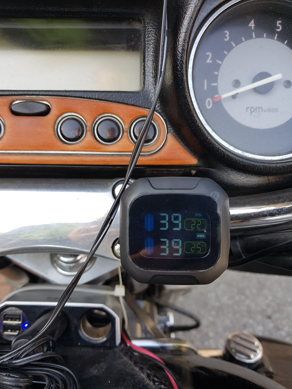

Follow up;
I had the TPMS system sent to my USA mail house, instead of home. It arrived in 2 weeks instead of 3 months.
Put my MC on the road yesterday. Check those pressure indicator caps, all good. Mounted the TPMS system, put the front cap on, and it showed 25 psi. Put the air pump on, pumped up to 35 psi, on with the cap again, and the TPMS showed 39 psi.
Rear tire, looked at the tire cap, solid green, off, on with the pump, indicated 15 psi. Pumped it up to 35 psi. On with the new TPMS, showed 39 psi.
I was going to mount the display on the fairing, but temporary on the handle bars, found this was a good spot.
I like, I think it's going to stay there. I left it turned on, went inside washed up, and came out about 10 min later, and the screen was blank. I touched it, and it lite back up. Just need to see how long the battery lasts before a recharge. Rode home, and showed a different temp frnt/bck and the rear psi went up to 39 also.
Conclusion: Those air pressure caps aren't worth S&^t!
Thinking of a second one for the trailer. With how easy it is to mount the display, I can remove it for when I'm not towing.

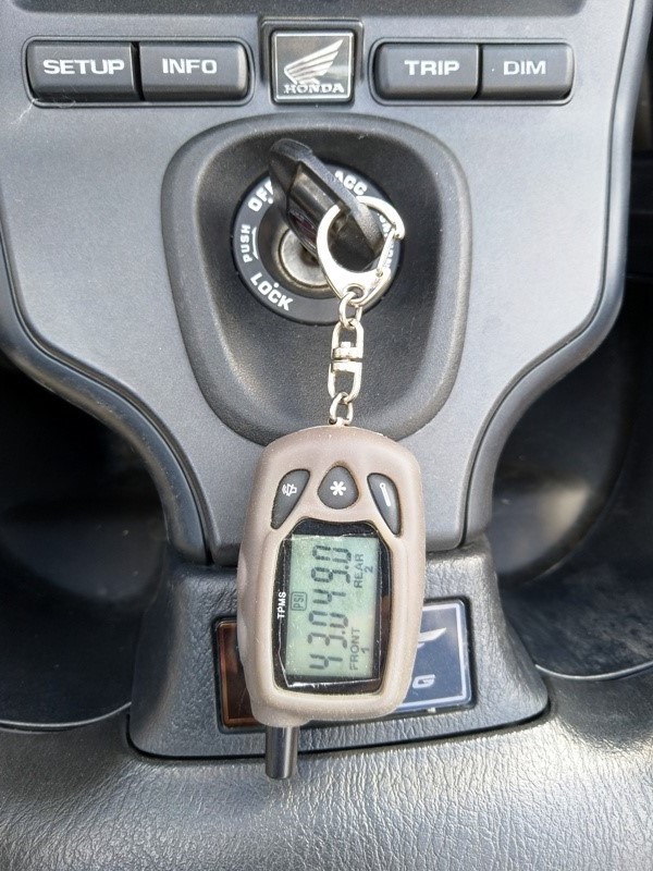

For my F6B I got the TireGard from Show Chrome.  It uses a single AAA battery that lasts for a year.  It clearly displays both pressure and temperature on a fob I can easily see while riding.  I have a Garmin GPS and leave my phone in my pocket, so a Bluetooth TPMS would not be very useful.  If you prefer to carry the fob in your pocket it will vibrate whenever the pressure or temperature reach user-set limits.  That would work better with the Valk's ignition key location, though you could also attach it with Velcro.
The TireGard cap/sensors only weigh .4 ounces and cause no problem with balancing.  The entire kit only costs $65 through Amazon, so I plan on getting them for the Valks too.  Here are a few photos.  Look how hot that rear tire gets!  Ambient temperature was in the 80s when I took these.
I absolutely love having TPMS. Since tubeless tires rarely blow out but instead develop very slow leaks, TPMS virtually eliminates the need for a roadside repair. You'll know about a leak early and have plenty of time to find a safe place to deal with it.
PSI:
Temp:
Front sensor:
