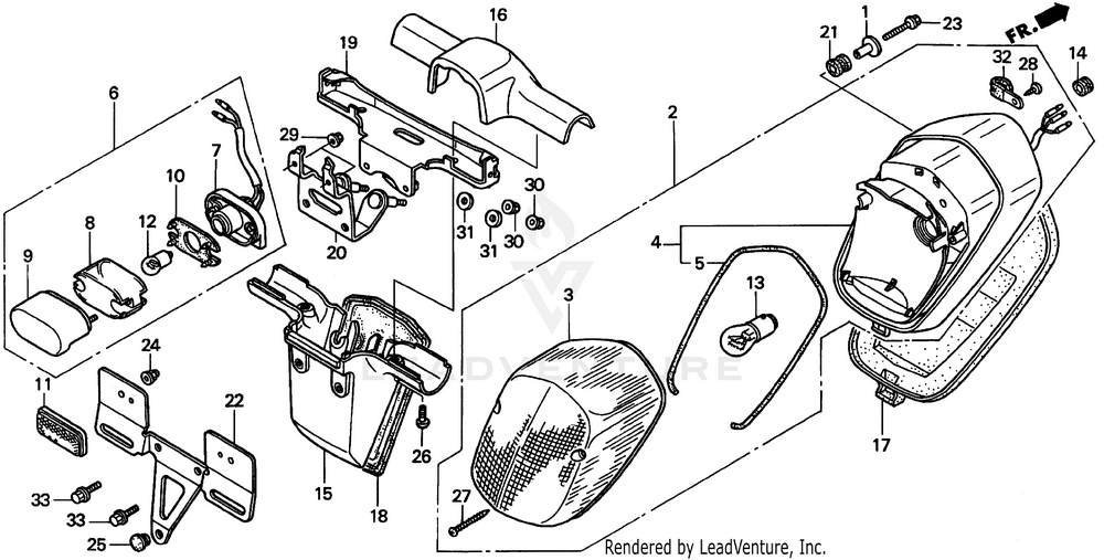

I justs purchased a rear tail light for my IS so that I can super Valk her. Could you please send me a few photos of the trunk brackets so I can see how you cut them for quick easy removal. Also maybe share how you wired your girl up so I can tell my Honda service guys what I want done. Thanks

Found it at bigBG
http://bigbf.com/bigbf_shop/mod_i-s_trunk/
I was thinking if this was the right one or not? There was one out there that had the slot the wrong direction. But this looks right. If the nut was to loosen, would the passenger sitting back, be pushing the bracket to the opening, or locking it in place. But it looks right, down, then pull backwards.
« Last Edit: April 29, 2020, 05:50:30 PM by gordonv » Logged

For the OP.  Did you buy the oem standard valk harness for the fender light.  If not you will need to make your own.  I did not slot the supports as my wife rides it and said she can get by without as long as I carry everything.  lol  i Installed a black plastic spacer and used the chrome nuts.

This is much more complicated than I first thought. The idea is to ride solo when in Super Valk mode. I have a Mustang two piece seat.
The light is a complete assembly. The only thing missing is the wiring and harness. I purchased it from a member in Alabama who graciously offered it to me. He purchased it for extra rear lighting but it wouldn't fit with his stock CB (same as Gord). My Honda mech will have no trouble connecting it to the bike.
I also really like the look of the rear fender and hard bags with nothing on the top, just three components all the same shape and colour. I will probably eventually have the pieces painted again if they are too scratched up. I'm hoping they won't be because I never remove anything (one plus to that).

The wiring is actually pretty easy.
Hard wire the new stop/run light into the harness.
Use a flat 4 (trailer connector) for the speakers, and the lights on the trunk.
That way all you do is pull the two connectors apart and remove the trunk.
Jim
I have the fender brake light, and picked up the Std/T wire harness A & B to go along with it. My intention was to permanently mount the brake light, and to make the trunk the one with the quick disconnect using the 4/5 wire trailer hitch connector.

You don't have to put a connector on your taillight wires. Just follow the wire under your right side cover and disconnect the plug then pull the wire and connector out from behind the frame.

Are you referring to the stock wire harness, sub harness A & B? Your correct, they would replace the A & B for the IS, to the correct wires for the fender mounted Std/T A & B harness. No other mod required.
The trailer hitch connector was for the IS trunk. If I remember correctly, it wires into the OEM IS sub harness. The mod could be added into the OEM main harness, or into the Std/T sub harness. It uses a  bullet connector. I was going to make a male/female bullet Y connector for the 4-way trailer connector.

Jess from VA has one but thought I would check with my fellow canucks first as shipping may be easier.
I do not have a std tourer taillight Will.
Well, I have one on each of my interstates, but you can't have those.
I bought both of mine as new parts.  Are they not available now?
If so, check Pinwall Cycle in OH.
OttawaWill
Posts: 28
Ottawa, Ontario, Canada
« Reply #28 on: October 25, 2022, 08:31:29 AM »
My apologies. I misunderstood. When I checked the online catalog it indicated it was not available. I will reach out to my local Dealership and inquire.
Took the fat lady to a Rip on the weekend to burn off the full fuel tank to make winter maintenance easier.  I was quite surprised how loud the exhaust was. I don't know that I would want it any louder. These bikes are awesome... I was cautious as the rubber is older Dunlop elite sport 3s and didn't want to push….. too much. Anyways got new Dunlop elite sport 4 on order and next is to prepare a winter maintenance area….
Posts: 31184
« Reply #29 on: October 25, 2022, 10:59:22 AM »
I checked my go-to distributor, and they are available.  And spendy for everything.
I also think you want one of the short wiring harness parts (to plug and play) which may not be in this schematic assembly.
https://www.procaliber.com/oem-parts?aribrand=HOM&arian=MOTORCYCLE#/Honda_Powersports/GL1500CA_(00)_VALKYRIE%2c_USA%2c_VIN%23_1HFSC340-YA300001/TAILLIGHT/c4988ec8-fa08-409c-a2da-dae8b92356fd/2014a224-6918-4a83-bafd-e46ac3919148/y
« Last Edit: October 25, 2022, 11:03:17 AM by Jess from VA » Logged

« Reply #30 on: October 25, 2022, 04:29:39 PM »
Thanks for sharing!
I didn't get around to contacting my dealer today.  I found something you posted before that I was using for my reference (http://forums.delphiforums.com/valkyrie/messages/?msg=11596.1&gid=2128709727).

« Reply #32 on: October 26, 2022, 10:25:19 AM »
Contacted Local Honda dlr. Obsolete.
Contacted pinwall - no stock.
Contacted pro caliber obsolete and no stock.
Looks like this project is on hold until I can find a used one..
Thanks for all your help.
Posts: 31184
« Reply #33 on: October 26, 2022, 12:41:18 PM »
Will, my recollection is vague, but there were two other Hondas that had extremely similar tail lights; they looked identical, but there was some small difference in the base and/or gasket and mount to bike. I think the lens was the same part number.   But they could be made to work... with some finagling.
I think one Honda Shadow version and the Shadow Ace (& Tourer?).  750cc and 1100cc, I think.
I'm sure there are some old posts on here about it somewhere.
Pinwall is the best Valk salvage outfit around, but there are plenty of MC salvage yards, but unlike cars, I don't think they are connected by some interconnected electronic search function.
« Last Edit: October 26, 2022, 12:44:22 PM by Jess from VA » Logged
OttawaWill
Posts: 28
« Reply #34 on: October 29, 2022, 06:59:30 PM »
I've ordered all the pieces separately as they haven't been marked as obsolete... Let's see if the order is complete... Time will tell.

« Reply #37 on: May 13, 2023, 12:10:55 PM »
Update:
All the parts arrived. They are all installed on the bike, including the Std wiring Sub A and B. I'v come to the connection point under the right side cover, and Im struggling to find the correct wiring steps needed. The bike is 120km from home at my parents, and I have very limited time to make the trek up to work on the bike. I went up this morning but forgot my laptop with the WSM on it not that it would have helped as The IS wiring diagram that is in the WSM is too blurry to make out what it what. I found one on the site that someone uploaded very clearly with colours, but it doesn't seem to match up with my factory wiring colours.
I have been so eager to ride the last few weeks and it looks like it'll be a bit longer.
I will keep looking for some guidance but all the old tech files are no longer avail.
Ill be sure to post updates as they become available.
Sorry  OP for hijacking your thread.
OW
