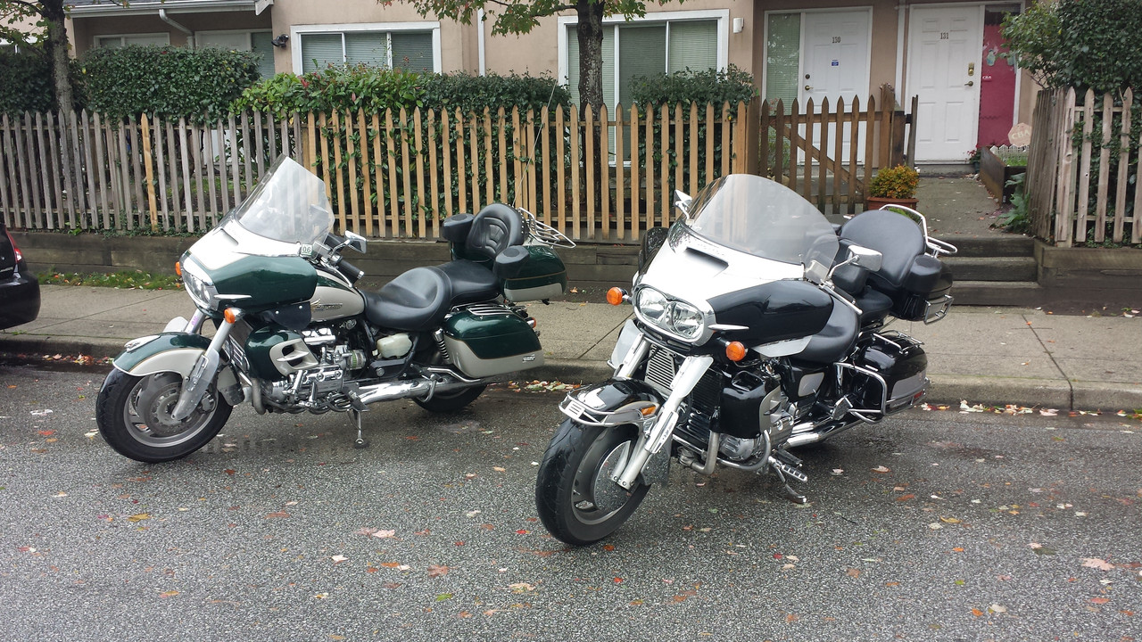

As for the buffeting, I've never noticed it, and I've ridden 3 different IS. My current one has the extra front deflectors on the forks just under the fairing. Only from wind over the shield.
Air Wings can also be added, and adjusted for extra or less wind, and might do what you want.
The green one had home build deflectors bolted on the chrome ones at the wheel, and the black one has the ones under the fairing.

You can also see the Show Chrome oversize wind shields on both bike, where the black one has had it trimmed down to the height of the extra width is. The extra I feels helps a lot in keeping the wind off my hands, cold affects them a lot.

Im thinking to make something similar what you have on the green lady. Under the fairing. The black deflectors. Did you made them your self? Whats about the Show Chrome oversize wind shields?

Just do a simple google search for Valkyrie Show Chrome windshield, and you should find a lot of pictures/suppliers.
