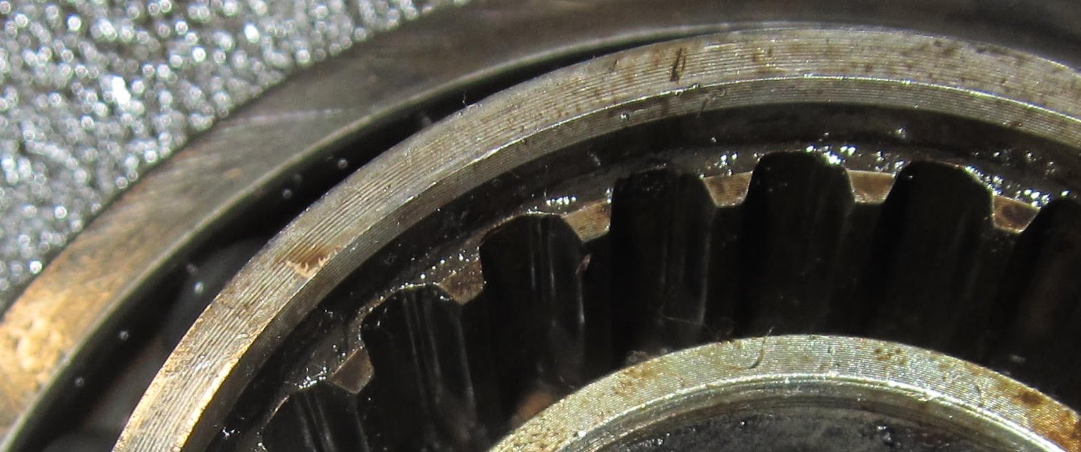

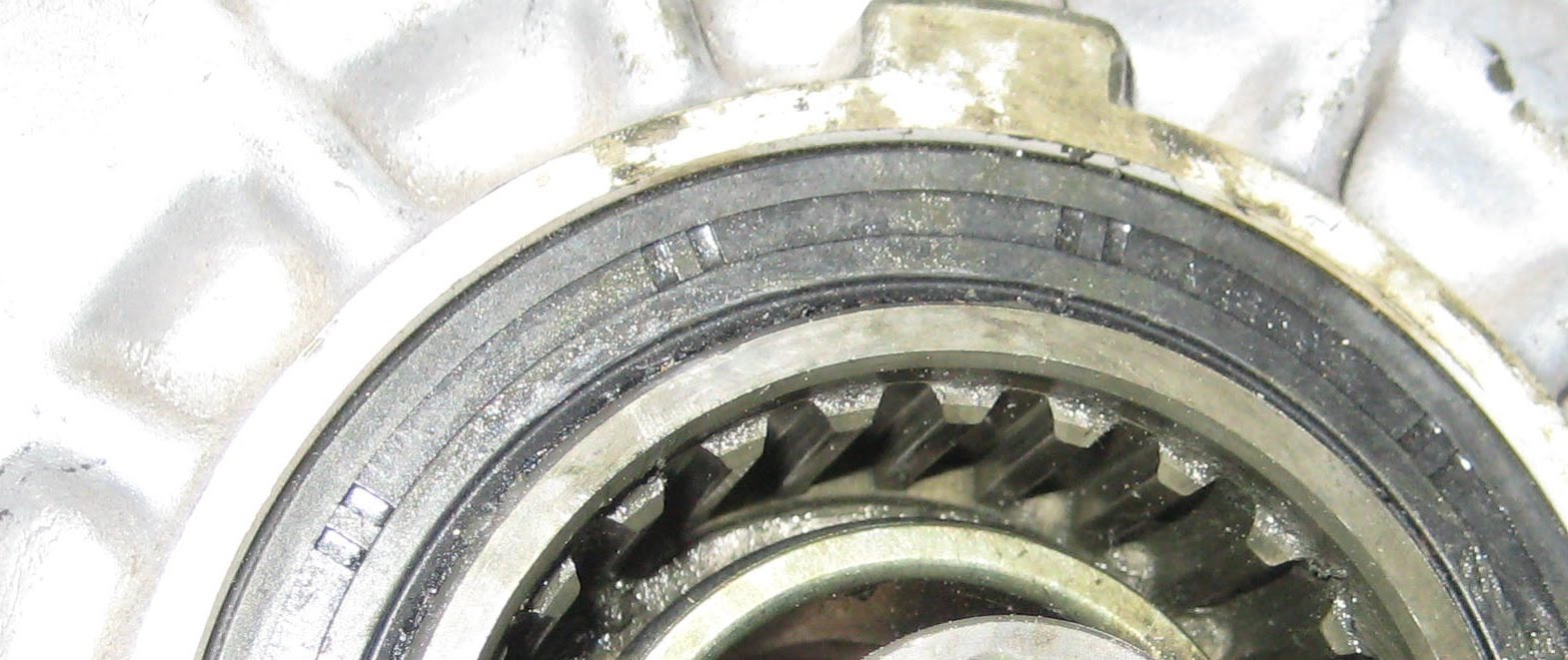

I bought a prestine 2001 Interstate last August.  21,000 miles, lots of upgrades, looked pretty much brand new.  Seller was a Valk guy.  Had a standard also.  Asked him about maintenance He assured me it was all good.  I took his word for it.  I road it until it needed a new rear tire this year, about 3,000 miles.  To my suprise the gear and wheel flange were bone dry and full of red rust, and metal.  I would say gear surfaces are 50% worn out.  Now I own another Valk, 2001 standard so well aware of maintenenance procedures, and I should have gone with my gut and pulled it apart to make sure.  Don't know how much more damage I did in that 3,000 miles I road it but it's not good.  I went ahead and greased it properly and put it back together, It works but it's iffy to me to travel to far from home.
     In doing reasearch on this, I could try and find a good used  Valk replacement, anybody got one they are willing to part with?  Buy used 1500 wing parts and replace trashed gears (doubtfull), or by new parts and replace in old rear.    Now help me out on this last one.  In buying the 413--mzo-000 final drive gear set, and the 42630-mt8-305 flange set rear wheel.  Is what I'm trying to accomplish is the female gear will be pressed off of ring gear and pressed back on old ring gear?  The only part I need from the gear set is that female reciever gear for the wheel flange?  Re-use the spacer and special washer from original unit.  Any othe parts I need to buy?  I see it has 2 seals in there also.  How hard is this to do with standard shop press?  Or should I take it to a local machine shop and let them do it?  Just those 2 parts are around $500 dollars.  Not sure which way to go.  Any help is appreciated.

I found a used 1500 wing final in good shape for cheap and used
those parts. Buying new parts requires proper shimming, a skilled
step I got to skip by using the same ring gear. I got the machine
shop man to do the pressing for me, it seemed simple if you
have a press and know how to safely operate it.

Mine is 23 yrs old. In the bike's 10th yr, I took it to a shop for a tire change. They appeared to put it back together right. About a yr later I had moved and took it to another more trusted shop.  Their tech took it apart and found bone dry and rust. I asked him to do the grease and button it up. It's been going fine for about the last 9 or 10 yrs. I run it hard. Just my experience. Not suggesting you do it like I did.

Well when I changed the rear tire the last time, mine was completely dry and 25% worn. The o'rings failed thus I installed new Red Eye set. Lesson learned. Going to keep an extra set on hand for future tire replacement.

The most straight forward way to do this job is to press the splines off the donor ring gear and your Valk ring gear, and press the good splines back on your Valk ring gear. Use all the original spacers, shims and washers back in their original positions as the clearances are already set up for your pinion and ring gear and nothing has changed there, and original gear lash is maintained. Pretty straight forward process, need to be careful where you put the sealant when reinstalling the cover as to not block a breathing passage. You also need a good driven flange when doing this. This approach saves a lot of gear setup time and the cost of new gears as 1500 wing final drives are pretty cheap and used to be plentiful,, maybe still are.
 I saw this approach being done by hubcapSC on this board when I like you discovered my new to me Valkyrie had the final splines chewed up. Several have done it this way with long lasting results. If you want a hand when you get ready, just let me know Ron.
