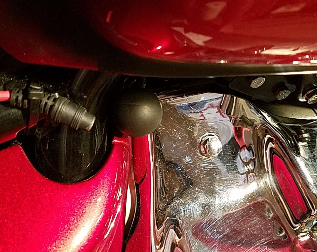

I put Pingel petcocks on my bikes.  Tired of those OEM problems.  I JB welded a paddle on the lever so I can find it easy, on Jade.  Pretty much never need it, with my IS and belly tanks, plumbed as a super-reserve.  On George, the extra large coils due to the blower block access to the Pingel from the right, and the air intake to the single carb, and the horn block access from the left.  So I fab'd a linkage to easily move the petcock valve from the right side.  All my Valks have Dan-Marcs (except George), powered through a latch relay from the coil power circuit for fuel security.  They also have an LED indicating power to the Dan Marc.
When the ball is pulled out, fuel is on.
« Last Edit: June 12, 2021, 09:00:47 AM by MarkT » Logged

Amazing engineering and fabbing ideas into reality Mark.  Very slick!  I love the LED indicating power to the Dan-Marc idea, and how you've made that Pingel easily accessible.
As expected the Bullet's wonderful vroom-vroom is back -- with some issues.  I'll explain more, but Adasanya is about to fight...
