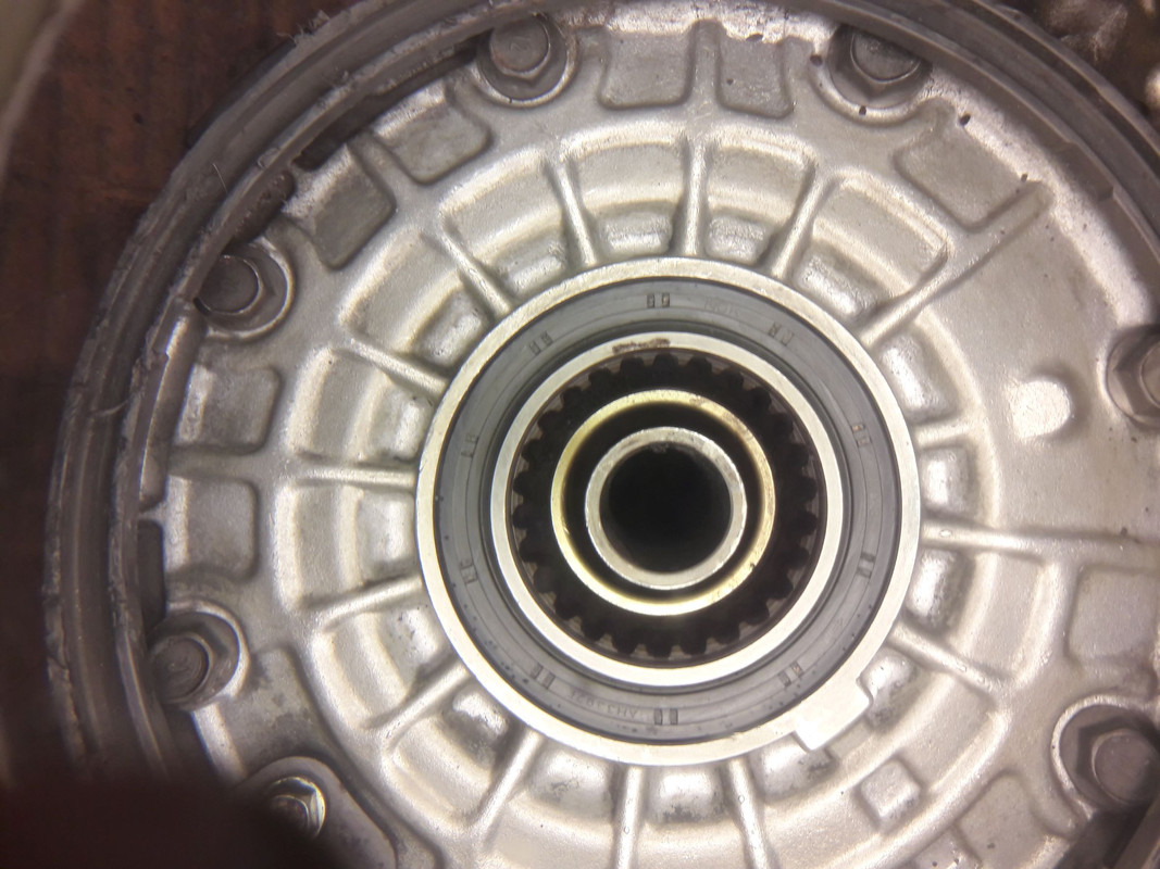

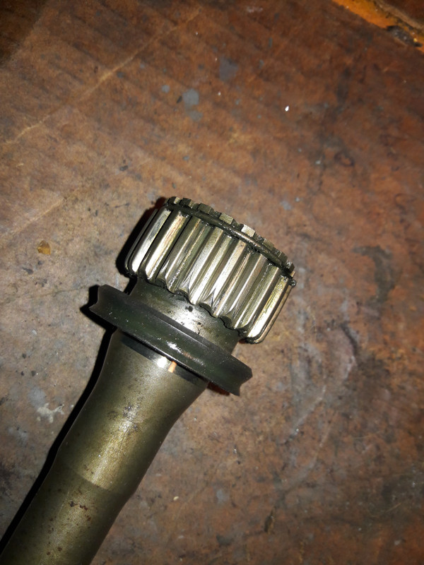

Here we go! Here's how they looked upon discovery.
How they look after cleaning. Note the wear on the drive splines. The flange splines look a little rough too.
The drive shaft. Looks good from what I can tell. I haven't stripped the grease from pinion cup yet to inspect it. I figure it's good if the if the shaft splines are good. We'll see.

« Reply #5 on: November 09, 2021, 06:04:41 PM »
I agree with Rob, you caught it in time for many more miles.
I too paste on the moly then add waterproof grease.
Replace that seal on the driveshaft, it keeps water out of the pinion cup joint.

« Reply #6 on: November 10, 2021, 06:05:21 AM »
Lots of waterproof grease in the drive and a little moly on the flange and pay attention to assembly sequence and you’ll be good for quite some time

My initial thoughts were that I'd just be cleaning the splines on the wheel and freshening up with new moly grease but I'm worried that there's a bit more to it concerning the shaft drive and O-rings.
Is there a list of parts anywhere that I'm going to need? I believe there's a neoprene washer and three O- rings. Do they come in a kit by any chance?
I have seen a YouTube video where a guy ( granddaughter helps with the filming) does a spline service. If you've seen it is there anything else I need to know?
Thank you.

Earl, are you saying you leave the spring on or off? I'm pretty sure
a awful thing happened when DDT's spring was left off once,
but I could be mis-remembering...
snip
He called it a stopper-ring which I think means the circlip and stop-washer that retains the spring on the driveshaft under tension. I reinstall the spring, circlip and stop-washer, preferring not to have a loose driveshaft spring to drop and roll away while I marry the final drive/driveshaft/wheel together. This design was on the original naked Goldwings from the 70's, spring circlip and stopwasher.
They ALL came from the factory with them, who am I to not reinstall them?

The ring people want to leave out for some reason is the one on the other end. On the splines that go into the pinion cup. I don’t leave that or any other part off

If you replace the 2nd oring, you'll have to pull the 5-star driven flange. A teflon washer (5) sits on the obverse side of the 5-star flange. You'll think it's not there but it's under the grease. It's thin and semi-translucent.
And don't lose track of and forget the teflon washer on installation, otherwise this happens.
