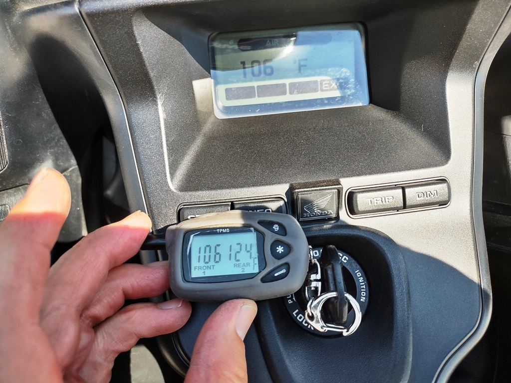

If you get the type of TPMS with senders built into the valve caps, I'd only use metal valve stems. In fact the instructions warn against using rubber stems. Here's the TireGard sender. I have them on my Valks and F6B. Second photo was in NE Colorado on my F6B last Sunday. That rear tire gets hot when the temp is in the triple digits! No wonder they wear out so fast.
