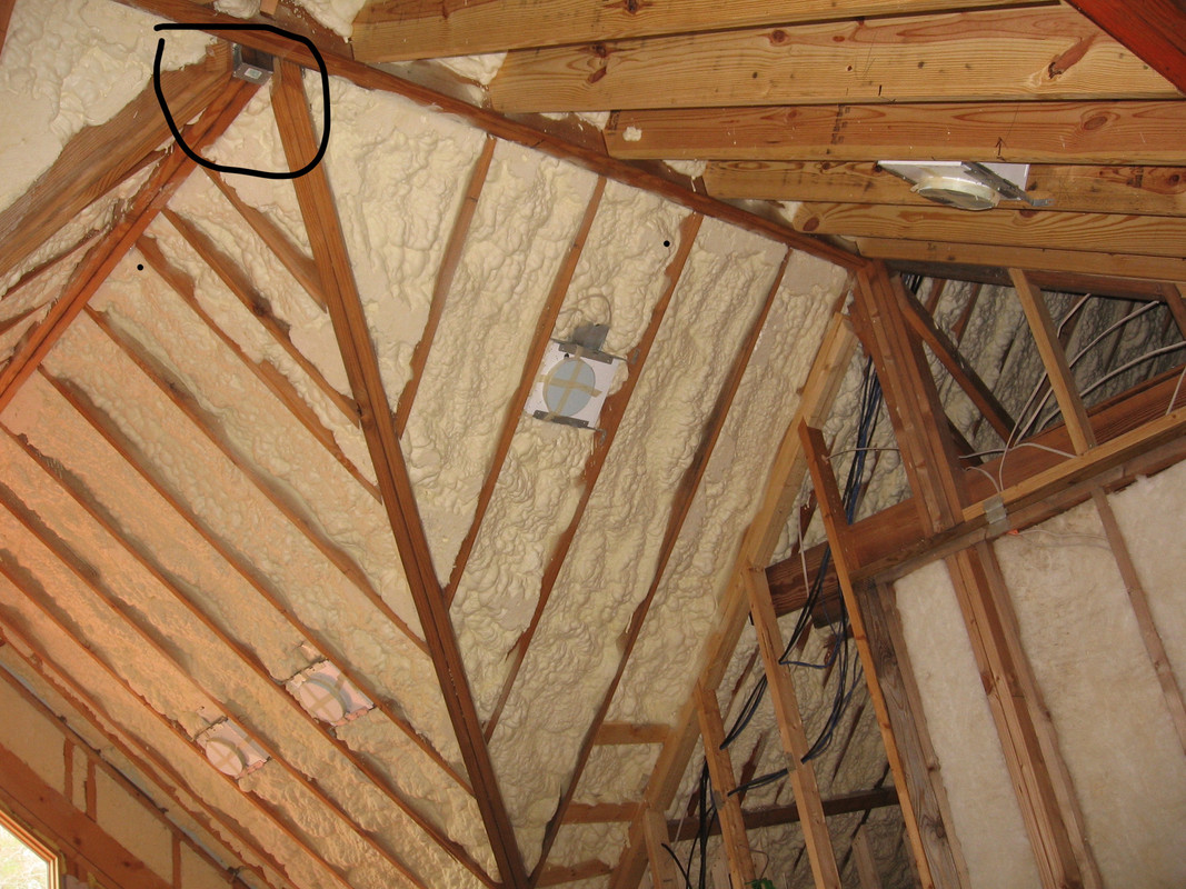

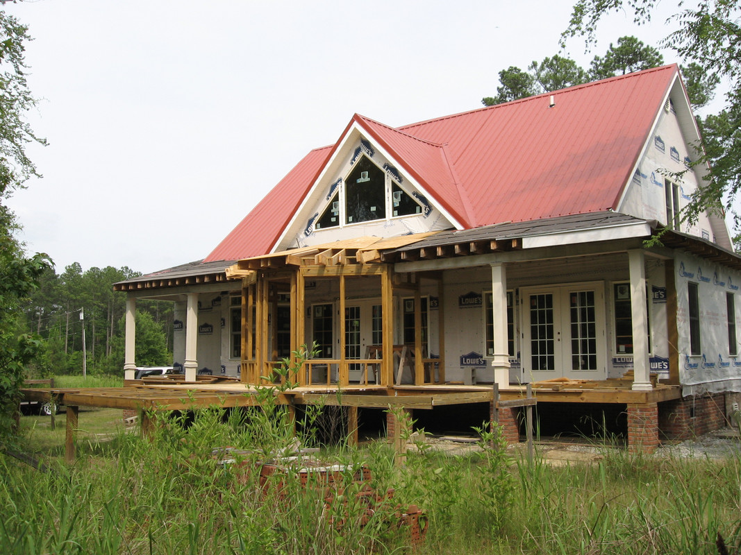

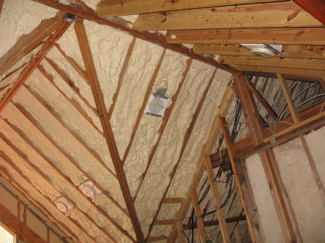

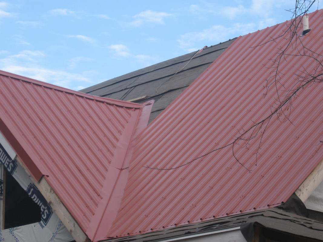

Oh here are some pictures of the area
The outside area of the roof before the metal roofing was completed.   Yes there is a potential rain intrusion if I did not do the roofing metal correctly "attached".
And a distant view of the finished roof and yes it is possible that the area could leak but it has not done so for 12 years or so.  I will have to check, (if I ever get back up there) to see.
And this is a picture of the area where the beam joins the other beam (sorry don't have the right words) but the mold (potential leak) is in the area of the top left.

Regarding the roof leak, yes, my first thought also.  Will try and get a good look at the area around the spot and see if there are "stains".
If it was five or six years ago, I might just put put scaffold and take a trip to the location (will might need some magnetic soled shoes).
I have on minor concerns when ever I  attack a problem like this with "sealant". And that is if I do not do it right, I can actually re-route the water were I don't want it.
Wish I had an actual picture of the area from a close up but I don't.

Yeah,,,, if its a leak, it is not the best place to "access".   The metal roof is steep and slippery, even when dry.  Would have to rig up some thing to climb up the spot..

Well…from the look of the location if you’re feeling up to it, you can drill a small hole at the mold spot and use a small camera with video to inspect the area.
If it’s a leak, it could take several minutes for water to make its way down to that spot. Also, unfortunately a leak could be from wind driven rain which is very hard to replicate unless your spraying water under pressure and at various angles.
How after the completion did the spot begin?
I’m having a hard time getting my bearings with the photo of the ceiling before sheet rock, because the photo with the mold it looks like there’s an open area to the left and up maybe near an exposed rafter. Is it near the metal hanger in the before photo, because at first look I thought all the white above the mold was open for skylight and I thought there was a leak from skylight.
I will inlcude the image again with the interior area circled.  Its were the beam that forms the peak of that part of the roof goes outward to the outside wall.  All the rafters come down from it to the top of the great room wall.  That metal piece you see is the "thing" that is used to join the pieces.  There is no sky light. only a window in the outer wall in the great room.
The roof was finalized in say 20011.  So its ten years old.  (well ten years since fully finished.). The leak occurred over the last few weeks and yes, we had one heck of a rain storm about four or so weeks ago. Really heavy rain and wind.  It was something I thought about is a possible source of the leak (if there was one).
I think I said this before but, based on the information here and my own thoughts, I believe I will try and remove the stain my methods suggested in this thread and see if the mold re-appears.

I looked at the picture and there is some dark on the wood at the top most point of the joist. I would say leak like everyone else has said and yes ventilation would be in order if you do not have enough.
The picture is not really clear but what is behind the wall that you pictured? It would be pretty easy to drill or dig that out and see if there is water behind it or its soft. That would give a much better idea if the water is behind that wall or on the surface and if its an actual drip or water is collecting there.
I would not put any sealer until I establish where and what the cause is. Clorox and another product I found Spray Nine with the Clorox has been really good at eliminating any mold seen. Spray Nine has a disinfectant in it that seems to be very good at removing mold.

That peak point is mounted to a beam that runs the length of the room.  The ceiling slopes downward and I can go up in the attic (and have) and inspected the area where the beam runs from left to right which is where the roof peak beam is mounted and there is no discoloration.
I truly wish I had some way of putting on a jet pack so I could get a closer look and actually feel it.  But..

Looking closer at the pictures  , I do not see ventilation.
 A leak in a roof that was foam insulated can take a long time to leak thru. Take a good look at the eaves for any signs of water. I hate to be a downer  ,but I still do a lot of home repairs. I no longer go on roofs or in crawlspaces.

After realizing the photos you gave us they can be clicked on and blown up better on post image the dark spots on the double ridge joist that runs to the front windows Robert referred to could be the culprit. Typically those dark spots ar an indicator of some water. Starting with the roof would be the best bet. It could be as simple as one of the screws but which one will be tough to figure out.
It really seems there is a lot of coverage over the seams and the ridge caps but a screw which didn’t grab or may be stripped and loose or even a screw that was relocated and the hole not addressed with a sealant may be the issue. I like Roberts idea of opening it up to see if it feels damp or went back there.
If venting is the issue or you want to try venting, start small with something like a round 2” or 3”soffit vent and spray paint it white to blend in, I don’t think anyone would even notice it.

Something I sort of left out which may make some sense, my wife and I built the house.  With the exception of the HVAC, sewage and water piping we did it all.  Oh, I tired to do the foam but it failed, so it and the gutters along the roof edge were farmed out to "professionals".
As such, some of the framing members were exposed to "weather" for some months until the basic roof coverings could be added.  This exposure did result in discoloration but I have yet to find any...... (best not to speak of it out loud).
Something I find very interesting are the screws used in the metal roofing.  I forget the vendor but I put all screws in per manufacturers recommendations.  I tried not to over crush the little "rubber" washers.  Over the years, three or four screws "unscrew" from the metal.  The back out on their own.  I suspect by temperature change but it only happens on the more "vertical part of the roof and the lower levels.
Also I want to thank everyone for their comments on this off topic.  I really appreciate any feedback.  One never knows it all.
Here are some pictures showing the way it was put together.
The vertical support and ridge:  March 2008
All trusses (?) in place. June 2008
Initial covering:  July 2008
Final Tarpaper covering:  September 2008
Oh, and just for fun, wife's first use of the "chop" saw.

Jess, that is a possibility.  Looking at the way the roof was sealed in that area tar paper and metal sheeting, it is possible and we did have a very powerful rain storm several weeks before the spot appeared.

On the way home, I stopped by a local roofing contractor who specialized in metal roofs, Achelpohl Roofing & Sheetmetal, Inc.  Business is family owned, son taking over from father five years ago (business is 30 years old).   I spoke with the owner about the problem and he sent out a tech to look at the roof.  He climbed to the top of the roof area which would be the location of the suspected leak and found all things in fairly good condition.
He did note that there were some cracks in the calk at the joint area and he applied additional sealant.  He said that I might received a bill or not, depending.   I sent them an email thanking them and providing my mailing address.  The gentlemen said he did not suspect a roof leak in the area but...
