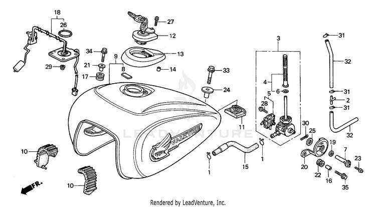

I've been wondering for a while if my petcock is a genuine oem Honda.
The reason is the Reserve has never worked.
The bike had only 12,000 miles on it when I bought it two years ago and it's now done 18,000. I did think of desmogging and fitting a Pingel but instead replaced all the fuel and vacuum lines and fitted a new petcock cover set.
I also don't like the idea of having to delve underneath with a gloved hand to switch the Pingel off
I don't know if there are any alternative petcocks like the oem with the vacuum port. I know some have been talked about like the cbr600 (I think) but some have said it's discontinued.
I'm happy with the set up. I always turn the petcock off when I stop. I always use E5 petrol and fill the tank up over winter and add Ethanol Free additive.
So, my question, ..... how can I tell if my existing petcock is genuine? I've removed it in the past, cleaned it out etc,  but there's still no Reserve function, so I question if it's genuine.

Well, I've tilted the tank over and I've answered my own query......
It's a genuine oem petcock.
I haven't got any closer as to why it's never had  "Reserve" function but that's never been a problem as I know when to fill up.
However, the mystery remains and if I knew how to fix it I would.

The other possible reason for no reserve is the screen tube in the tank.  Reserve draws from the lowest point, and if the screen is fouled down there gas will not flow.  I think.
My bikes get remarkably similar gas mileage with only small variations for constant freeway speeds/RPMs.
I know I get about 220 miles to reserve on my Interstates (but I fill the tank sitting on the bike, and slow feed it right up to the neck, every time, if the pump will slow feed).  I reset the tripmeter at every fillup, and watch my tripmeter more than my gas gauge LED bars when I am getting low (which aren't so useful when the tank is low).
So get a handle on your usual miles to reserve.  And fill up the same way every time.  Reserve is 1.1 gallons for all bikes.
As mentioned, the petcock is finicky, and you should feel for the slight little detent click when moving it from Off to Run to Reserve.  It must be positioned correctly.  It should be set by feel not by sight.

« Reply #12 on: July 15, 2023, 12:28:07 PM »
... the last time I filled up, the tank took 19 litres of petrol having done 183 miles at 44 miles per uk gallon. If there was any left in Reserve then there would only have been  around 1 litre in there assuming that the tank holds 20 litres. I believe that "Reserve" is meant to be more than this.1 litre would only have left me around 10 miles of Reserve.
That's empty including what should be reserve.
Reserve on the OEM petcock is determined by a (brass?) tube that leads up from the petcock.  If that tube is broken off or removed then the fuel will always flow through the reserve outlet.
The other possibility is that the switch is not truly moving from one setting to the other.  There should be three settings; on, off, and reserve.  You should feel a sort of click as it drops into each position.  If you don't there's an issue with the petcock switch mechanism.
I don't think you have a big issue.  It's a small issue and just a challenge determining why.

I took the petcock out when I cleaned the inside of the tank.
I took the filter off and the brass tube and flushed everything clean. When I turned the control you could ser that all was working plus I put on a new Cover set.
I carefully refitted the gauze over the brass tube and could see how it fits tightly about 2/3rds of the way up .
Could there be some sort of "leak" at the bottom of the brass tube that is allowing fuel to flow through and so negating any Reserve?
I'm very careful about ensuring that the control clicks from one point to another.

Knapdog - Not me who bought your Pingel. I buy direct from the manufacture (too many Chinese copies).
Discard the vacuum tube from inlet manifold and cap with a stock plug. Pingel used to do a vacuum operated tap but I can't see it on their site http://www.pingelonline.com/prodcat/fuel-valves.asp. Wouldn't fitting a diaphragm operated tap negate the point ?
Fitted lots of Pingels to "customers" bikes never had a problem.
The CBR 600 fuel tap part number 16950-MAL-603 is a manual tap and the Valk chrome parts work with it (after discarding vacuum tube and and capping).  In the UK, Fowlers in Bristol have em in stock
BTW the desmog has nothing to do with the fuel tap you use. The PAIR valves and their associated tubing can be left in place, it makes no difference to the fuel delivery system.

I appreciate that desmogging has nothing to do with the fuel tap.. I'd actually bought the kit from Redeye (now sold) but when I could see you had to cut one of the pipes off when removing them I decided against it as it seemed there was no way then of reversing the process. Hence, I just renewed all the "rubber" tubes, vacuum and fuel.
If I went ahead with that cbr600 petcock, because I'd like to keep the chrome extension on/off/reserve switch, and removed the vacuum pipe to #6 inlet manifold are you saying that all I'd need to do is push one of those plugs on the inlet manifold as found on #1, #2 and #5 ?

Yep they are called Boost Caps part number 16075GHBB70 (https://www.fowlersparts.co.uk/parts/4907177/gl1500cy-2000-ed/cylinder). You need to use the filter off the Valk, CBR is too long.
Star man  cooldude
Steve, that part number is coming up as an o-ring. Is that right?
Sorted it, Steve.....
On the parts diagram it's #6...

At the 183 miles, you're at where I usually am at when I get to reserve, then I look to refuel.
My petcock wouldn't turn off, or need to turn to reserve. Then one day when I was desmoging and doing a lot of work when the tank/air box needed to come off, I looked into the petcock. Found nothing wrong, and it was working fine. Back together, and now it seems to run out of fuel when it should off/reserve. I've a spare petcock, and a rebuild kit.
You do know you can put the petcock together so it doesn't require the vacuum shut off?
How do you do that?

I have been using the, CBR 600 petcock part number 16950-MAL-603 for over 2 years now. It’s a manual petcock, no vacuum needed. All the chrome stock parts (Run, off, reserve dial, will go back on the bike and work with this petcock.
I do test it occasionally by turning it off as I’m riding, it has stalled the engine after two minutes of running, so it still works fine.
CBR600 petcock now ordered, £116.
How do you do that?
....... and thank you for all that info regarding "Reserve" etc.
I know I've seen pictures of it, but here is the post I had saved.
http://www.valkyrieforum.com/bbs/index.php/topic,18092.0.html
Basically the the spring keeps the valve closed till vacuum is added, then it opens. You move the spring to the other side of the diaphragm and now it stays open even when vacuum is applied/released.
Found it!
http://www.valkyrieforum.com/bbs/index.php/topic,37577.0.html
Knapdog

I have now fitted the cbr600 petcock and fitted a Redeye cap on #6 intake.
You can advise me differently but I left the new and longer than the oem, gauze filter on rather than swapping over for the smaller oem one.
It is a bit too long and when I fitted the new petcock I could just about feel it hitting the top of the tank snd bending over a bit, but it's plastic. It will bend and it's brand new. It fits the brass tube perfectly and I left it on.
I took the bike for a short spin and it felt better, almost as if the "handbrake" had been on a bit previously.
I opened up the throttle and it just went. I can only put this down to freer fuel flow.
This was a good move. I was already used to switching the petcock every time I stopped and that won't be a problem.
Looking forward to comparing the old with the new in the days ahead.
