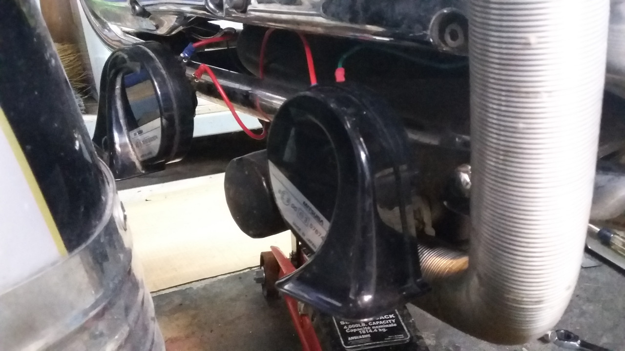

« Reply #6 on: October 10, 2023, 06:16:35 PM »
I've mounted a set of GL1800 horns on my IS. Was inexpensive used on ebay.
Also bought these louder sets online.
waiting to mount.
« Last Edit: October 15, 2023, 09:06:20 PM by gordonv » Logged
« Reply #7 on: October 10, 2023, 06:27:25 PM »
I mounted a couple car horns down under the frame on my Standard. They are loud. But, I must admit I hardly ever use them. Whenever the need arises I react by avoidance, whichever form that takes. By the time I’ve stopped or got out of the way, it’s not needed anymore. Maybe I should practice the horn on some snowbirds here.

« Reply #8 on: October 13, 2023, 10:55:29 AM »
Hey guys... got any photos of your install? Looking for ideas...
I did run it through a relay bringing power from the battery, and the OEM horn wire to trigger the relay.
I did learn you needed to Y the power to the 2 horns, not through one to the other.
Posts: 13777
« Reply #27 on: October 26, 2023, 05:27:01 PM »
during full fork compression, high chance the fender will hit the horns. mine did and why I have then installed behind the lower crash bar. I used the bolts for the lower radiator hose support bracket.

Since this is a horn and relay discussion... adding a h&r thread from awhile back...
https://www.valkyrieforum.com/bbs/index.php/topic,112698.0.html
Did all that work and ended up ditching the horn I had... looking to do something that doesnt look hideous....... Cool
RonW
Posts: 1867
Newport Beach
« Reply #29 on: October 29, 2023, 02:18:12 AM »
Since this is a horn and relay discussion... a thread from awhile back...
That was among the most detailed step-by-step threads in the annals of the Valk forum.
It's also an example that even though you might know the wiring schematic like the back of your hand, you're less than half way there. Routing the actual wires is another animal altogether.
Dunno about anybody else's experienc, but you'll reach a point where it'll occur to you that if you had routed the wires this way it woulda been better than the way you have it. However, to re-route, it'll take an hour. But what the heck, I'll re-route it anyways. It's the priciple of it.
Then after you've done all that re-routing, things aren't any better than how you had it except that hour took two hours.
My only suggestion for people who plan to route wires is to use a dummy wire for a practice run. True, who the heck is going through all that trouble.
2000 Valkyrie Tourer
mello dude
Posts: 999
Dayton Ohio
« Reply #30 on: July 11, 2024, 08:58:05 PM »
A bit of a rehash....so wire 2 horns in parallel, not in series?
0leman
Posts: 2359
Klamath Falls, Or
« Reply #31 on: July 12, 2024, 07:27:35 AM »
The two horns on my Valk are wired parallel.   Recently had to do an annual cleaning on them so wiring is fresh in my mind.
pancho
Posts: 2118
Bonanza Arkansas
« Reply #32 on: July 16, 2024, 06:10:15 PM »
Definitely wire them in parallel if using only two. If two are wired in series, there will only be six volts applied to each and they will not make much sound.
