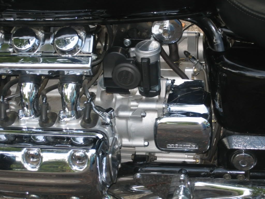

« Reply #3 on: February 05, 2010, 05:00:02 AM » |
Here's my Compact Nautilus on a two-piece aluminum angle bracket mounted to the sidestand bracket. It is LOUD (and fun)!

« Reply #6 on: February 05, 2010, 02:24:56 PM » |
Mine is right up front so I get full benefit. It's right there, see if you can spot it.   It's inside that right side radiator pod.
