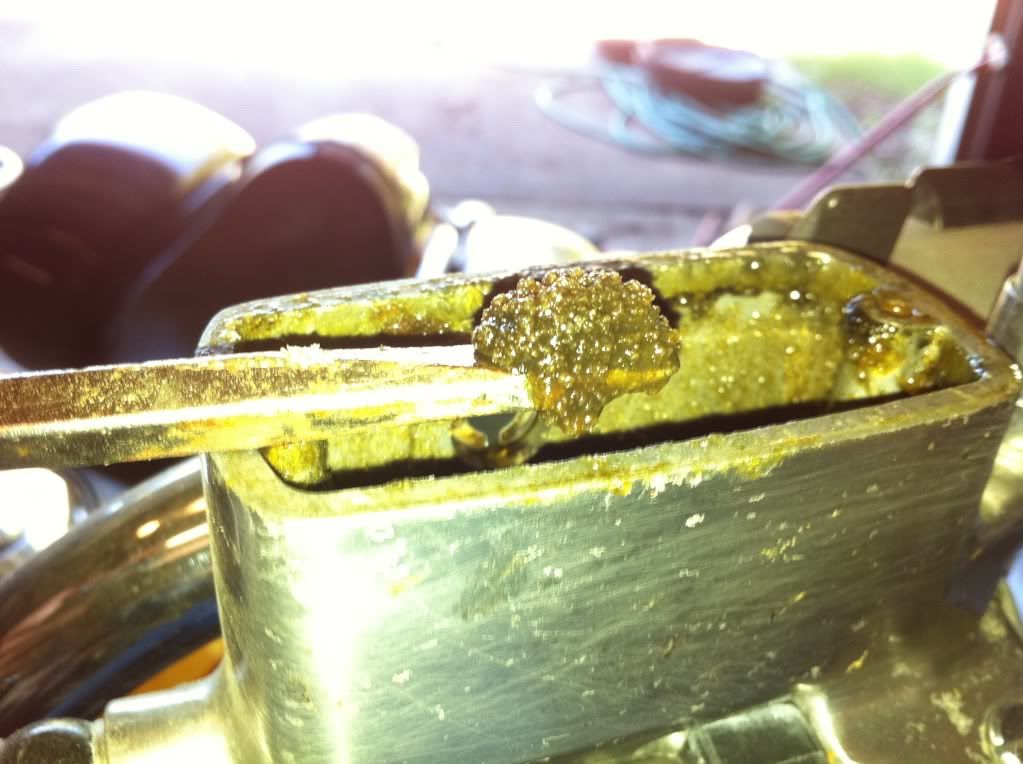

Ok, gentlemen. Please forgive me for going AWOL on this matter. At the time this problem occured I had just opened a bar in addition to my day job and I didn't even take the bike out of the trailer for a week after I got it home. But enough excuses...
When I did take the bike out of the trailer, I started it up and it pulled like there had never been a problem. This made me think that it will be a very difficult diagnosis since it's coming and going. I became frustrated and parked the bike since I didn't really have time to invest in major troubleshooting or the money to spend for a dealer to diagnose it.
Today I came home sick of not being able to ride. I decided to start simple. Opened up the clutch master cylinder and it has ALOT of trash in it. Sludgy crap that brought a tear to my eye. Mostly in the bottom but also up the sides of the inner walls and some on the diaphram. I have very little experience with this kind of thing. How should I proceed? I have a strong feeling that this crap was clogging up the line and creating my problem. But of course it could just be a secondary problem. Anyway, how do i clean this situation up? Can I wipe this crap out and bleed the system til I get 100% clean fluid at the far end? Do I need to replace any parts? What fluid is best? Sorry for all the questions but you guys are my trusted source of info.
I don't have much time to mess with it tonight due to my oldest daughter having a volleyball game and then i have to work at the bar for a while...It's always something...
But again, Thanks for any help you can provide! cooldude

« Reply #17 on: September 30, 2010, 05:58:13 PM »
Yes remove the fluid, clean up the rest with a Q-tip and bleed the systems until clean fluid is seen.
Use any GOOD quality DOT 4 brake fluid.

« Reply #18 on: October 04, 2010, 04:52:42 PM »
All cleaned out and flushed. Fresh new DOT 4 bled through system. Rode good and hard for about 25 miles at various speeds in various gears. Could not reproduce the problem. I am 99.9% confident that the gunk in the master cylinder and lines was causing the problem. If I can remember how to do post a pic I'll attach one below. This is a medium blade screwdriver with about 10% of the crap on it. Seriously. This was one tenth of what was in the master cylinder.

« Reply #19 on: October 04, 2010, 05:09:35 PM »
What did the fluid look like when you bled the lines ??  WOW .... if it were mine I think I would wonder what's in the slave cylinder. I wouldn't be able to sleep at night unless I overhauled the whole system.  Also, if the clutch side was neglected makes you wonder about the brake master cylinder ............ maybe the same scenario ??
VRCC # 30938
Bartman
Posts: 42
Sherman, TX
« Reply #20 on: October 04, 2010, 05:49:01 PM »
Disconnected before the slave and bled that side first. Some trash, but less than I suspected. Reconnected and bled all the way to the bleeder. Again, very little trash. Bled through til I got beautiful clean fluid. Surprisingly, the brake side is good fluid and has zero of this crap in it. I'm not sure what the previous owner did differently on the clutch side...

« Reply #21 on: October 04, 2010, 05:59:00 PM »
I had a brake system act this way.  The master cylinder wasn't allowing fluid to return when I released the lever.  Every few actuations of the brake, I had to release pressure at the slave.
Made it a long trip home.
I'm sure that the crap is what your problem was, preventing the pressure from releasing.  It probably bled back slowly, so after a week, was fine, until you pulled the lever again.
Sounds like you got it fixed.

« Reply #22 on: October 04, 2010, 06:07:03 PM »
could that crap be dot 4 and dot 5 mixed?? i've never seen anything like that!!!!!!! Shocked Shocked
Sodbuster
Posts: 1159
« Reply #23 on: October 04, 2010, 06:14:59 PM »
I think you may be right .........
VRCC # 30938
Bartman
Posts: 42
Sherman, TX
« Reply #24 on: October 04, 2010, 06:59:37 PM »
I kinda wondered that myself. It wasn't purple at all, but who knows what the chemical reaction would do to it. Maybe that is silicon on my screwdriver???

« Reply #25 on: October 04, 2010, 08:17:44 PM »
I think it's just old fluid that has absorbed moisture and coagulated.
We recently worked on a bike that hadn't been well maintained and it was like that too (but not quite as bad.)  I've seen it several times on bikes that simply haven't had the fluid changed often enough.

« Reply #26 on: October 10, 2010, 07:08:13 AM »
I think Valkpilot is correct about the moisture, I changed the fluid in my I/S just two years ago, my clutch started feeling a little goofy last month, after seeing this post I checked mine and had a similar mess, cleaned and replaced fluid, bled out old crap and all is well again, I did ride in the rain a lot this year (maybe not the cause) It was extra hot here and the shiny parts absorbed a lot of heat, probably just condensation.  Weird though, have never changed the fluid in any of my cages.
