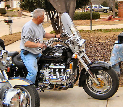

« Reply #12 on: May 21, 2010, 05:23:22 AM »
  Even tho this job was probably 'above my pay grade' too, it was a piece of cake.
         Now I just need to inspect the rears . .
« Last Edit: May 21, 2010, 05:30:40 AM by BnB Tom » Logged
godfire
Posts: 1321
Republic of Texas
« Reply #13 on: May 23, 2010, 06:06:27 AM »
 2funny Seems to me whether I'm "wrenching" or "watching", the wrench party pay is always $00.00.
I take that back, one time it was $000.00.  2funny
And in your pic, the guy in the red is just a little too close for comfort!  crazy2

« Reply #14 on: May 23, 2010, 06:14:09 AM »
Either that or he's teaching the guy in blue what's like to ride something other than a Valkyrie!   Shocked
