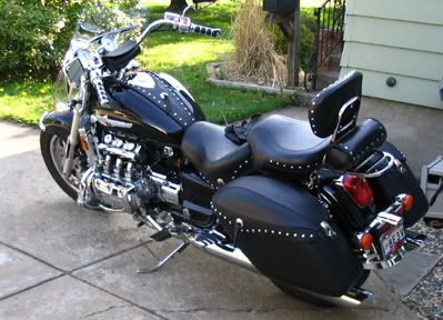

I'm putting the Mustang hard bags on mine (they come plain or with studs).......
Got 'em for $705.00.  They were on back order for 2 1/2 months, but they've finally been delivered and are happy in my garage eagerly awaiting me to install them.  They come very well packed and secured in a hard fiberglass box.  The box alone must've been 100 bucks.  I'm going to use these to mount them on.....

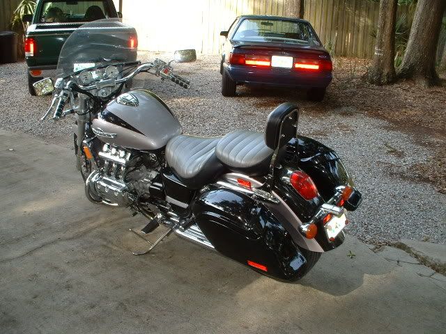

Mutazu bags $348 delivered in gloss black. They are a lockable hard bag with lights, no they are not going to win a prize for best bags but their not bad.

because the honda bags are made of gold......yeah i know...i have bought a pair of used Harley bags for 300 they are very clean and black so paint isn't a issue at the moment, after i make the brkt i'll have about 350 in to them.

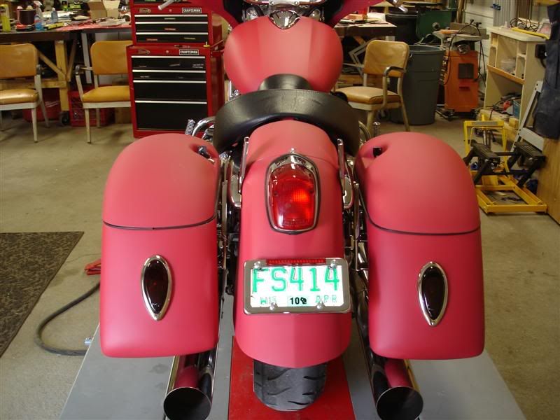

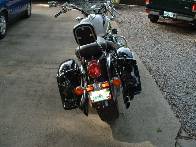

Got the same bags / same deal as RTaz. Since "Dragonfly" is Black and FASTER than all others, I did not have to paint them. Cheesy coolsmiley
https://picasaweb.google.com/103917731019176896112/HardBags?authkey=Gv1sRgCMKX7ZPyoPq-_wE
You can't beat them for the price. Their suggested carrying capacity is 10 lbs each.
They do hold up nicely with the brackets that come w/them... although a bit of reinforcement would be good.
You need to open and close them w/TLC... do NOT place ANYTHING on the lids when they are open.
Rear lighting is great.
They come with another / different set of lights.
I generally liked the others w/different light fixtures... but I thought that the other lights are too large for my taste.

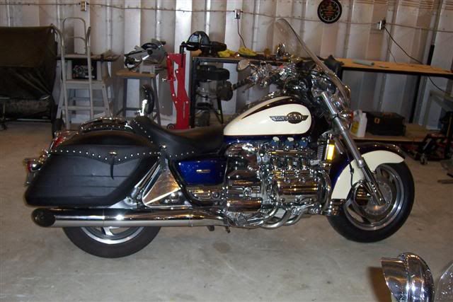

Back in the day, the NC bags were very inexpensive....about $450 with the mounting brackets and shipping included.  I ended up putting more money into the paint job than the bags cost.  Seems like over the past few years, NC has "fair trade" type pricing...everyone seems to be charging manufacturer's suggested retail price...closer to $700 or $750 for the bags and extra for the brackets.  At that price, the OEM bags become a better option.  The nice thing about the NC bags is the quick release feature.  Five seconds and they're off the bike.
The new vinyl covered Mustang bags are nice....read somewhere that these are made by the same overseas people that make the jumbo bags (Tsuyaku or some such).  The benefit of these is you don't have to spend a lot to paint them.  If I had to buy new bags, then these would be at the top of the list.  Got to handle them at Americade and they were nice.
old picture, but shows the bags match the bike well...

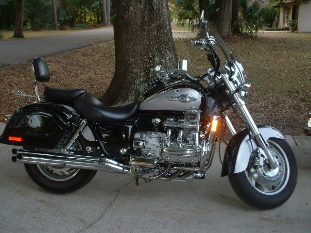

Nice job on the bikes shown here...  cooldude  RTaz... for the cheap Mutazu's... you did a great job on making them right for the bike.  I've been thinking about the RS bags, but up in the air.  I have the smaller LN bags on my Ace and they work but have to be babied cuz of the cheap quality.  Plastic with plastic hinges.  They are holding up for now.  Their brackets were thrown away.  I have EasyBrackets on Ace and Draco.
