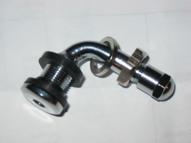

I know over the yrs riders have had the valve stems go bad. The OEM are made from EPDM syn rubber which is designed to meet SAE standards for longivity. The old style natural rubber type some of which are coming from china at a cheaper cost last only about 2 yrs.
see this list of compatable chemicals with EPDM.
 http://www.fbs-online.com/Centre/Prod/EPDM-chem-com-res.htm
from the list  Petroleum, certain type of oils including kerosine, motor oils, etc., and even Chlorine Water though not as severe as the oils, has a moderate effect. Reading though the list it also looks like some chemicals that are in waxes and other cleaning products can have different levels of effects. This might be why some are going bad and others have no problems.

« Reply #1 on: August 10, 2011, 07:47:17 AM »
Problem solved, permanent, had them on for years.  Hoser  cooldude
 http://www.shop.shinhopples.com/product.sc?productId=1129

« Reply #3 on: August 10, 2011, 08:59:21 AM »
Come on, CA.  Have you ever held a patchboys in your hand and compared it to the oem?  If you had, you would know that the non-metal parts of a patchboys are only the seal, and when properly installed, the stems do not flex.  Will it fail?  Sure.  Even the metal parts will eventually fail.  But those failures will most likely not be immediate.  The problem with the oem stem is that the non-metal parts allow it to flex.  (What are those little plastic keepers that snap onto the wheel there for???).  Factory stems can go slowly, but they can also go quickly.
To advocate the use of an obviously inferior product when the solution costs $4.00 plus shipping is unwise at best.
PM, email, or post your address and I'll send you a pair to put in your saddlebag.  But do it soon.  Wink

« Reply #5 on: August 10, 2011, 09:49:49 AM »
the honda valve is rubber supporting a 90 degree metal stem. this puts a lot of stress on the crappy rubber base. car valves are straight and do not experience the torque that valk valves are subjected to. patchboy stems are all metal with the rubber seals protected from sun exposure by cupped metal washers. the fact that many of us have experienced failures on the road speaks for itself.

« Reply #7 on: August 10, 2011, 09:58:23 AM »
I have to agree with you CA.
I've been using the stockers now since I bought the bike in 2000 and have not had an inkling of trouble.
The recent replies seem to me to smack of intolerance and overstatement. Obviously couched in terms of scare words which are designed to impress the lesser (Valkyrie) experienced riders on this forum.
The stock air stems are a well designed assembly that Honda would not have caused to be manufactured if there was hint of non-reliability.
Regarding that particular air stem (patchboy) I can see great danger in the way it is constructed especially in view of your post on the material used in the application of the stem.
I can see that particular item blowing out of the wheel when the nut on the inside of the tire loosens up enough (from the deterioration of the rubber causing looseness) to allow the nut (which is hidden inside the tire) to pop off!
Now I also want to point out that there must be many riders who without good mechanical aptitude will simply continue to push against the stock stem using the rubber mounting to give enough resistance to enable the air chuck to operate and fill the tire and then again do the same with an air gauge.
I feel confident that is the reason Honda put that support along with the stem.  Still, I suggest that a finger behind the stem is a reliable means to eliminate any future problem with the stock assembly.
I also feel that riders who have trouble with this particular item is directly related to their experience with their automobile tires in which case they can simply press down on the air stem with little regard to any consequences since it is a straight line force applied directly to the wheel rim through the stem.
I won't encumber this post with further observations.

Can't vouch for the OE stems, when I changed out tires, I got these at Jake Wilson. The nut attaches them from the outside so you can check tightness on occasion.

I'm using patchboy air stems because my rear stock one sprung a leak around the base...seemed the prudent thing to do since it was replaced when the tire was installed...about 12k miles on it when it went...thankfully it went while I was parked... Undecided
The only other thing I have to say is to the lesser experienced Valkyrie owners...if you let the little stringy piece of your pink frilly thongy panties ride up the crack of your arse, you're going to get all pissy and show your arse...and I don't care if that statement impresses you or not...Cool

The front valve stem on my bike failed causing a sudden and complete loss of air in the tire. Both my wife and I were on the bike traveling about 70 mph when it failed, but thank God that other than a scare, nothing bad happened. At first, I thought that it was a tire failure, but after closer inspection I found that it was the valve stem which failed, and not the tire. I hadn't had the bike for very long, and to be honest, I had not even checked the air pressure in the tires since purchasing the bike (just did the ol' kick and squeeze the tire to see if it was nice and tight).  I then checked the rear, and found that the rubber around the base of the valve stem was cracked very badly as well, but was still holding pressure. I know that some on this board think just because I haven't been riding a Valkyrie for years and years that I'm too stupid to understand the extreme mechanics of checking the air pressure in the tires, maybe so, but I'm smart enough to know a poor design when I see one. The stock valve stem design with nothing but rubber base holding a 90o metal stem which is held in place by a crappy little piece of plastic is an extremely piss poor design to begin with. Looking at some of the other postings about the Patchboy or the Jake Wilson, it's easy to see that these are much superior designs because the seal at the wheel isn't actually part of structural design of the valve stem, but only used as a seal which is held in place by a much more secure metal nut. That being said, I replaced both stems on my bike with short straight valve stems which will not place undue stress on the seal, and also allows me to use those cool looking lighted caps for the valve stem  cooldude If I were to use the 90o valve stems, I think that I'd go with the Jake Wilson design because as "hmt81" stated, the nut is on the outside of the wheel, and would be easy to tighten if needed.
1998 Standard - Pearl Sedona Red & Ivory Cream
Mr Steve
Posts: 181
Feeding Hills, MA
« Reply #22 on: August 11, 2011, 12:19:52 PM »
I had a stock stem fail on my front wheel.  I always hold the back when filling.  What happened was that plastic holder broke and flew off at some point and I did not notice.  The forces then caused a split in the rubber right on the inside where it flexes.  I noticed it because the bike suddenly wanted to go straight and I had to fight to turn even enough to get to the breakdown lane.  Didn't cause an unplanned get-off though, thank $deity, slow loss rather than rapid loss.  Was all quite uneventful.

« Reply #25 on: August 12, 2011, 07:20:03 AM »
That's where I'm going next time.  Wrestling the rear end / final drive just to break the bead and tighten the blankety stem is a REAL pisser.  It just had to be the rear...
FWIW, when 5_19's oem front stem failed as we were riding out of Cheyenne, WY, there were four in our group.  We all had tools, three of us had compressors and plug kits, and two of us had extra patchboys stems.  However, none of us had c-clamps, lift, or lift adapter.  But, Hay, there was a dead-blow mallet in there...  What got us back to town was that were able to run zip ties from spoke to spoke and under the stem to hold it "closed".

I choose to use all metal stems (and pay a few dollars more for them, nothing close to the $32 a set that has been claimed here though) because it gives me piece of mind that If/when that little plastic support goes missing the valve stem will support itself and not tear causing a loss of pressure at speed. I think that a straight valve stem would be fine as well, but there are clearance issues there which create problems when adding air or checking pressure.
I don't know that anyone on this board intended to lay out an edict that all OEM stems must be replaced with an all metal variety, I think that people were simply offering advice.

« Reply #27 on: August 12, 2011, 04:30:40 PM »
In all this thread there are no reports of failures of the unsupported replacement stems.
Incidentally, I've personally seen two of the OEMs fail with the plastic support piece intact.
My policy is to never wish bad experiences on folks just so they will learn, but I'm definitely fighting the urge in this instance.  Smiley

too think that centrifugal force can cause them to fail, is to say that all of the honda engineers failed their centrifugal force calculation classes in their first and second yr of engineering school.
Its amazing that after all of these posts, not one comments or tries to discuss the links I provided to the chemicals that detetoiate the EPDM syn rubber used in the OEM valve stems. One of the items that ruins them is petroleum distillates which are in all cleaning fluids, cleaners and polishes/waxes.
so maybe the OEM valve stems are failing from the products being put on them unknowingly by their owners. I believe that this is the most logical reason for their failure.
Jess Tolbirt
Posts: 4721
White Bluff, Tn.
« Reply #29 on: August 12, 2011, 05:03:46 PM »
not the chemicals,, its the cetrifigul force applied when the little plastic thingys wear out,,,
i use the straight stubby regular valve stem like on a car...just bend it out to check the air ,,i will not have another valve stem fail on me with Bev on the back,,the metal ones look like they would be great but mine have no force applied to them,,,

« Reply #30 on: August 12, 2011, 05:30:19 PM »
I have experienced two (one at speed) and seen another one. Not a huge number, but I have intimate experience with only 4 bikes (8 wheels) and those three are the only ones without plastic supports. (As stated before, simply my experience).
Incidentally, the one failure at highway speed was on an 8 year old bike with 20k miles.

« Reply #31 on: August 12, 2011, 05:42:25 PM »
The fact that Honda provided an extra support for the OEM valve stem tells me that there was some consideration on the Honda engineers part.
I don't comment or discuss the chemicals you refer to because I have little knowledge or experience in chemistry and do not feel qualified to have an opinion. Since you have requested my input in that field I will agree that chemicals most likely contribute to the problem. I don't see how this supports your proclamation that the OEM are equal in quality an performance to a replacement which is all metal.
The all metal valve stems have a much smaller surface area to be affected by chemicals and petroleum distillates, and the seal which is exposed is much thicker than the OEM stem wall where (in my experience) failures occur. It would make logical sense to me then that regardless of whether you are entirely correct, I am entirely correct, or (as is most likely the case) there is contributing factors in both of our arguments the all metal 90 degree stems are somewhat superior to the OEM.
If you choose to run the OEM stems, knock your self out. I am not on a crusade to convert the unwashed masses. I am simply sharing my experience and offering recommendations.
Can we now go talk about oil or tires or something else everyone can agree on? Maybe Petcocks and Pingles?
