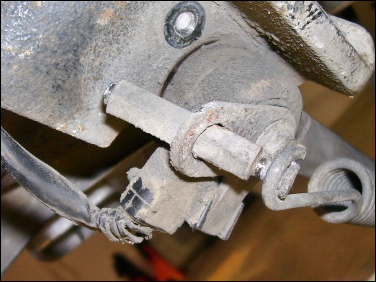

I just installed a new side stand spring (the nickle trick worked great) and side stand spring bolt.  Side stand works great but now the side stand switch is not 'disengaging' when the side stand is up.
I'm assuming that I installed the spring incorrectly.  Does the side stand switch rotate with the side stand? Mine is not.

« Reply #1 on: November 14, 2011, 05:27:45 PM »
No it doesn't rotate.
Here is the spring connection,

« Reply #3 on: November 14, 2011, 06:58:45 PM »
Bone,
Thanks for the picture!! I know exactly what I did wrong now.  I did not pass the bolt though the slot on the switch body.  I was pondering what that slot was for Smiley

« Reply #5 on: November 14, 2011, 08:44:05 PM »
I'm glad you fixed the glitch. The metal plate that the two bolts go through serves as a keeper. It takes two bolts to align the tab (X in pic below) on the metal plate with the notch in the sidestand switch. In turn, the metal plate locks the switch from rotating out of position. If you don't mind me asking, what was the reason for installing the new spring?
