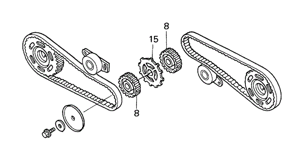

Up date--1 or 2 belts? don't want to take cover off till i know as much as I can.
2 conflicting diagrams.

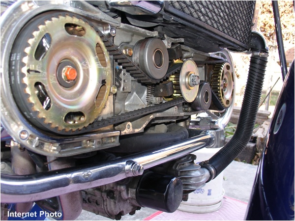

« Reply #31 on: March 22, 2012, 04:54:17 PM »
I have not taken cover off yet. I'm getting conflicting diagrams, one shows 2 belts, another shows 1 long belt. Undecided

« Reply #32 on: March 22, 2012, 05:21:37 PM »
All have two belts only.
macdoesit
« Reply #33 on: March 22, 2012, 05:25:07 PM »
The reason I ask Ronw 3 replies up looks like 1 belt.
Valker
Posts: 3049
Wahoo!!!!
Texas Panhandle
« Reply #34 on: March 22, 2012, 05:46:04 PM »
The belt on the right side (looking at the picture) is actually behind the one closer to the camera. There are two toothed sprockets in the middle, but you are right about it looking like one belt!
Ok, thanks alot now I can move on. The pic had me  uglystupid2

This might help you:
http://www.hdlparts.com/fiche_image_popup.asp?fveh=3477&section=148776&year=1998&make=HONDA&category=MOTORCYCLES&dc=2291&name=FRONT+COVER+%40+TIMING+BELT

The right and left belts are offset from each other including the tensioners something like the graphic below. The only reason I wanted to pull the cover was to spray the backside of the cover with a sound deadening compound but then there was potential issues with the compound flaking off and screwing up the operation.

These engines all have 2 belts.. As mentioned, if they are installed improperly then quite a bit of damage can occur.. If installed 1 tooth off the valves will end up having a serious argument with the pistons.. The pistons always win.. Engines don't run well with even one bent valve..
