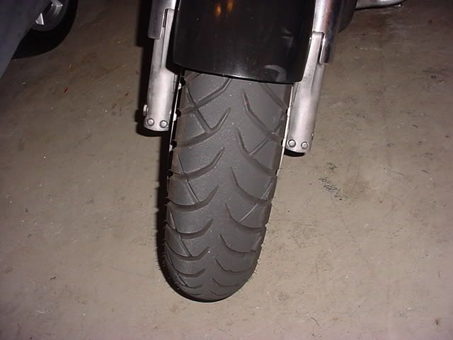

Heres a pic for whoever it was that wanted one of the front.
First is on the Valk 1K+ miles so its new reversed arrow so it sheads water rearward.
2nd is on the R* 12K miles currently NOT reversed.
I flip my fronts evey 4K so the wear evenly.
As I use very low pressure then most 28-30psi cold.
They are rears after all and on the front dont have anywhere near the load or stress as they would when used as rears.
