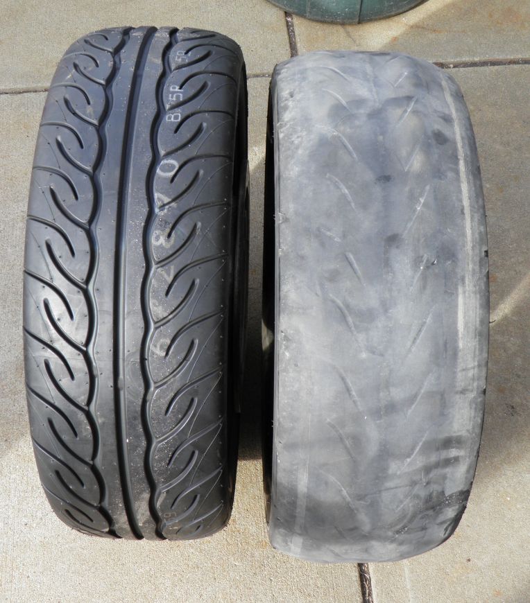

My Yoko A048 wore very evenly - and very fast -  at 34lbs.  It's a soft racing tire with minimal tread depth to start with.  Now on the Neova on the left, expect to get much more mileage with a harder compound and deeper tread depth.
« Reply #5 on: June 25, 2013, 06:29:14 PM »
damn you might have been able to get another 1/2 mile out of that tire, you pulled it too quick!
