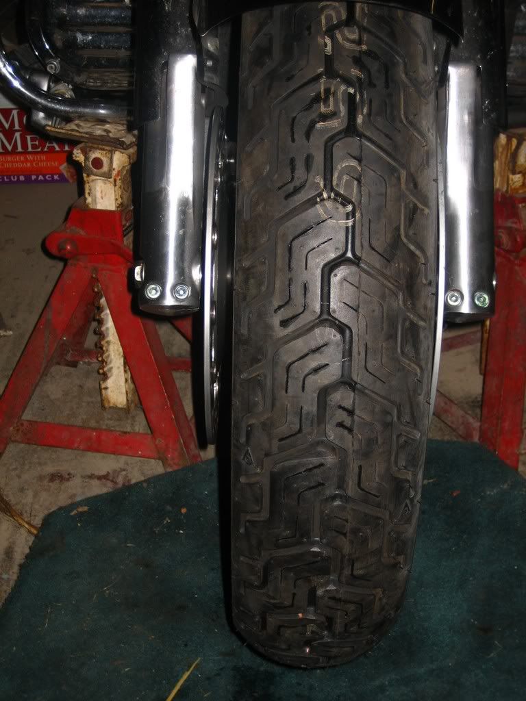

I just put a Dunlop D404 on the front of my 99 I/S.I don't go triple digits but do ride quite aggressively and ride twisties more often than not.I have a Goodyear Triple Assurrance on the rear and run about 40psi in both front and back.Time will tell about tread separation and tread life but right now,my first impression is that I love it.Possibly due to tread compound and/or tread thickness, the ride seems much softer and quieter than the E-3 at 36psi.Traction and handling seem great and will keep a close eye on tread seperation and performance.
Bone
Posts: 1596
« Reply #16 on: July 16, 2009, 10:47:48 AM »
I'm also running the D404 frt. on the front with a Goodyear TT. This is my second D404. Getting good mileage and they fit my riding style. Just rode across the country & back. The 404 handled every surface I rode on.
