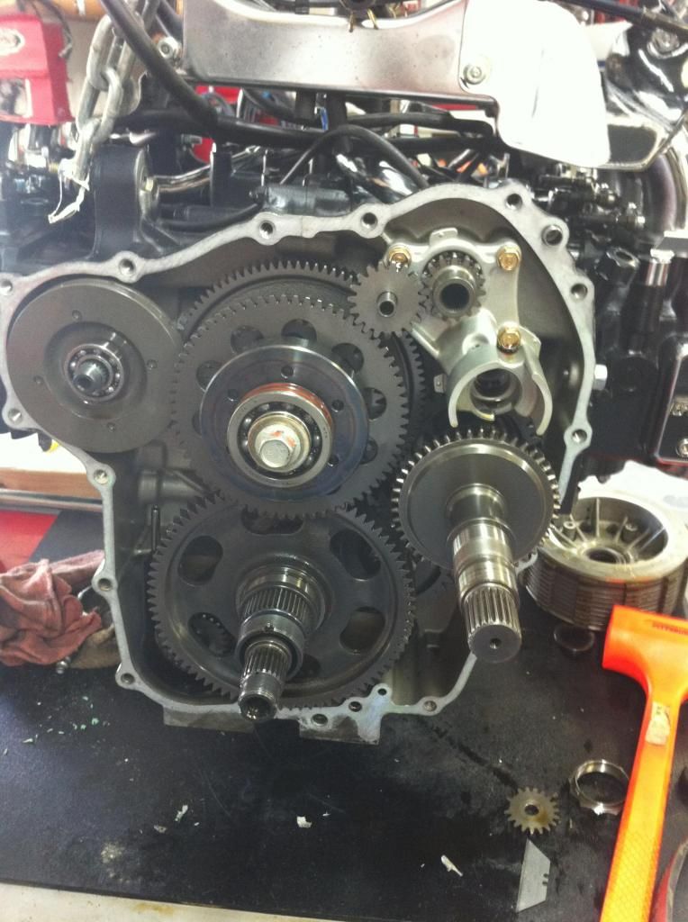

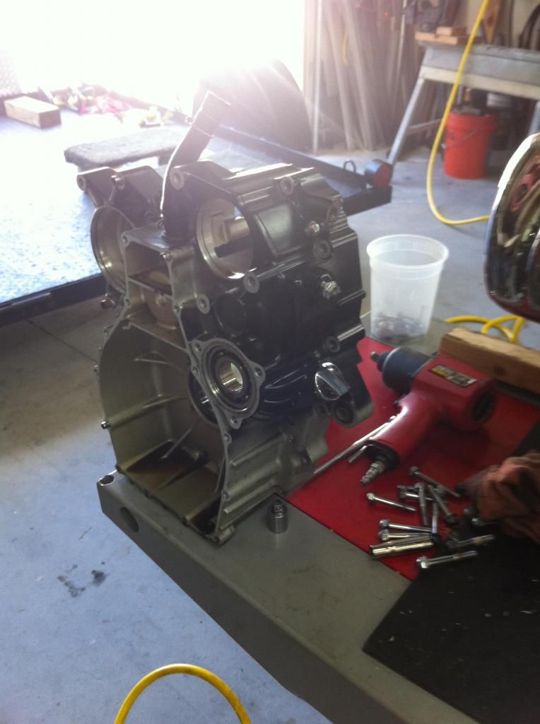

Well guys, just got home from work and here to give an update of the progress.

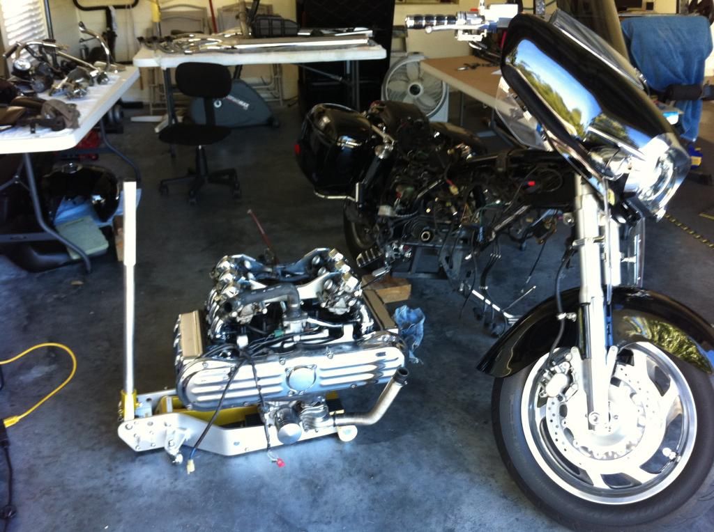

Talked to Jeff K this morning and he stood by his offer to help so I loaded the engine on my trailer and headed over to his house.
Got to his house around 11:15 and met Jeff for the first time.
Many of you said  "listen to Jeff K, he knows what he is talking about" and that is exactly the way it is.
You might want to consider him like a "Valk Wisperer"  Grin, he put his hand over the timing cover and said  that my engine had less than 50k, my Valk now has 40k.
The guy went to town and I felt like I just needed to get out of his way or I would just slow him down.
It was hard for me to stand around and just witness the surgeon at work, that is not my character, but I did manage to at least hold the engine for him a couple of times  Grin
I learned a lot and most important, got to met Jeff and his lovely wife.
It was 1:30 pm and it was all done, just as he had said " a couple of hours" of work.
I know many of you already know this but let me say this:
Jeff is a class act, he offered to help a complete stranger and opened the doors of his shop on a Saturday to help out a fellow Valk rider.
THANK YOU JEFF.
Hope I can pay it forward int he near future.
Here is a couple of pics I managed to take of the engine on the middle of the operation.

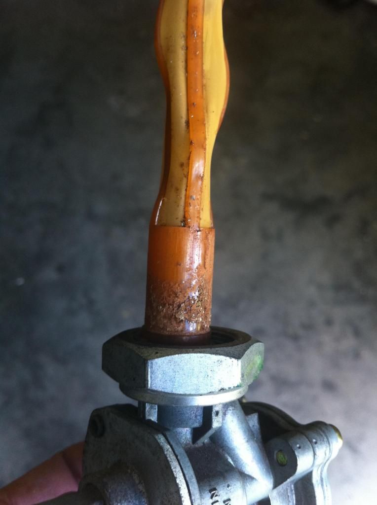

Here is some information on what I found as repairs were being done, but it is important to give a little background on the bike:
I bought it a year ago from an auction company, it was running and needed some cosmetic repairs.
PO had laid it down and my Ins. Co. had written it off, I took a chance and bought it even tough I was completely new to the Valk world.
Seemed to me that it was running ok but it did have a little miss at idle.
One of the first thing that I did was to get new tires and check and service the rear splines.

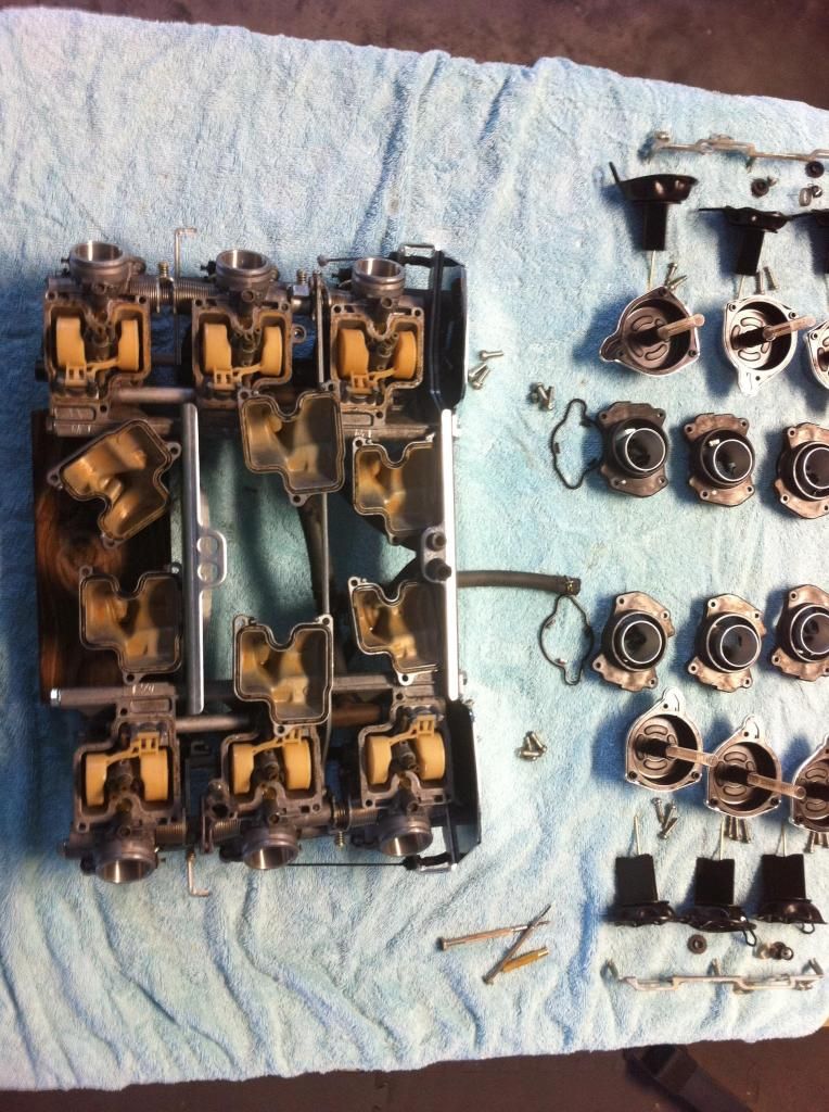

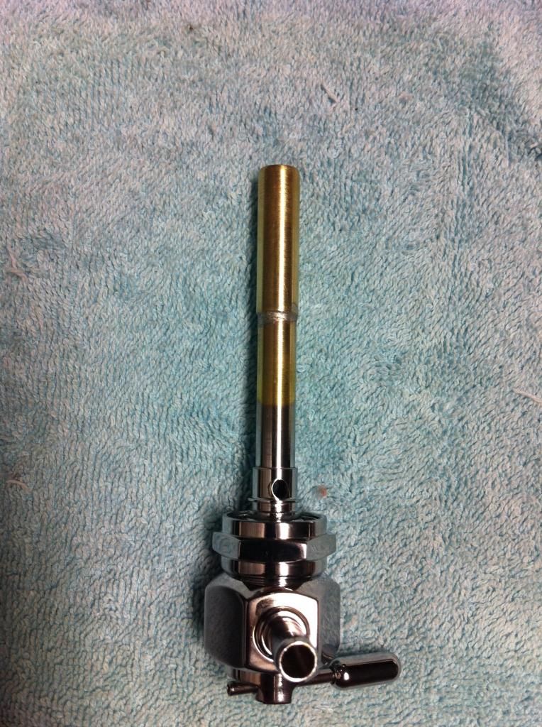

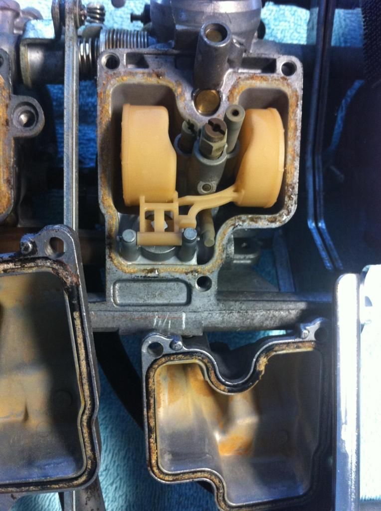

I rebuilt the crabs, got a Pingle and Golan in line fuel filter but I was not prepared to find that the OEM Petcock was clogged with crud and dirt, never taught that a gas tank could be that filthy.

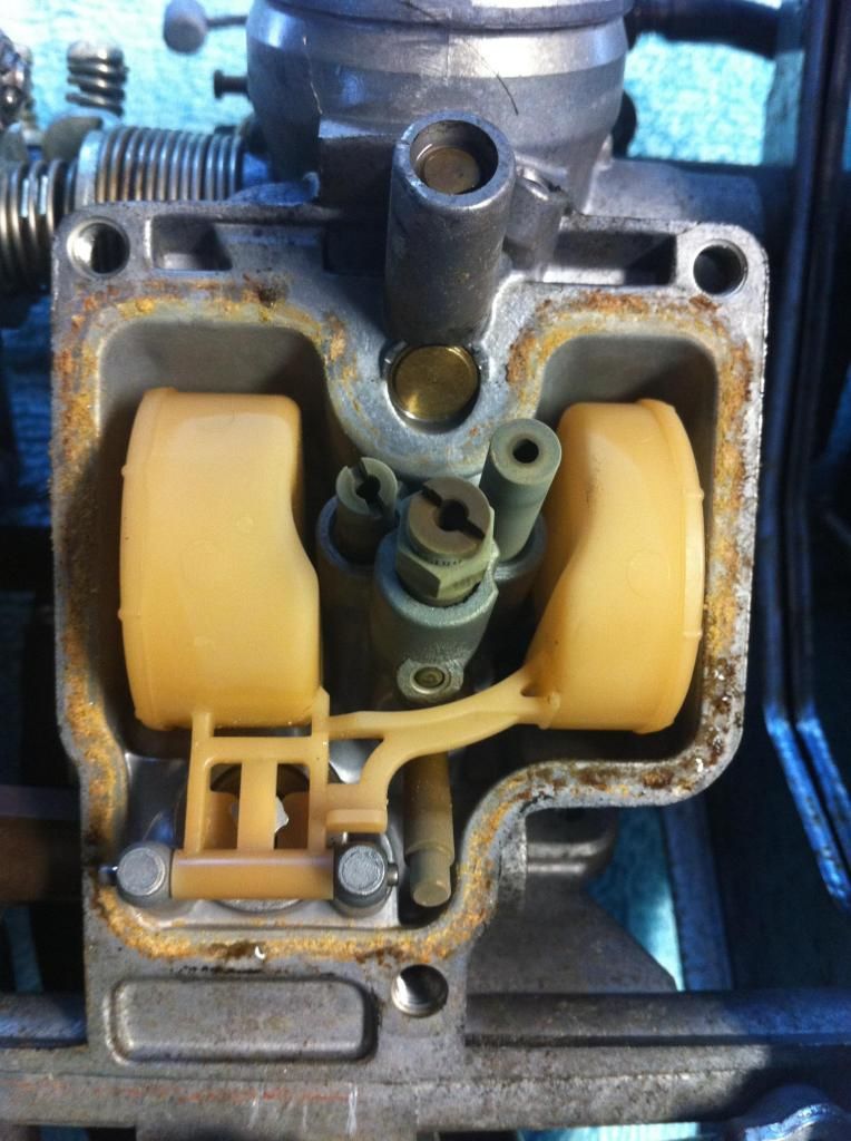

So there was the cause of the Hydrolock, all that dirt went through the fuel system and caused the failure of the petcock and float valves.

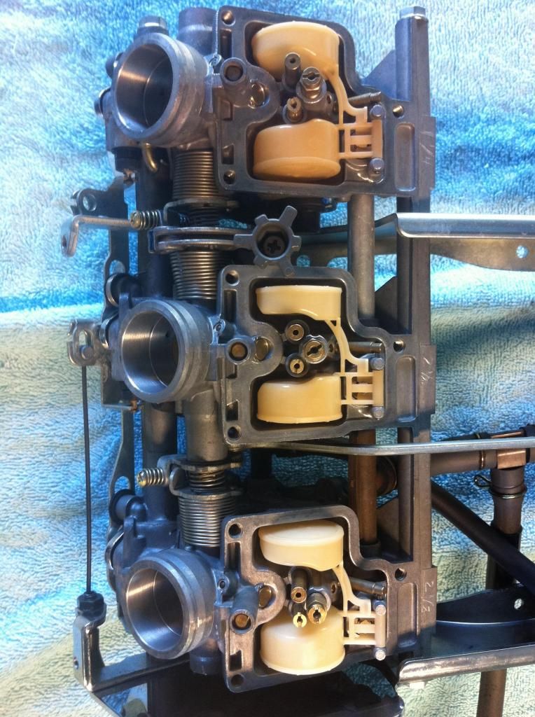

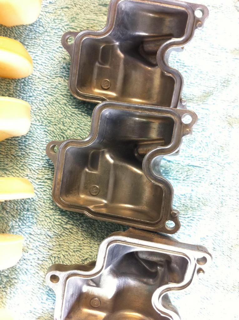

This is what the carbs looked like when I first opened them.

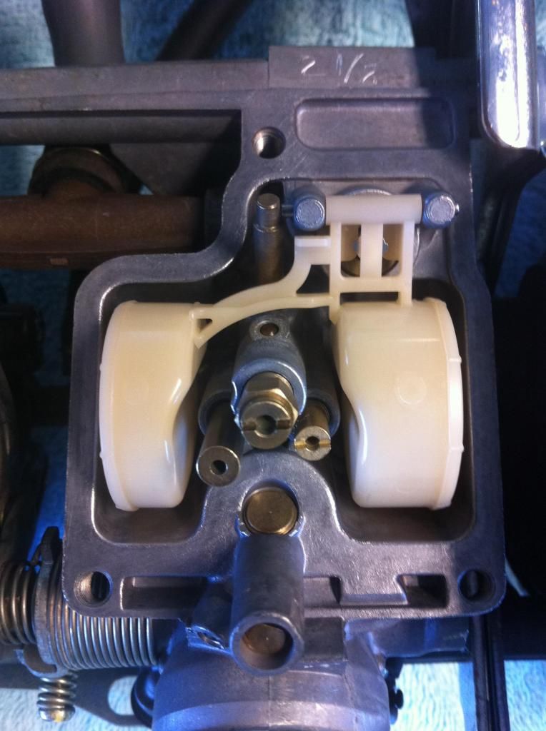

This is how they turned out with new 38 slow jets and new float valves.
This is what I found when the petcock came off
This is the new Pingle with an extended pick up

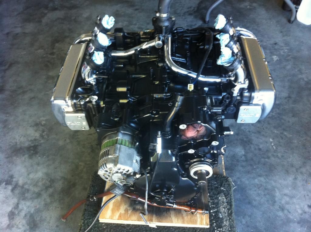

Motor ready to go back in
