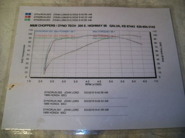

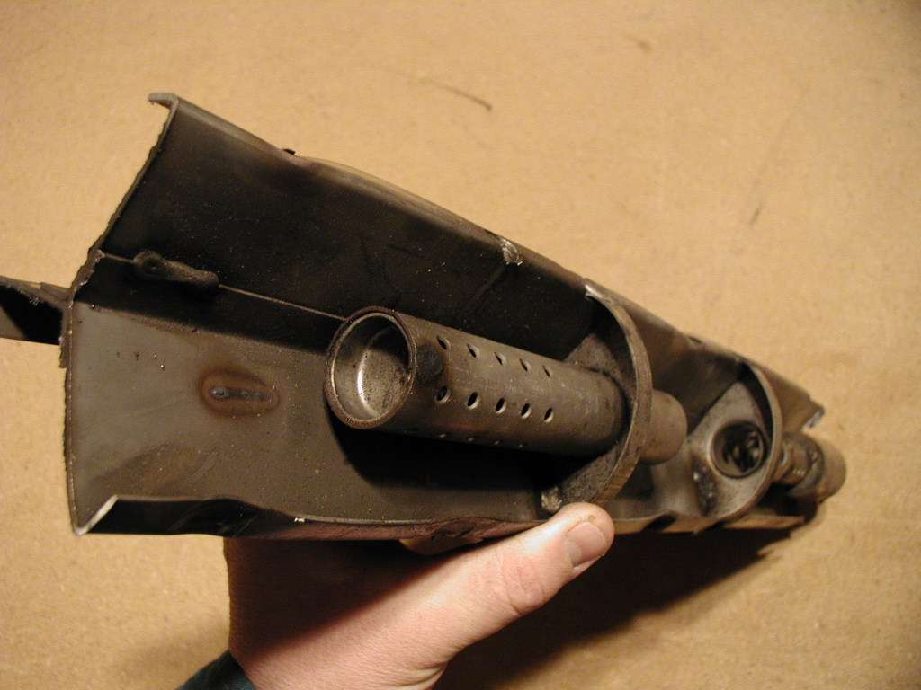

Posts: 5196
« Reply #21 on: January 30, 2014, 08:22:01 AM »
In reference to Ricky D's comment, wrong.  Bolt on a set of Super Trapps and tell me you didnt gain horsepower.
Yep.  Ditto on that.  Ricky D is wrong.  To be polite.  All 6-2 exhausts that I know of deliver more power than the stock 6-6, and significantly more than Cobras if they weren't rejetted to recover the loss of them making the bike too lean.  Including my pipes.  The majority of the improvement over stock pipes comes from recovering the power wasted pushing against baffles inside the stock exhaust. Improvement averages around 8 ponies, and that is SIGNIFICANT as it is all delivered to the back wheel since all the parasitic internal drag (water pump, alternator, other internal friction)  is taken off the top - extra power is all delivered, it's not a fraction of the total. Most if not all 6-2 exhausts are straight-through, or have much less backpressure w/o all the baffles the stock system has.  The other power improvement comes from "scavenging" of the many-into-one configuration, not a factor with 6-6 exhausts but delivered by the new config - and all sport and racing bikes (with many-into-one pipes) I know of.
Yeah I'm sure the mis-info will be repeated to deny this.  Not only does this explanation make sense, but it's supported by butt-dyno feedback from over a thousand customers I've built exhausts for since 1999.  And ACTUAL dynos as well.  Add to that the convenience of being able to change the sound delivered, starting with the pleasing deep rumble of glasspacks, then plug in Trombones which simulate the straight pipe sound of the Cobras, or go the other way and plug in silencers to simulate the volume of stock pipes.
Then add the BIG CHROME CUSTOM look of FIVE INCH stacks that run cool - no boot melting, add a crossover to make more torque (TBR used to make a crossover exhaust but quit making pipes for the Valk around 2003), or add Organ Pipes for another custom look.
Here's an old pic I took some years ago of the Valkyrie OEM baffles - the exhaust is PUSHED through all those tiny holes.  That takes energy which is then not available to push you down the road.

« Reply #30 on: February 02, 2014, 04:50:08 AM »
Thinking that you can add a set of exhaust pipes to the Valkyrie and gain horsepower is folly.
There are no pipes presently available that will give a horsepower boost to the Valkyrie.
If one were to make a claim as such, then the simple truth would be to supply a before and
after dynamometer run to substantiate the claim.  You will find none!
Although there are some, I am sure, that will still make the increased horsepower claim.
Truck stacks open 96 HP, with grumpy's tips 99 HP
The ball is back in your court, RickyD. Just by taking Cobras back off and putting stock pipes on...or  putting Mark Tobias's converted pipes on would be a HP boost, no?
VRCC #10177
VRCCDS #239
