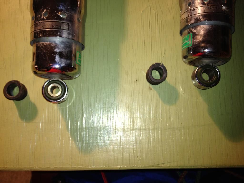

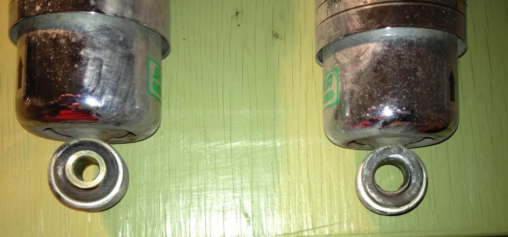

When I had my shocks off to lube the rear end back in May or June, I saw that the lower shock bushings were looking tired.  Since then, I've noticed a creak when the rear shocks are compressed, like when entering a driveway, so I thought maybe the bushings were worn through, permitting metal on metal wear.  I ordered the green VTX shock bushings that I currently use st the top of the shocks, but when I pulled the old bushings out, I found that while needing replacing, they weren't worn through.  I haven't ridden Gryphon since, but I suspect I'll have to search further to find the source of the creak.
In any case, I took a few photos for the sake of those who like to see pics before they proceed to work on their own bike.  I pressed the old parts out using my woodworker's bench vise and a couple of appropriately-sized sockets.  Sockets were not required to reassemble with new bushings, but I did apply some spray silicone lube before using the vise.
