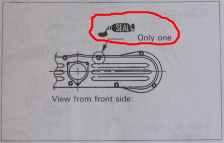

Okay, hypothetically, if I were going to change my timing belts, you're suppose to apply sealant to one of the bolts, per manual. When I go to the store, there seems to be a number of different types of *sealants* on the same rack. Which kind sealant is suppose to be used?
I didn't check my manuals, so take this with a grain of salt.  Any "sealant" on bolts would be Loctite 242 aka "blue thread locker".  It's been awhile since I changed my belts but I'm sure I used that.  DON'T USE RED.

The sealant on the single bolt on the cover is any gasket type sealant.  I used permatex liquid gasket sealant on that bolt at reinstallation.  No thread locker required unless you want to for piece of mind.

Paladin528, this in the manual .....
*Btw, why the sealant on this particular bolt? (MarkT, thanks just the same.)

yeah thats why I used the permatex.  It is an oil safe sealant and works just fine.  It is also the sealant used on the crank case so why not

Sealant because that bolt goes into the water jacket or oil port. I recall it's water.
Posts: 14916
« Reply #24 on: July 29, 2015, 01:36:18 PM »
I seal one bolt, but its not that one.  I have my own theory on it

Well, I would have used silicone sealant by mistake on that bolt instead of gasket sealant. Never gotten the silicone off. Do you have a link to a write-up with pics? Or some YouTube videos. Those would be better forms of encouragement.
Okay, Chrisj, I'll pick you a bushel of maui guavas & Fedex them to you ..... which bolt & why?
Why bother to use sealant on one bolt? I have work on so many Valkyries, I have not see one I mean once that has wet on the end of bolt and is still dry.
After I put it back on and I don't use sealant at all.
There are few that was stuck and broke it, I often wonder if that has been sealed or maybe someone put  loc-lite on thread? Or maybe it's just corrosive? Yes I do see white on the bolt so it must have some wet got in there but all other bolt didn't? Maybe there's pin hole from outside engine on top? I should look at that when I get home in sept and I'll heck the engine on my cart and see.
