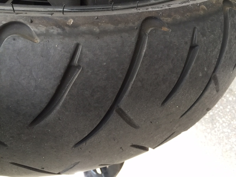

boy do the stock tires SUCK!!!!!!!!!!
I have almost 3k on the bike now...and I've noticed how the bike doesn't handle quite as well when I first got it...
An inspection of the rear tire shows it's already lost enough of it's radius to hinder smooth transitions....Mike old bike with it's Metzlers had none of these problems man....
Honda should be ashamed of themselves for equipping a bike with such crap tires with no real course to get new ones of better quality that fit...

It's...not a dead horse.  Everyone just has to understand what they are dealing with.
The stock Dunlops have a very 'triangulated' profile; this profile increases handling lightness and speed of reaction.  The best way to think about it is that the tires are on a bit of a "tiptoe", using a smaller contact patch to rotate around such at a faster rate.  The negative is tire wear: as the 'tiptoe' of the peaked center wears down, the wear as a greater effect on handling and tread life.  You are perceptive enough to notice the change in handling: as the tire becomes more rounded, the steering speed will slow down and effort increase.
This is expected with triangulated-profile tires, and common on all bikes that use the profile (and there are many, please don't think otherwise).  Supersports commonly use triangulated profile tires...and that's why, in reviews, they mention frequent tire changes, they are all too common for that breed.
The only thing you can do is watch the tire pressure.  Remember that recommended pressure is a guideline - if you are personally heavy, raise your starting pressures.  If you are hitting the curves hard, try lowering from whatever pressure you decided upon by a few pounds, it will bring more rubber in contact with the roadway.

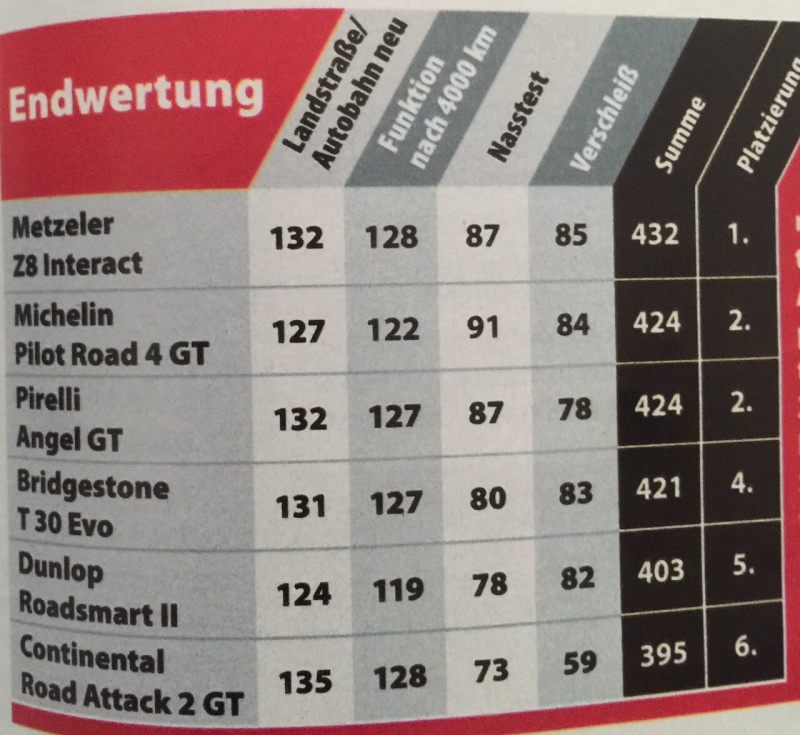

I've already said that I hate my Dunlop OEM rear tire because it's so slippery but there's no urge to change it, with 24,000 km/15,000 miles today.
Motorrad has given the results for his road tires test 2015 and it goes like this :
Road/Road after 4000 km/Rain/ longevity/Total points/Ranking
« Last Edit: August 17, 2015, 11:30:53 AM by ledany » Logged

Wow ledany.  My rear tire looks like yours and I have about 4500 miles on it.  I;ve been running stock tire pressures and due to some recent sliding, I have reduced pressures 3 or 4 lbs respectively.  I don't want to start a debate here about handling or tires, but I can honestly say My 2008 BMW K1200GT would handle turns like a crotch rocket and never did I worry about traction.  It didn't have the torque of the Valkyrie, but it was double digit speed fast.  I accept the Valkyrie for what it is, and don't consider mine a well handling motorcycle.  It will however, probably do better than most american cruisers in the twisties.  However, I know its parameters and do not try to take on my buddies BMW R1200RT in the twisties.  Despite what I said, I do like the bike and find that I see more with relaxed driving.
