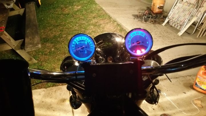

It's a little after 2:00 am why aren't honda parts departments open?  It all started when I bought my bike and went for my first evening ride.  I noticed my backlight was out on my tach. Well I finally decided to fix it today. Normally not a big deal, It's not like you need to pull the tank to replace a tach light.  But my speakers are mounted to my windshield and the wiring is integral to the speaker housing and run under the tank to the radio under the seat. No wonder it took me almost 5 months to replace a bulb.
My day started around noon when my sister dropped off my 12 year old nephew, Caleb for me to physically and mentally abuse (She may have said "keep out of trouble") since he has been misbehaving (She may have said "being a little asshole") at home. I decided that was best done today by swapping out my rear fender bib for the pillion seat and feeling some wind while we ran some errands. When we got back I decided since I have a helper today that needs to be put to work he can fetch tools since I'm too lazy to walk 15 feet from the back porch to my toolbox in the basement.
 All was going well until I found out the only bulb I had that fit the socket was a 5 watt bulb, I installed it anyway and checked everything out before reassembly. It was much brighter than the speedo light, it put off much more heat also. No go, not going to melt my tach housing with that bulb and I wasn't fond of the different brightness on the gauges but by this time it was already 11:00pm. Not to worry AutoZone is open till midnight and it's only 20 minutes away.  Of course, they only have the same bulb I already had at home. I did find some led bulbs that are 0.7 watts, however, they only had one white, one red, but there were two blue. SOLD!

I like the blue lights mark, be interesting to see how you like them for nighttime riding.
I just desmogged mine and added a Dan Marc too, I also modified the OEM petcock from vaccum to manual valve, dead easy to do. So far so good!!
I thought about modifying the petcock as it was only the vacuum diapgragm that was bad, not the fuel but i never turn it off and know that I wont remember. One more reason to use the dan marc as backup. Im eager to see if they're annoyingly bright at night. It seems as though they may be. However i always felt they were a bit dim before. Gotta get my ass in the saddle and give a review after a good ride at night. Gotta let the back mend a bit first though.

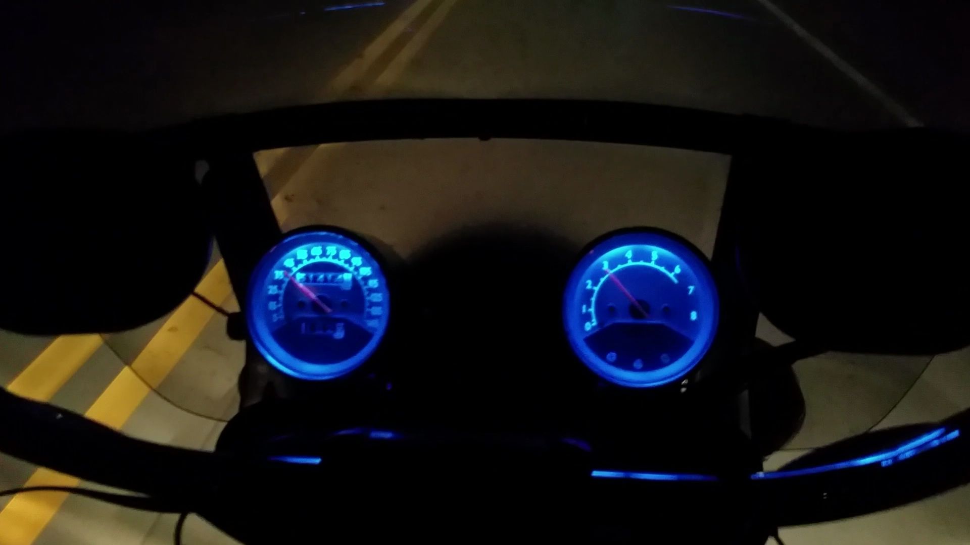

UPDATE:  I went for a short ride today, heavy cloud cover but still daylight the gauges weren't lit up like they would be at night but the light is bright enough that the blue light was illuminating the numbers and they appeared blue instead of the normal black. I think the visibility issue at dusk is solved. I will update next ride I get when dark. I also rotated my bars down 1 notch while I was working on it to see if I could lessen the reach to get to them. They're going back up where they were. Going to be looking into some risers as another winter project that wont get done

It's bright but not obnoxiously bright. no worse than the indicator lights in the headlight bucket

UPDATE:  since the petcock repair I'm back to 100+ miles before reserve. 30-32mpg over the last 600 miles.  Not much night riding so i cant say long term but i still dont hate the blue led gauges.
MarkT I've read several of your tech docs over the last year and saw first hand how handy your extra petcock with the belly tank is for lighting charcoal. (Thanks again for dinner)
my intention wasn't to replace with blue leds but was the only option i had at the time. Not as happy as with the stock incandescent bulbs but not completely displeased with them and they cost a pretty penny compared to planning out and purchasing in advance online so i think ill keep them a while longer before making a decision to change to white/clear.

Well since this thread has been resurrected I’ll chime in and give an update. It’s been 2 1/2 years with the sylvania blue led bulbs in the guages. They are still in and working great. If I had to do over again with all the research others have done and issues with some being too bright or dim and color washing out the faces I’m glad I have what I have. It just works. Not too bright and requiring a potentiometer or resistor to dim and still fully legible gauge faces in all conditions especially at dusk.
