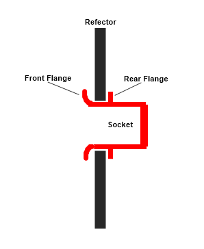

It's difficult to install a generic socket securely onto the parabolic reflector. Oem taillight sockets I've had experience with have round flanges similar to a rivet that keep them in place. This is against the back side of the parabolic reflector. You have to pry up the flange to remove the socket but it's almost impossible to pry it back the other way properly. After prying up the flange, the socket is removed by pushing it through the front of the parabolic reflector. Can't pull it through the back side since there's a front flange that's a tulip or peened over. The back side flange and the front side flange (oem socket) sandwich the socket to the thickness of the reflector. Can't pry up the front flange since that'll scratch up the parabolic reflector's chrome surface. Anyways, the replacement socket has to have a similar flange or facsimile. I used JB weld.

Yeah, came to the same conclusion after looking at all the tail light pieces separately.
Prying that socket out of there without scratching the silvery surface looks hard.
And finding a generic socket to fit that specific hole might get tricky.
I'll spring for the $95 Base Taillight section (33704-MZ0-671). That will let me keep all the  custom stuff but able to use normal bulbs again.
