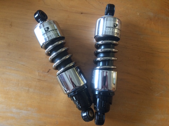

I took this brand new 412HD 11.5" set off the black bike and put on my spare IS stockers.  I cant seem to understand why so many continue to use these when they most certainly will leak sooner or later.  I did like the lowered thing, but I like IS shocks too.
« Last Edit: December 22, 2017, 10:29:42 AM by Chrisj CMA » Logged
Posts: 16821
« Reply #16 on: December 22, 2017, 10:43:15 AM »
Those would be an improvement for someone whose height makes
for tough stops, but other than that an 11 and a half inch set of
412s would pretty much be a downgrade. Try a good pair of 440s
or 444s (or Works Performance). My 440s leaked once and got rebuilt.
Maintenance on good shocks is a very small price to pay.
