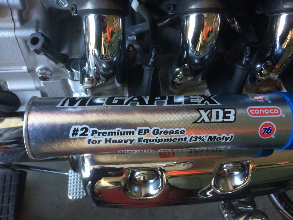

The u-joint splines require multi-purpose grease or 3% moly grease, NOT moly paste.  The shop manual contradicts itself, with page 1-20 indicating moly grease for u-joint splines, but page 12-18 indicating multi-purpose grease for u-joint splines.
For moly grease, I use this:
« Last Edit: December 12, 2018, 07:48:47 AM by Gryphon Rider » Logged

Gryph, I only put a light (finger) coat of moly paste on the splines (I thought that was in the manual, and even got Honda moly paste), then cover it with a spatula full of Belray waterproof grease.  I've never had a problem..... other than throwing excess grease out for a couple rides.
