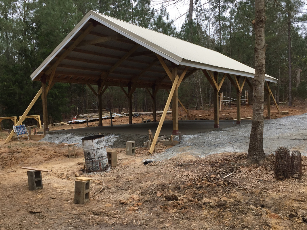

When I retired in 2018, I finally got a chance to finish my workshop (well I had dug the foundation but not put the building up).  I wanted a building I could actually raise a 4x8 sheet of plywood in and found a company, Socket Systems, that had a method that gave me high ceilings and ease of construction.  They are no longer in business but I love the results.
« Last Edit: April 01, 2020, 07:40:41 PM by carolinarider09 » Logged
« Reply #41 on: April 01, 2020, 07:51:02 PM »
Nice roof... and other stuff too...
I'll probably put a v-crimp roof on my little building... the v-crimp
roof on my littler motorcycle shed is over 20 years old without any
rust... it has a decent pitch, like, 8-in-12 I think... I have some less
steep metal roofs that aren't much or any older that are rusty... I
think the good pitch (your building has a good pitch) has something
to do with no rust...

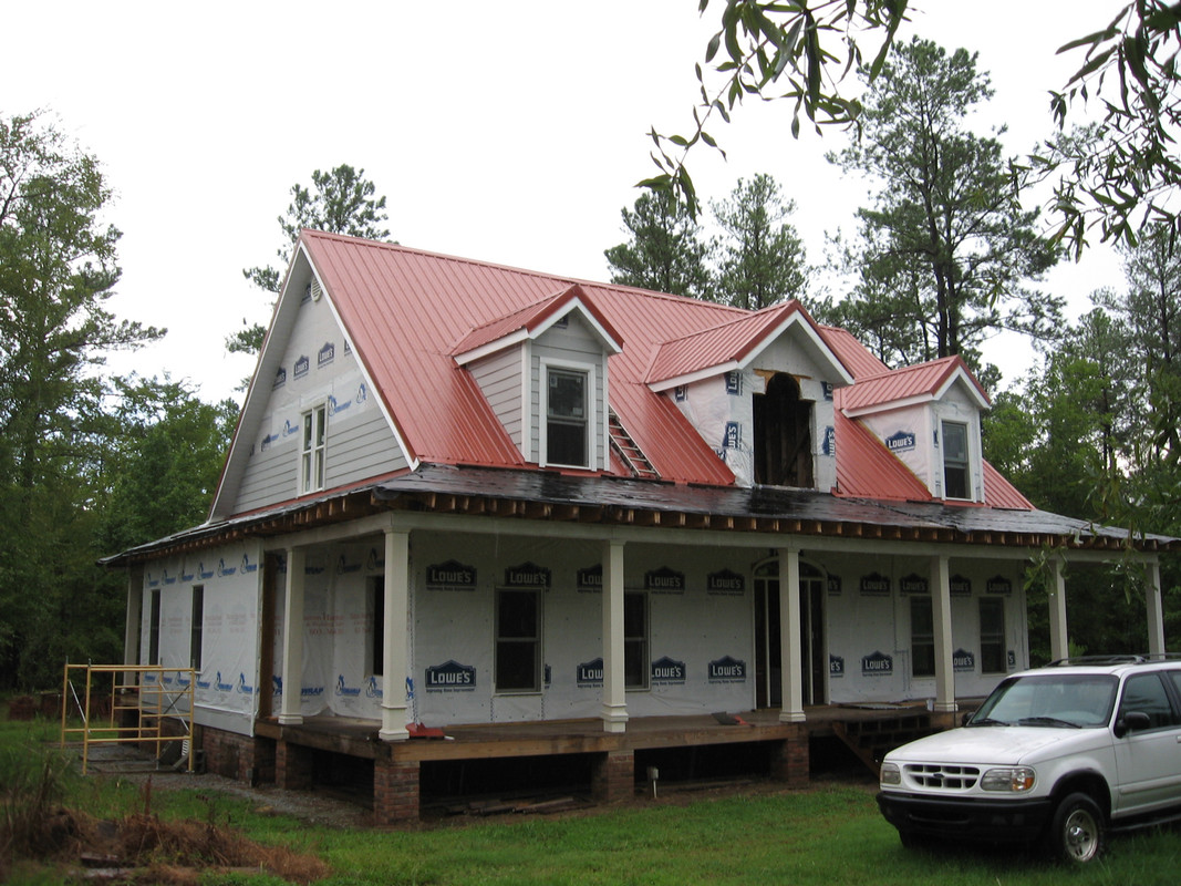

« Reply #42 on: April 01, 2020, 08:02:33 PM »
Mike,
Don't really know the pitch but I have a garage I built the same way thats been in service for 10 plus years as has the house.  Its roofing from Metal Sales.
The only issue I have had is with the house.  The roof is steep and and on the part that faces south I found some screws backing out. I mean they were  actually almost out of the roof.  I assume it was expansion/contraction fro sunlight but.....
As i get older, its harder to get up there and do any maintenance.  But.... I will keep trying.
The picture below is during construction about 10 years ago.  Still have the Explorer  Smiley

The home I am currently constructing has an 8/12 pitch roof, I assure you, your roof is closer to a 12/12 pitch.   I could be wrong but, this I know, no way could I stay on your "metal" roof without being tied on.
The "Spousal Unit" and I seriously considered putting a metal roof on with spray foam insulation.   Just couldn't justify the additional cost.   We went with dimensional shingles (supposedly a 30 year warranty).   The metal roofs we looked at had a 50 year warranty.    I won't be around another 50 years and that company may not be around either.    I doubt the shingles will last that long but, I shouldn't have to put another roof on due to age.   High winds, hail and other acts of Mother Nature not counted.  We're still going with the spray foam insulation, the foam insulation has an immediate payback and will continue to payback as long as it and I are around.
BTW, nice structure/home.   Very attractive.

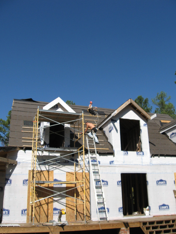

« Reply #45 on: April 05, 2020, 07:51:33 AM »
Thanks.
We used several methods to put up the roof and sheathing.  I did purchase a "harness" for safety reasons and I did use it but, I am sort of ashamed to say, not all the time.  Likewise the scaffold came with some "safety" poles but using those limited the ability to reach some places inside and outside.
We did use spray foam between the roofing rafters and in some exterior walls.  As such, while no vents and returns exist in the attic area, it is normally the same temperature as the upstairs rooms.
The other thing we did was contact a specialist (for lack of a better term) to evaluate the structures enclosures and help make decisions on insulation.  The use of a door blower found several air leaks that were then closed.  We did not elect to activate an outside air supply to the home's interior.  Although the pipes were installed but not actually vented to the outside. It could be with a days work.
His analysis did not support enclosing/sealing the crawl space to make it "controlled" as well.  In hind sight that might have been money well spent.
