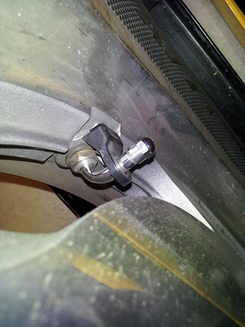

This being my first Honda motorcycle, I have to ask... is this the dishonered OEM valve stem??? I have three wheels, and they all have similar type stems. How do they fail?? Does the rubber seal/boot crack and leak? are they run without the support? do they just blow out??         jus wonderin
Usually they will crack and leak at the rubber base.  Sometimes the failure is abrupt, sometimes more gradual.  Running them without support will accelerate the deterioration. Wriggling them while inserting air will assist them in their failure.
A fresh OEM valve stem from time to time (maybe every third tire change or every tire change depending on how many months a tire lasts for you) will likely avoid the eventual failure.  Carefully supporting the stem when airing (or checking) the tire may avoid eventual failure.
Neither of those measures is needed with the suggested metal stems as their metal tube passes all the way through the rim to the inside.

« Reply #13 on: April 23, 2013, 12:16:19 PM »
This should have been two posts up...
 still wondering if this is the OEM valvestem??

« Reply #18 on: April 24, 2013, 09:21:03 AM »
Looks like OEM to me.
Good Honda tire valve stem.

« Reply #20 on: April 24, 2013, 09:47:13 AM »
This is not OEM and better than OEM IMO.  cooldude

« Reply #22 on: April 24, 2013, 11:55:46 AM »
Clearly an aftermarket stem, but I have never seen anyone use the OE elbow with an aftermarket all-metal stem.
I use these, the elbow is unnecessary and would not fit anyway (they lay flat on the wheel); besides I cut the T's off the wheel to aim mine to the high (right) side.

« Reply #23 on: April 24, 2013, 02:45:41 PM »
Not sure how you can tell that from the pic.
Looks to me like it could be about worn out.

« Reply #25 on: April 24, 2013, 06:42:29 PM »
OK,, I got it, I now see that the metal tube does not extend through the rubber seal,, potential problem area.... I will install some with the nut topside before I hit the road.

I have just purchased another Doran TPMS for the Valk to install while I have her down for body work.   These tire pressure monitoring systems come with metal valve stems.  They have both straight and 90 degree stems included.  I have the ststem on the Wing and really like the peace of mind knowing that my tire pressure is within the parameters I have set, front and back.
So, my $.01783 is that yes, metal stems are superior to the oem stems.

I received the J/W stems and plan to replace my rear OEM stem on Saturday. While the Anchor ones seem to be a Cadillac valve it still tightens from the inside.
