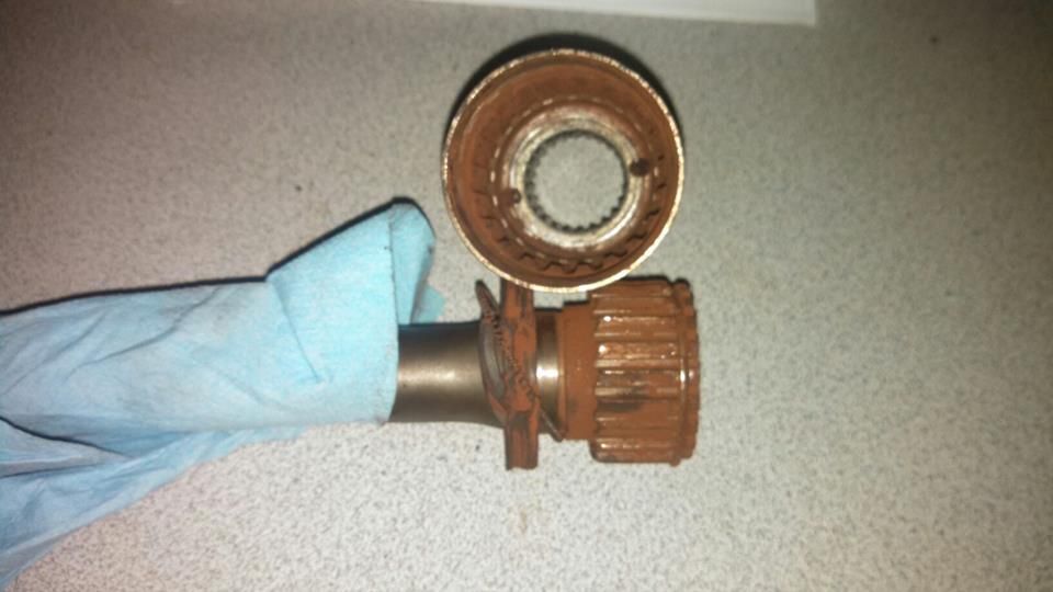

 This is a shot you have all seen too often.
 Looks like someone dropped the shaft when replacing U joint to me. Don't see how the chunk could have been torn back in normal use.

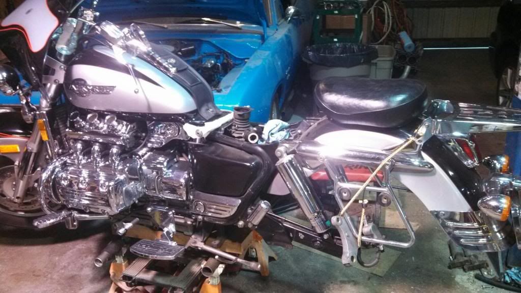

 Tearing her down went quick. It is the EZ part.  Roll Eyes

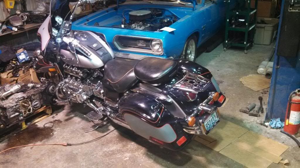

 All the new stuff lubed up and ready to slip in. My son's roommate is rebuilding an engine right now and the shop is a mess as you can see.
 Back together ( and needing a bath) with new to me original unmolested exhaust. Cant see it in this shot. The only thing I can say is a negative is I do hear more engine nose now.  Roll Eyes
