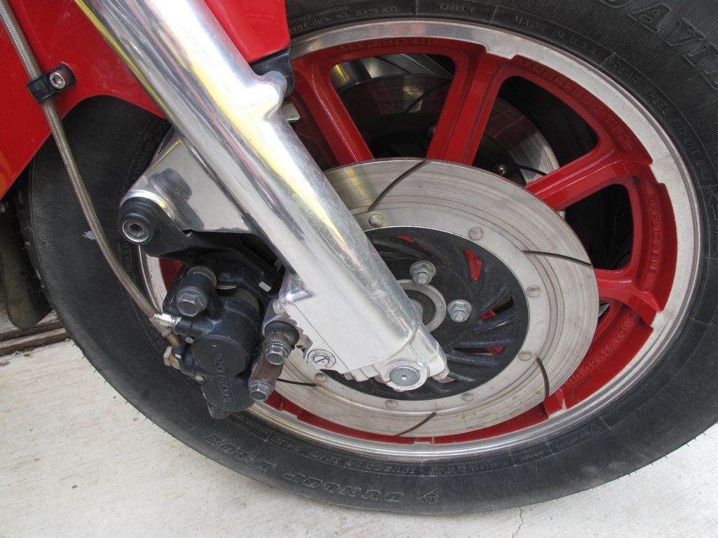

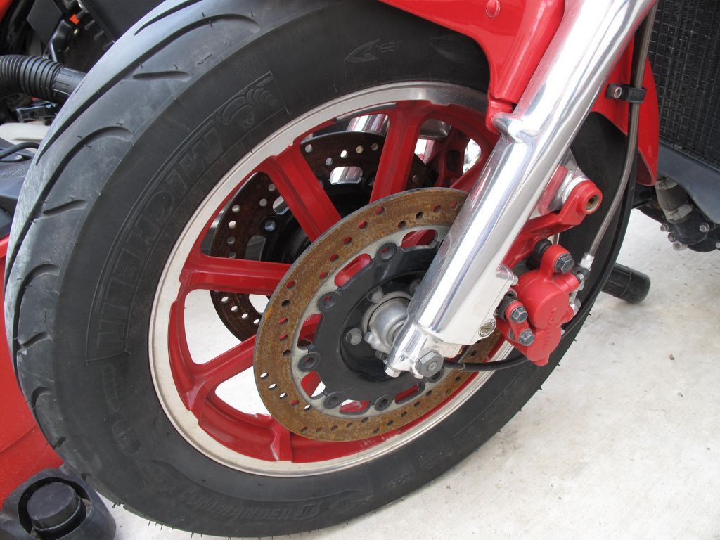

Figured I'd post some pics so folks can see the magnitude of this - at least here around Tucson:
Stock rotor on my GL1200 hack - maybe 40k on the rotor.  Have gone thru three sets of EBC HH pads.
EBC rotor on GL1200 solo - close to 30k on the rotor.  My second set of EBC HH pads.
Note that these bikes have been sitting under a porch since end of last summer. Blew a head gasket on the hack, and am going to just transplant a new-ish engine, have been struggling to fit a set of Motad SS exhausts on the solo; typical coarse Brit workmanship... but I digress...
I would assume that more regular use would lessen the rusting of the steel EBC's.  But as can be seen, the stock ss rotors are almost flawless.  Almost have the solo Wing exhaust re-fabbed, so now I need to sand/de-rust my rotors before I can to a test ride...  Sad
