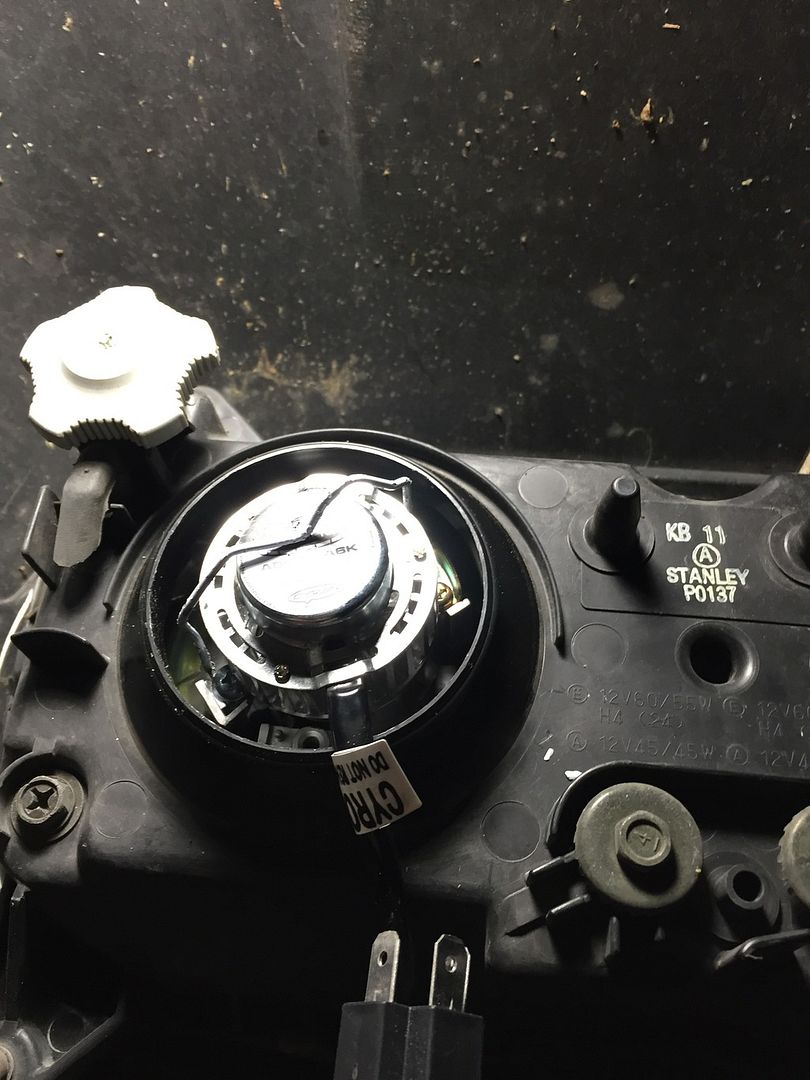

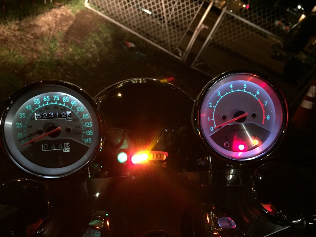

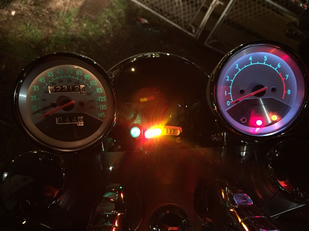

Installed LED headlight. Was a paid cause the wire clips would not work. Had to make new wire spring clips to holt them in.
Need to find someone in Houston area at night with another IS so we can compare.
They are too bright to look at and probably illegal.
That is a fan on the back side that you actually hear when you turn on the key.  The current draw is so low that I am getting 14.2 VDC on my digital volt meter.
Yes the wire did come from a coat hanger.
CRYON is the mfg./distributor
http://www.cyron.com/p-209-headlight-bulb-led-retrofit-kit-motorcycles-abh4k.aspx

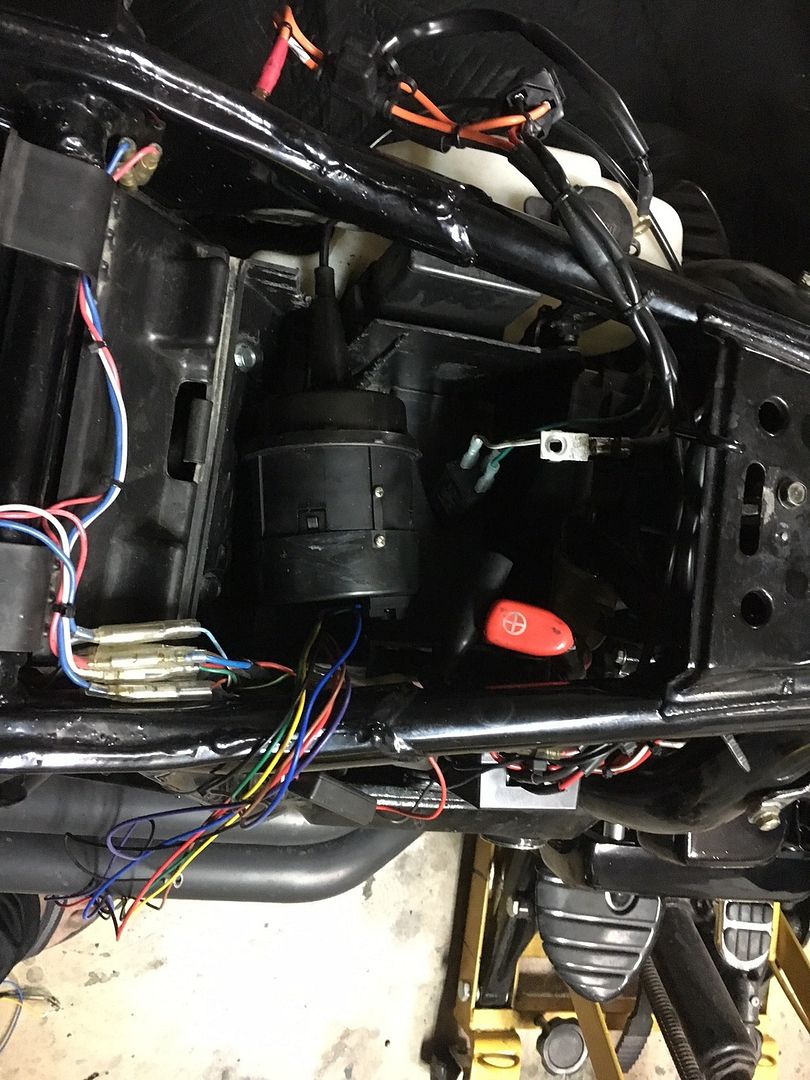

Finish installing an Audiovox Cruise Control on my Hotrod.

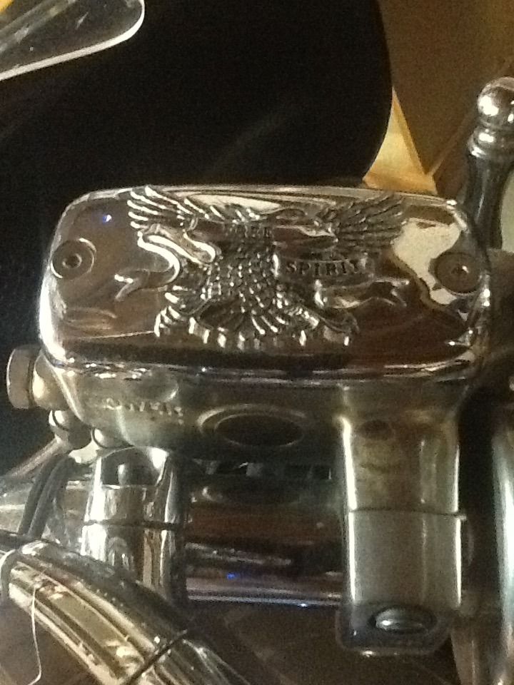

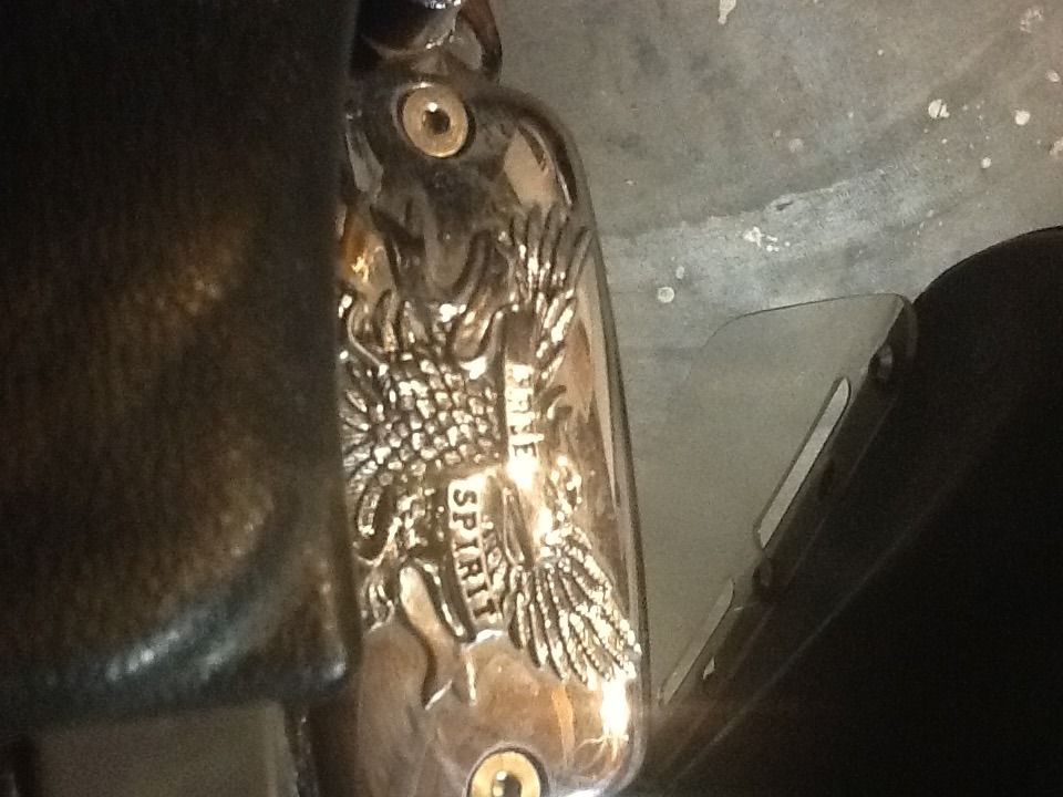

Oh... and I fiddled with my brake master cylinder cover and got it on there straight too...

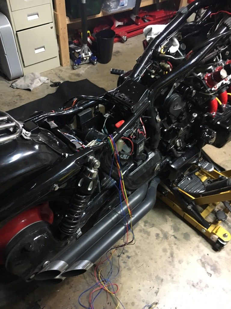

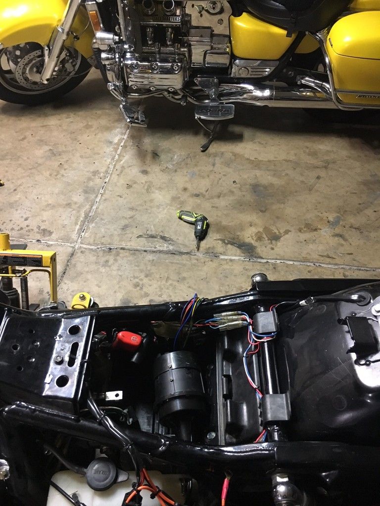

Another day of riding lost to garage time.
Installed the Batwing, took longer than usual due to trying not to scratch up the powder-coating.
Didn't get the Batlashes working yet, I must have bumped something in the light bucket and have no power to them.
The rest of the LED's are working now.
I really like my Mustang bib and really like my filler cover but they wouldn't happily live together, I finally decided to start cutting the bib until I had it trimmed enough to mount the cover over it.
Me like!

Haven't started the bike since May of 2015. Got it fired up this morning, took a while... Noticed the final drive is leaking. Not from the drain, but from the internal seals. Had a small puddle in the rear wheel, and oil is seeping up the outside of the swingarm. Nothing hit my garage floor, though. I guess they dried up/rotted. Who knows, but the seals are shot. I took it out for about 10 miles, got it good and warmed up. Had a chuckle at the difference in performance between the Valkyrie and the new bike. Really made me miss the Valk.
Changed the 2 yr. old oil (probably shouldn't have as it looks like I'll be draining it again before she goes back together), got it jacked up and got the front half of the bike torn down. Upon looking under the bike I was amazed at how bad she's gotten. I rode this bike almost all of the winter of 2014. Had a bad ice storm that year, and the salt they put down really did a number on the bike. Really. I didn't know that when I parked it for the last time before I bought the Wing, and when I realized what I'd done, it was too late. Damage was done. I'm actually ashamed that I let her get this bad. She'll be good as new soon enough, though.
I will say that most of the Honda chrome held up well, with the exception of the heat shields on the exhaust. All the aftermarket stuff is now garbage, including the Progressive 440's. (what a waste). The kickstand mount is pretty bad, some of the clutch cover bolts are worrying me as they're in really, really bad shape. Water pump bolts are also scaring me. I can't see any corrosion/rust on the frame, not yet anyway. Some of the screws on the airbox got it bad... Was developing a pretty bad wobble before I parked it, and with the wheel and fairing off the reason was evident. Steering head bearings are shot. With no weight on the forks it seemed like I could feel every bearing move. Out they come.
Anywho, I'll take care of all of it. Coming apart is easier than going back together, so I may the that guy with a ton of questions soon.
Pictures really don't do justice as to how bad she's gotten, but here's my progress. Next Sunday the back half of the bike comes apart and then I'll be dropping the engine for cleaning/repairing. Once all is cleaned and repaired, parts will go in for powder coating and paint. This will probably take me several months to complete.
It begins.
Running out of room.

Added new master cylinder covers to my Standard
Need new screws...

Looks good.  cooldude I have a suggestion on the screws for your brake and clutch reservoirs. The screws on mine had a slight rusting from being wallowed out slightly with a screwdriver. I replaced them with stainless Allen head screws from Ace Hardware . They look pretty good in my opinion .

Are they countersunk?  Pics please.

yes, I'll go out and get a pic now. I'm not the speediest on this computer stuff, so bear with me.  Smiley
« Reply #197 on: March 02, 2016, 06:39:08 PM »
I`m also not the greatest photographer as you can see. Basically they are a countersunk allen screw the same as the phillips but they are also stainless. I got mine at Ace but I`m sure they are available at other hardware stores.  cooldude

Installed new Cool White LEDs in my speedometer and tachometer.
They're much brighter, and much easier to read at night. I bought several brands, but went with the Cool White bulbs by superbrightleds.com.
  **On the left, original bulb from factory.
  **On the right, part# T10 5-5050SMD Cool White, sold by ARTR  on amazon.com
I didn't like either one of these.
  **On the left, part# WLED-CW5: Cool White, sold by superbrightleds.com
I liked the one on the left, so now both sides have that.
