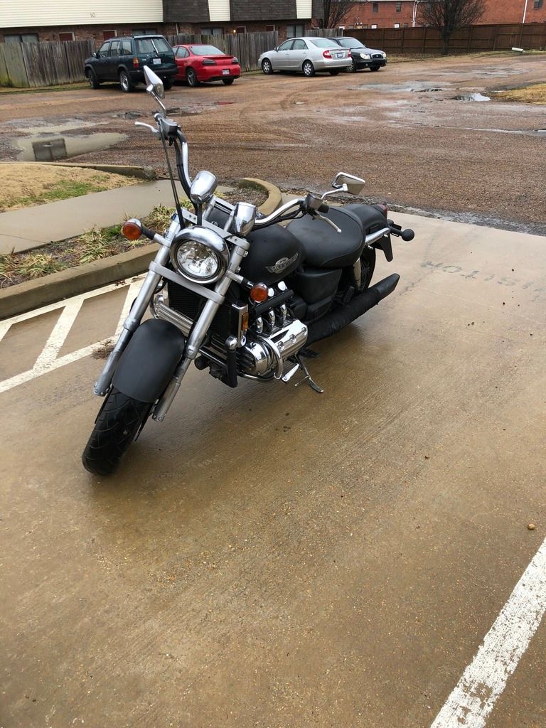

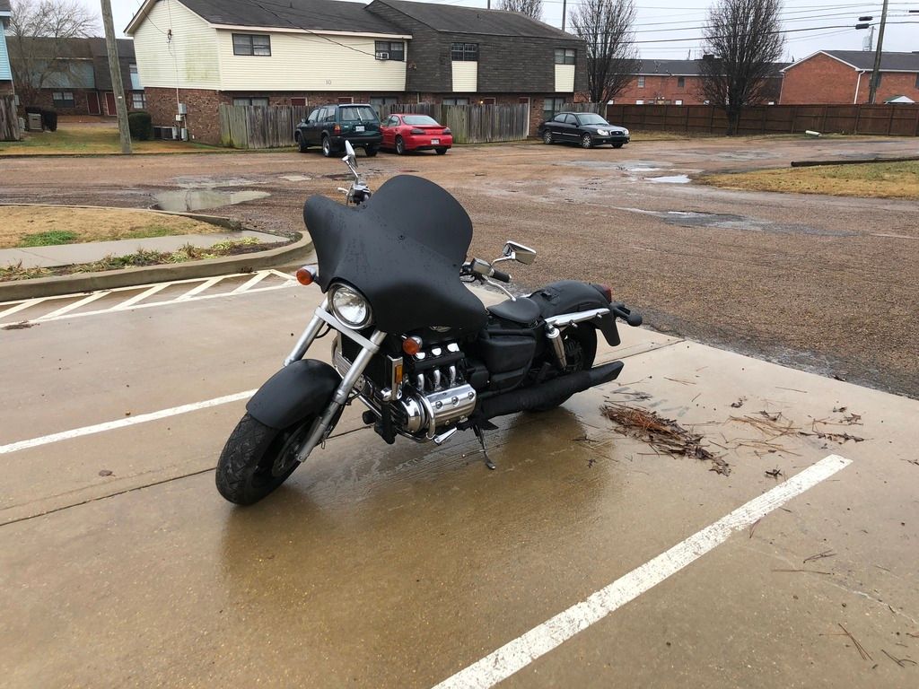

Hey all, new here.

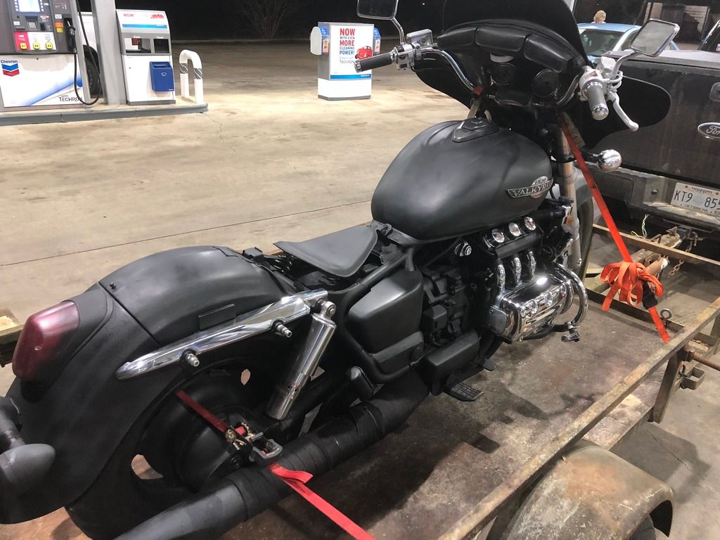

Had a deal I couldn't pass up on a 1998 Valkyrie this week. The second owner of, and the one I bought it off of, had painted it flat black to make it look like Sons of Anarchy... apart from that, it's in great mechanical shape. But for the price I couldn't let it get away. Only 23k miles on it.

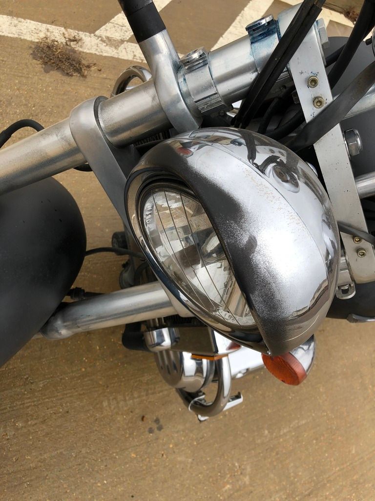

The crappy paint job had lots of overspray on the chrome/plastic (this is just some of the damage):
The first thing I did was take off that seat that was on there and replace it with the factory one, as well as remove the fairing.
Before:
After:
It's been raining here in central Mississippi for the last week, so I haven't had much time outside to get to check her out... but here are some things I noticed:
  • The lock for the seat doesn't work.... not sure how I'm going to get it back off. When I turn the key to the right, nothing happens and the seat is still stuck | Update: Cable wasn't tight enough. Figured out how to get it off

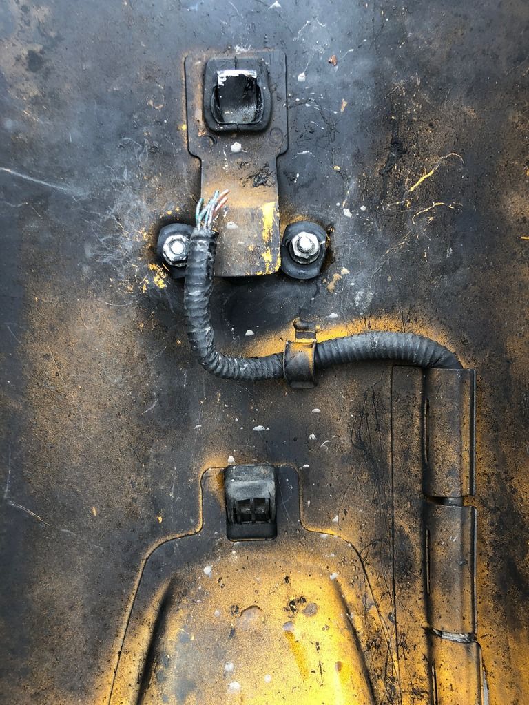

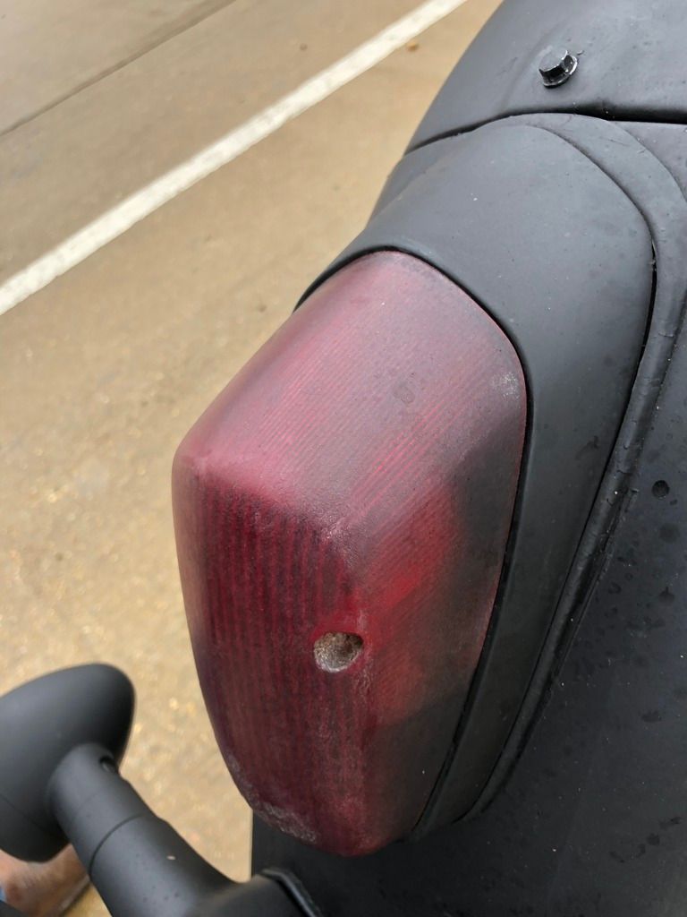

  • Rear turn signals don't work, the wires were never terminated back to them when it was painted | Thanks Sandy for the help here!
  • The speedometer and tachometer are zipped to the handle bars... Would like to get the OEM mounts somehow. Anyone know a part number? http://www.valkyrieforum.com/bbs/index.php/topic,99008.0.html | Update: Thanks again Sandy for the help here
  • The exhaust was also painted with Rustoleum High Temp black paint from a can, then wrapped (poorly)
  • Original Color was Yellow/White
I would like to end up bringing her to somewhat stock. Try and remove as much of this black that I can, eventually getting a paint job too.

Decided to turn this into my build thread. I've got some time this weekend, here is my list of things that need to be fixed:
  • Fix Gauge Lights
  • Remount Tachometer
  • Replace Exhaust Tips
  • Finish Getting Overspray off
  • Replace Taillight Assembly
  • Rebuild Petcock
  • Get rust out of spark plug holes
  • Unclog Drain Holes
  • Clean starter assembly

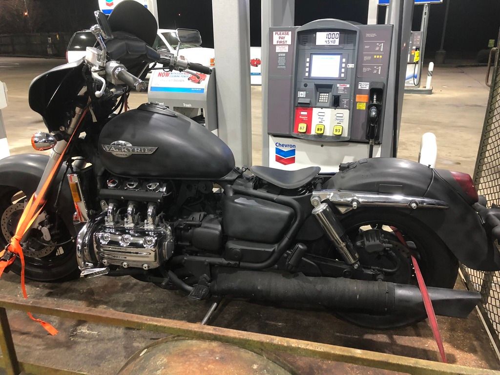

Also took these last weekend:

Welcome. Where you located, profile doesn't say? Little elbow grease will help...How's it run? That many miles not much run time.... Run some good gas through it and dump a half can of Sea Foam or the additive of your choice through it.
If he didn't sand it b4 he rattle canned it you may be able to pull it down and wheel it out? Congrats on the find and rescue of a good bike.
Obviously, you'll have to re-wire or get a new/used harness.

It is, not sure how the connections terminate to the rear turn signals... wanted to do some research before I decided to take it apart. Picture is above... the wires shown are coming from the current harness. I wasn't sure if there was supposed to be any connectors on the ends of them.

« Reply #16 on: January 12, 2018, 07:36:36 AM »
I believe the turn signals have the standard male/female push connectors.
If it were my project, I'd get #6 & 7 new for under $20.00.

Here's a schematic for rear lights.
Thanks! Going to probably pull out the rear end do this tomorrow.

You might try some bronze wool on the headlight bucket overspray.  That stuff works magic on chrome!  Nice find, thanks for giving it another chance!
Jeff
